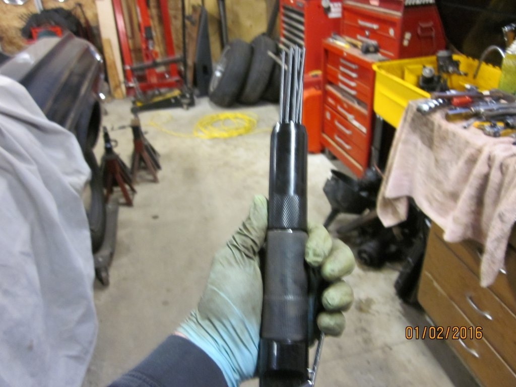

This tool works pretty good at getting all that crud off too. I prefer to consume adult beverages while engaging in this dirty work also! lol
Gleenwood, I have used that very same tool to remove rust on heavy I beams, I guess it also works good on undercoating too....I will keep that in mind next time.

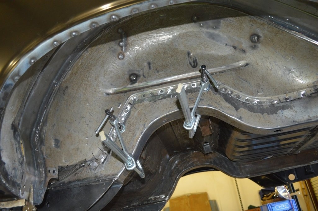

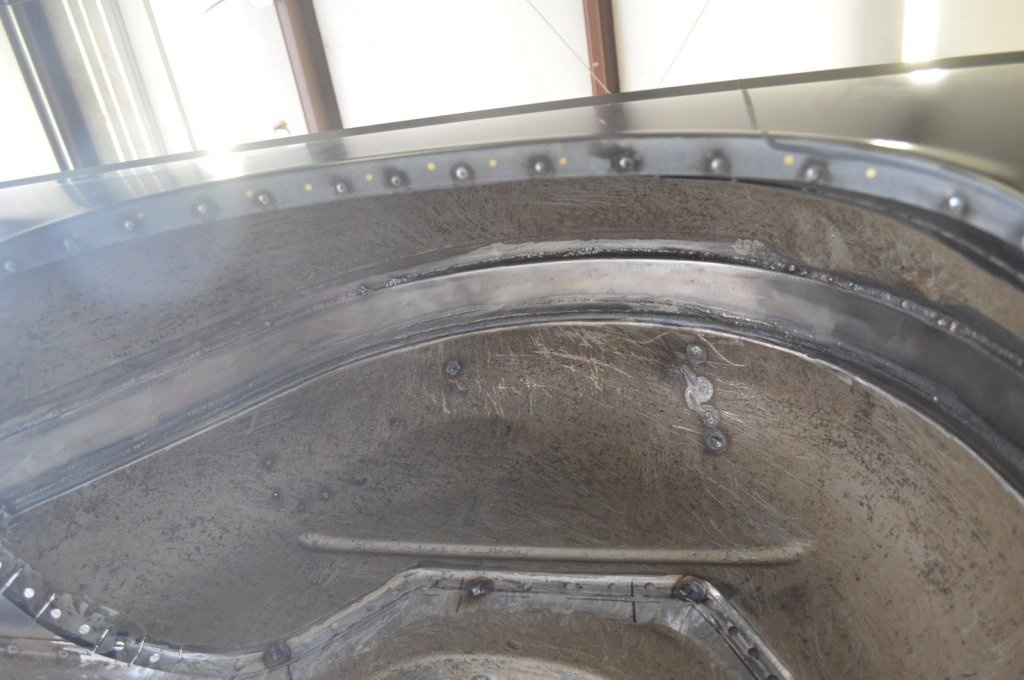

A little update. The left side fender fitted for the last time. Picture:

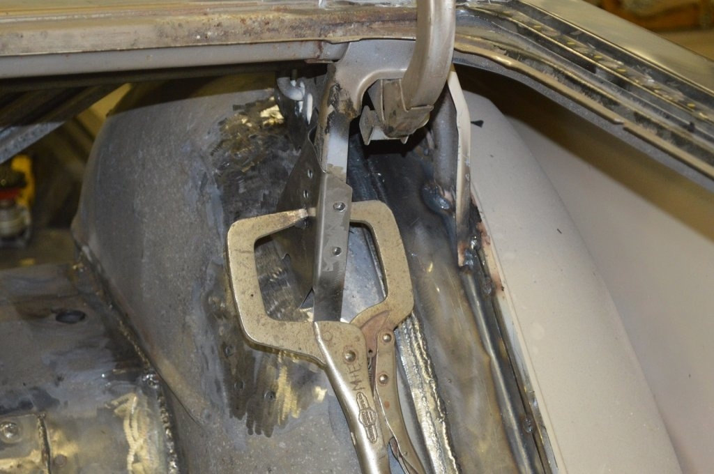

Tacks where made while it was clamped into position.

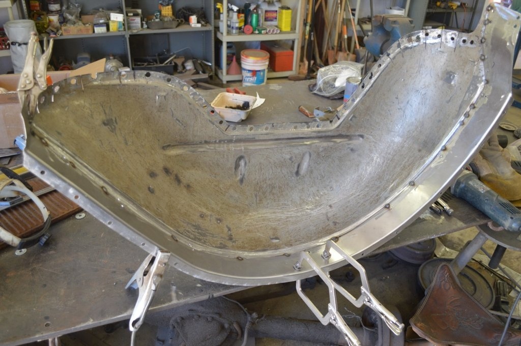

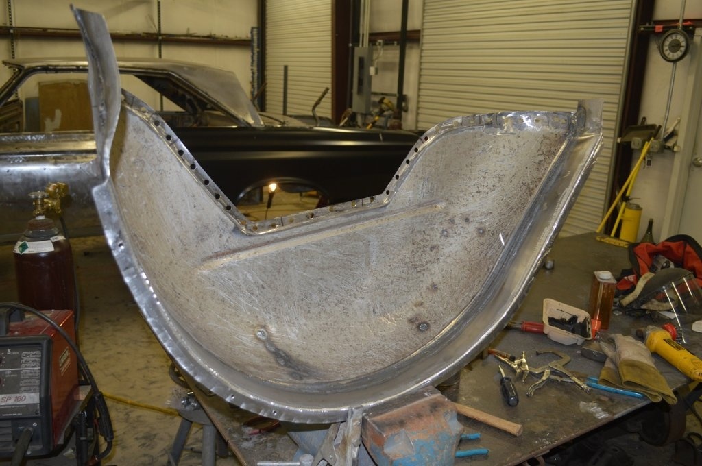

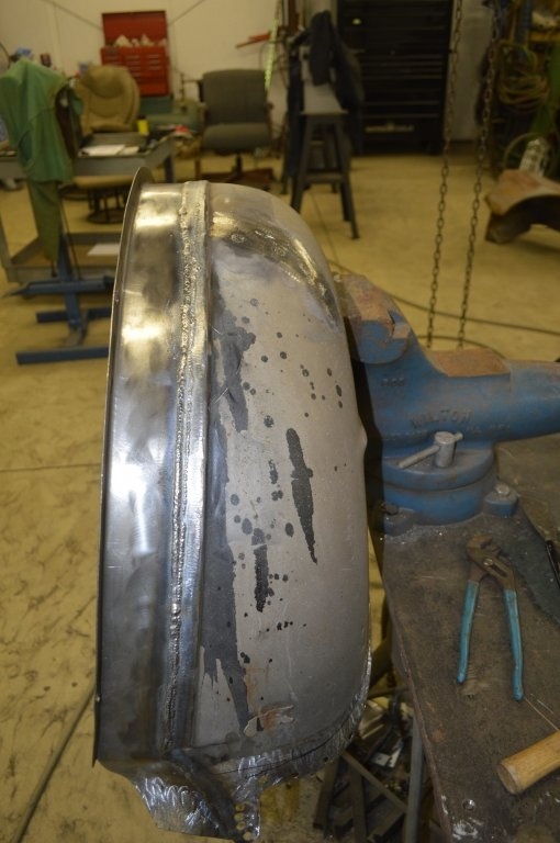

The inner fender well was removed and welded on the bench. Much easier...lol.
Both the inner and outer lap joint was completely welded.
The extended inner fender well clamped into position. It will get tacked in and welded out tomorrow.

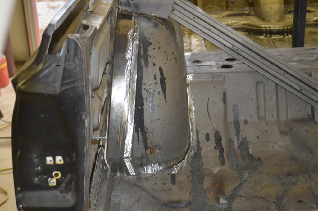

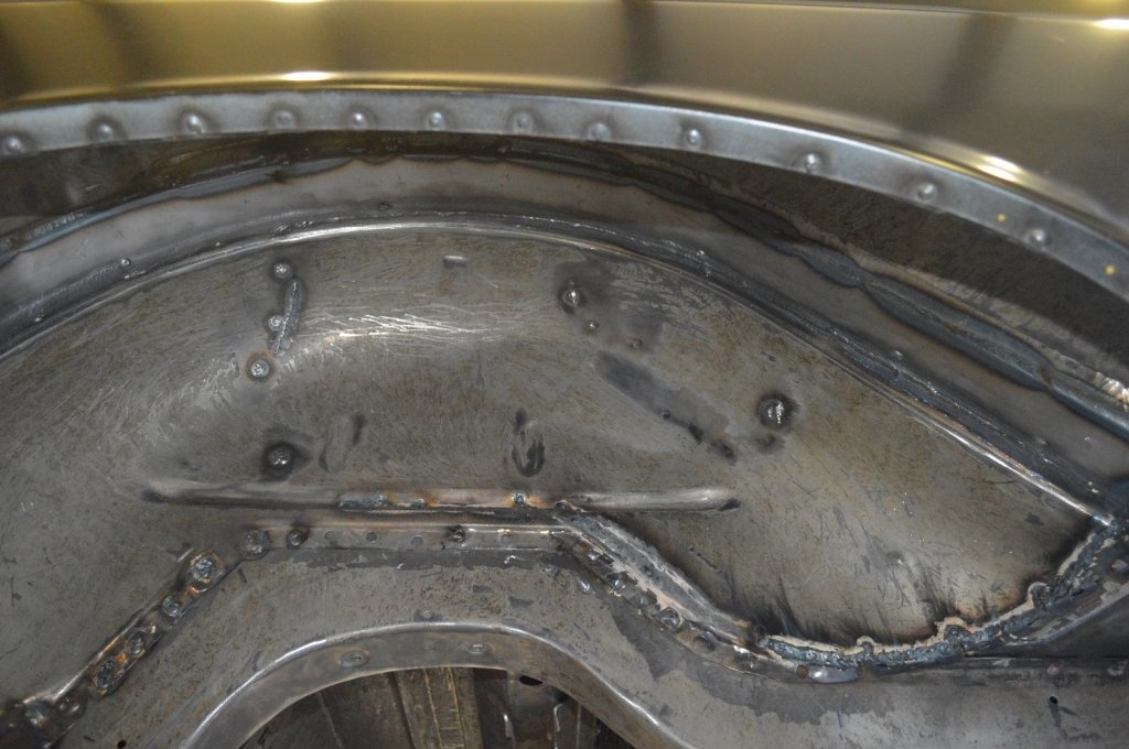

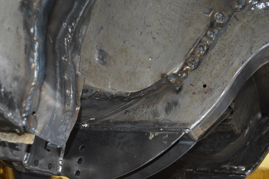

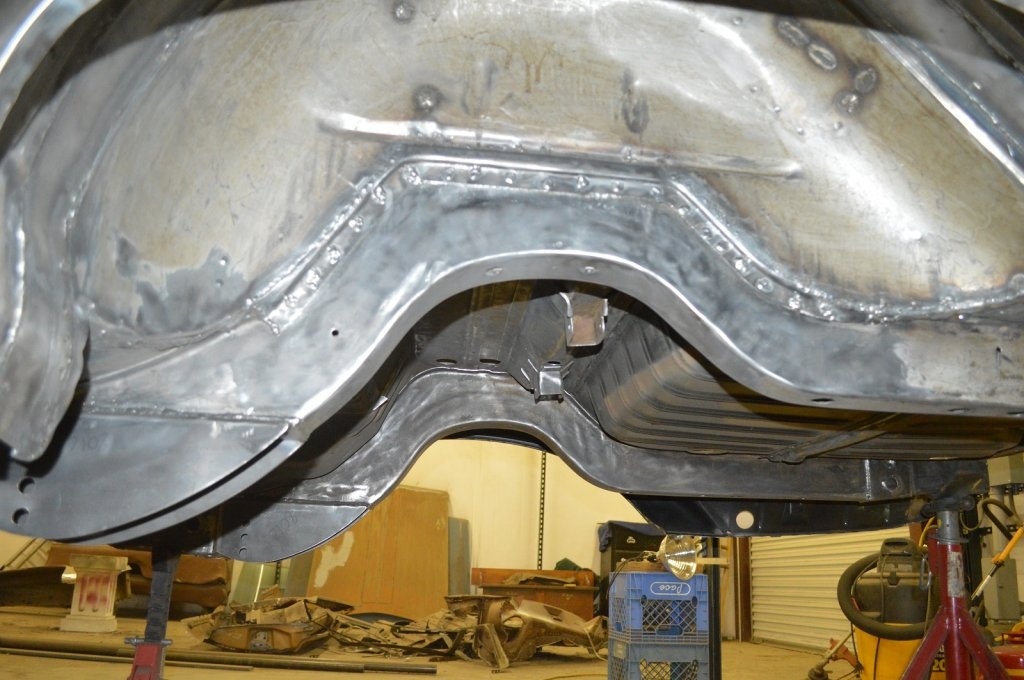

Just a little quickie update. The left mini tub is almost completely welded.
I must have gotten happy while cutting the inner curve out. There was 3/4" gap between the floor board and inner fender well curve. This gap was to wide to weld. To close this gap, short vertical slits where made on the fender that hung below the floor. The sections where bent, using a body hammer, to bottom of the floor board. They will get welded.

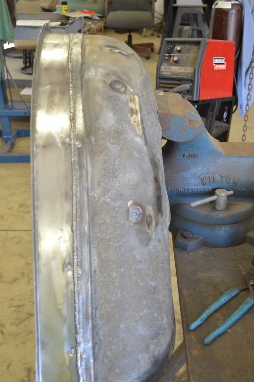

That is about as far as I got with welding the left side mini tub. I stopped working on the 64 due to an old biker buddy had called. His old FL shovel heads gas tank was leaking. A hair line crack had developed on the underside of the tank. The crack was above the oil cross over tube between the heads. The tank was repaired and he is back to scooting around. Needless to say a few beers got consumed in the process......no more work on the car.....lol.

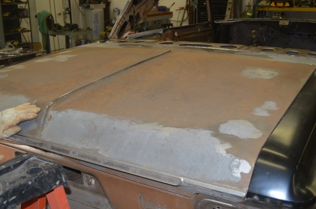

A little update on the build from today:
The right side mini tub has been trimmed, fitted and clamped into position. Pictures:
Tomorrow, I will finish the final adjustments. Make random tacks, pull it all back out and bench weld. Reinstall and begin the tacking in and welding. A milestone will be met, this will finish up the major sheet metal work on the body. Whahooooo.

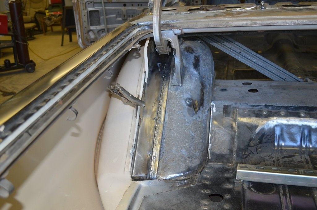

Here is a little update from today.

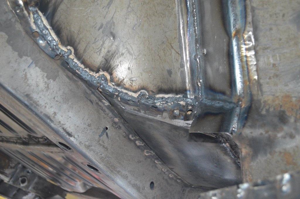

The RH mini tub was tacked while in place and removed to bench weld. Pictures:
It is now installed.

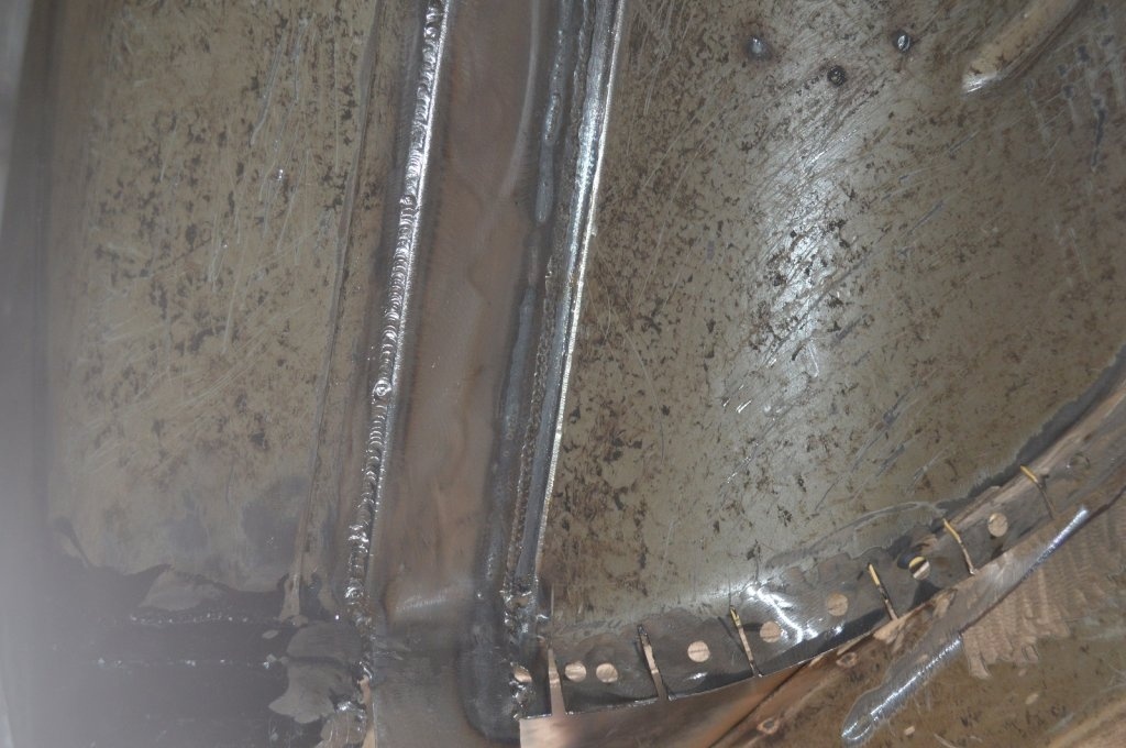

The overhead welding in the fender well is done.
But, there still a lot of work to be done. The vertical slits will need to be bent over to the bottom of the floor pan and welded to do to finish the RH mini tub. That will be next weekends project.

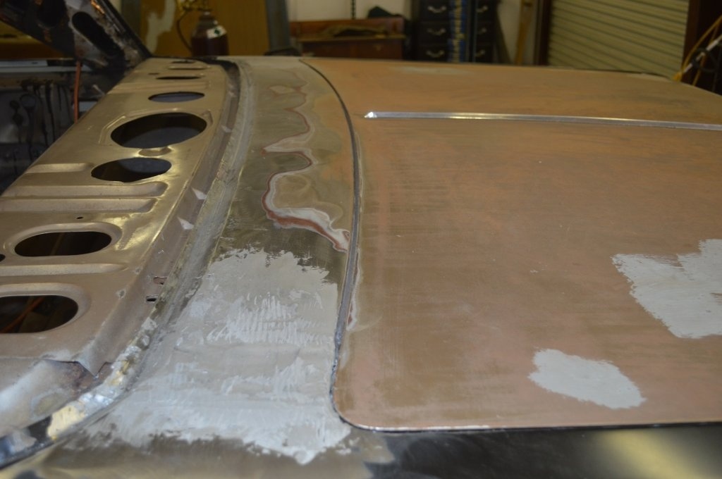

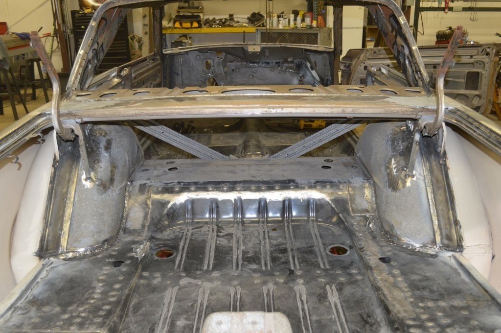

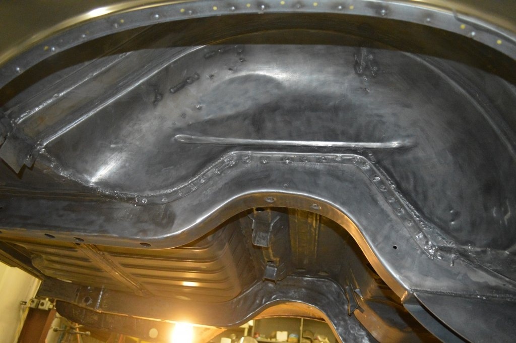

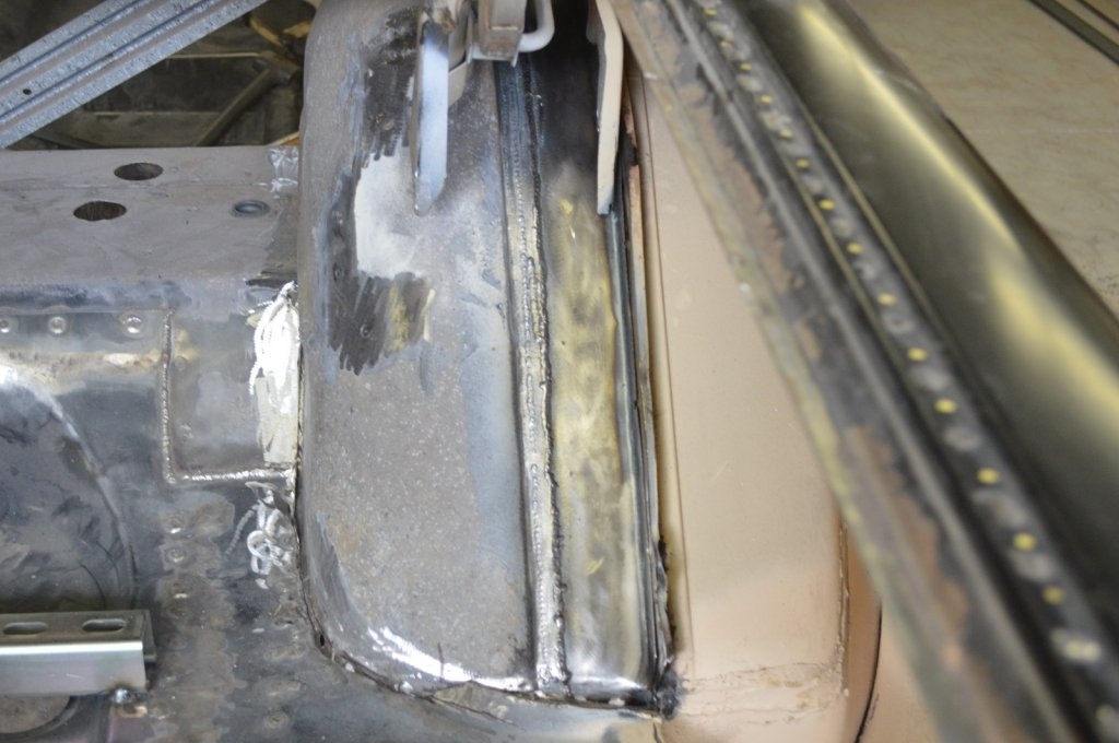

A little update from playing in the shop today. The mini tubs are now completely welded. The additional dutchman panel support brackets are currently tacked and clamped into place. The temporary support in the center of the dutchman panel will be cut loose and removed so the trunk lid can be test fitted. If the trunk lid fits the support brackets will get permanently welded. Pictures:
I guess my next step will be getting it ready to epoxy primer.

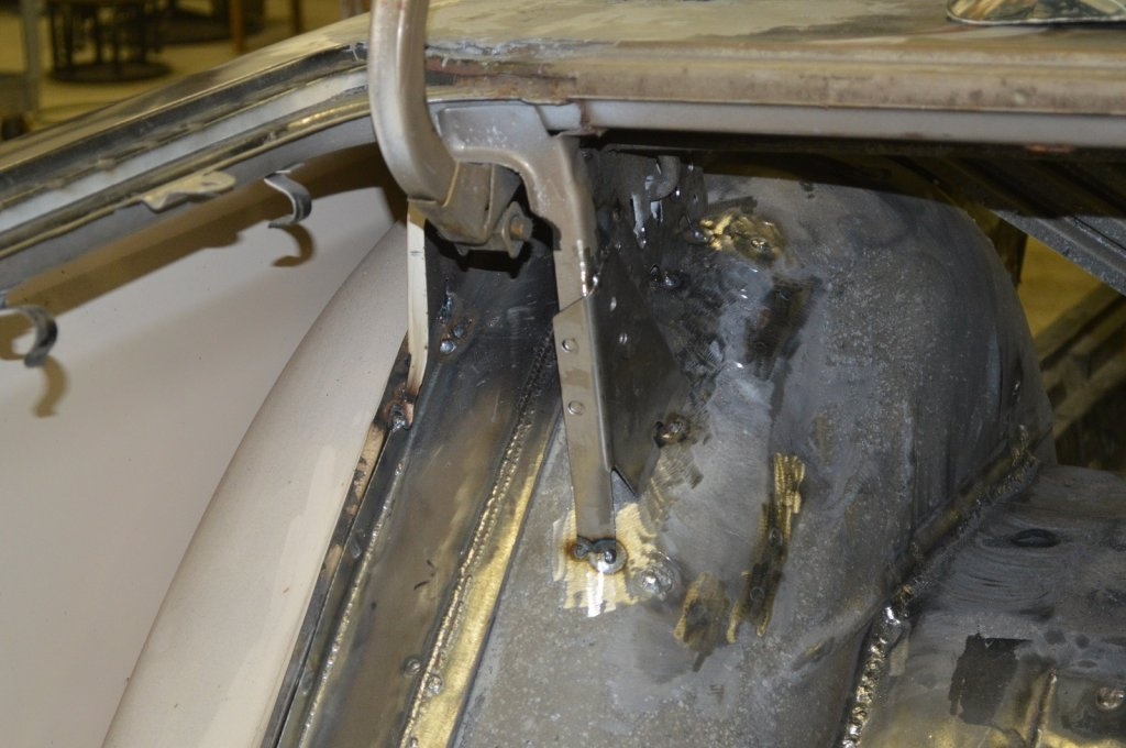

Another update from today. Temporary support bracket cut out of the way.
The trunk lid was fitted.
New supports welded and the trunk lid rechecked...so far it is looking good.

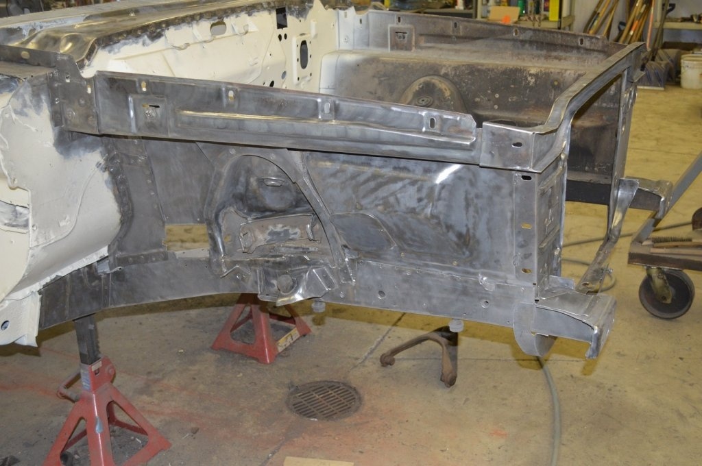

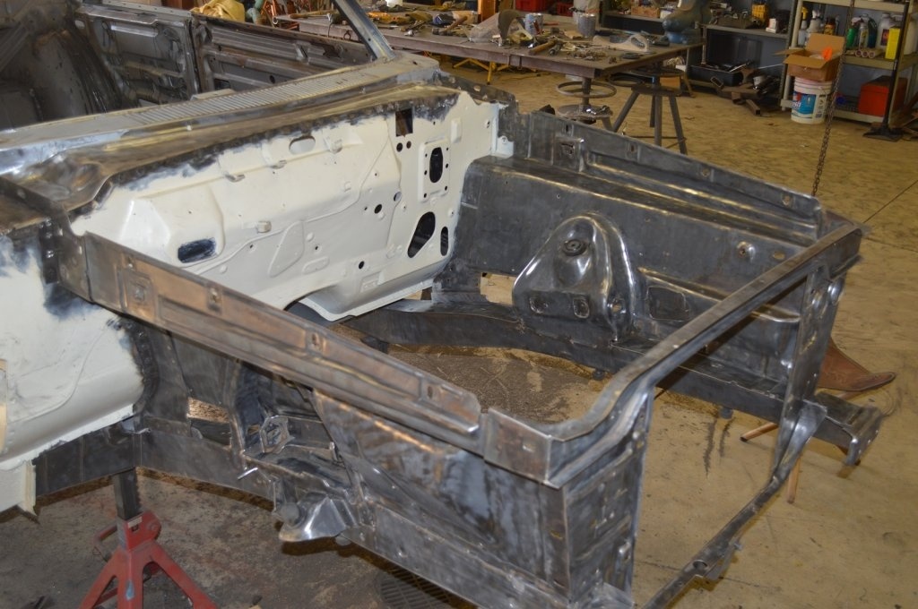

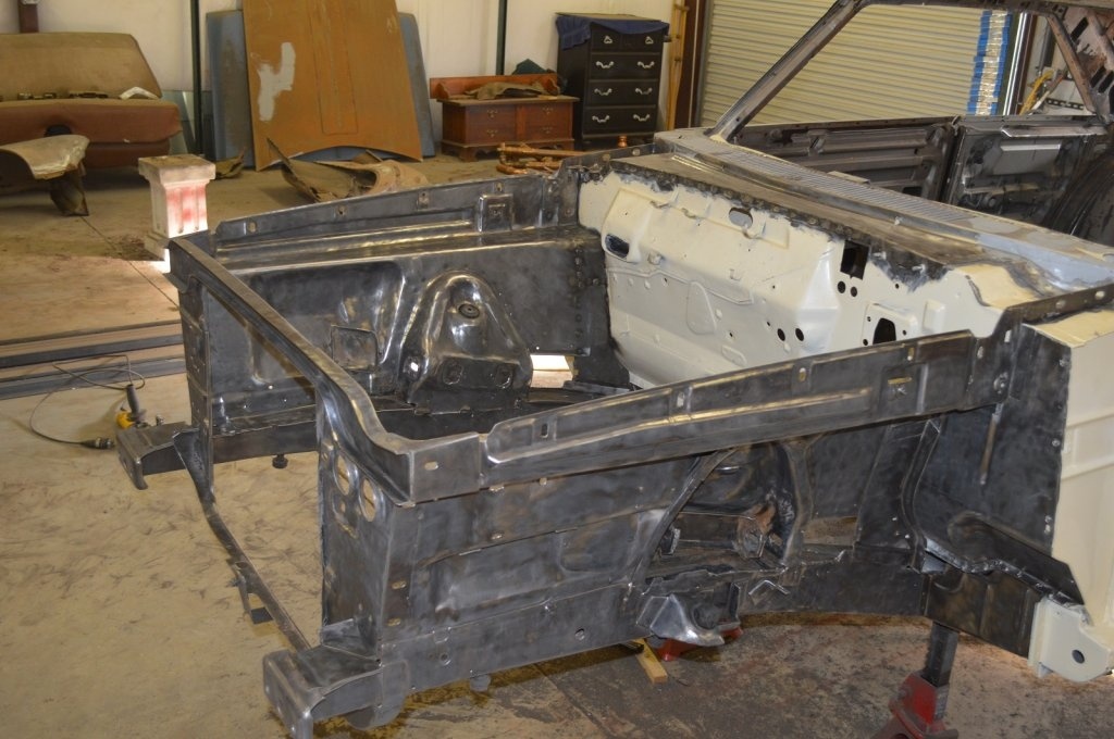

A new die grinder has been bought. I had an some time today to go out to the shop and play. The paint is now stripped off the inner fender wells and the engine compmartment. Still alot more stripping to do, uuugh. For those that are following along here are a couple of pictures:
I was one filthy person when I walked out of the shop this PM.....lol.

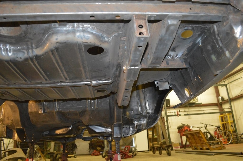

An update for those that are following this build thread. Still stripping paint off the underside of the car. This isn't what I would call fun...lol. I might be laying on my back using a wire brush on a side grinder and a smaller brush on a die grinder, is no fun at all.
As always where to spend the hard earned money?

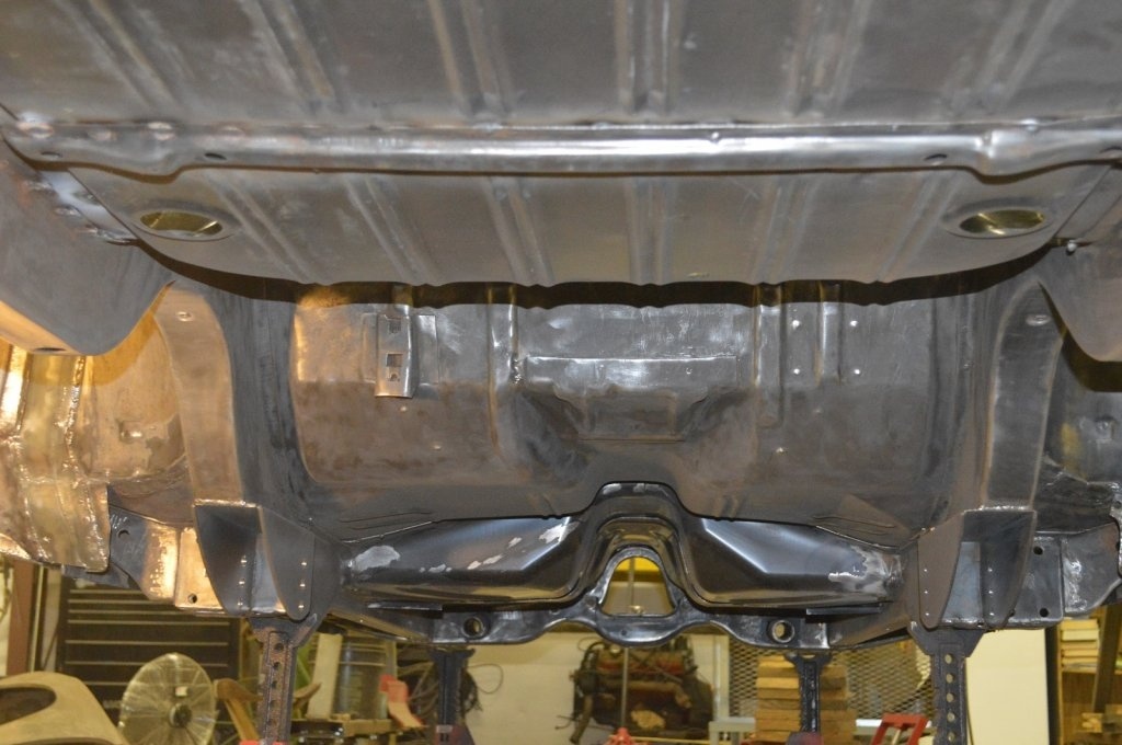

I have debated getting a rotisserie, but Lincoln Welders has come out with a new small AC/DC TIG welding machine. It can TIG weld aluminum and magnesium (magnesium I haven't welded yet), stainless steel, carbon and chromemoly steel. What to spend the money on? Probably the welding machine. I don't restore enough cars to merit spending money on the rotisserie. With all that written picture from today:
Still need to strip the LH rear fender well area back to the rear of the car......
