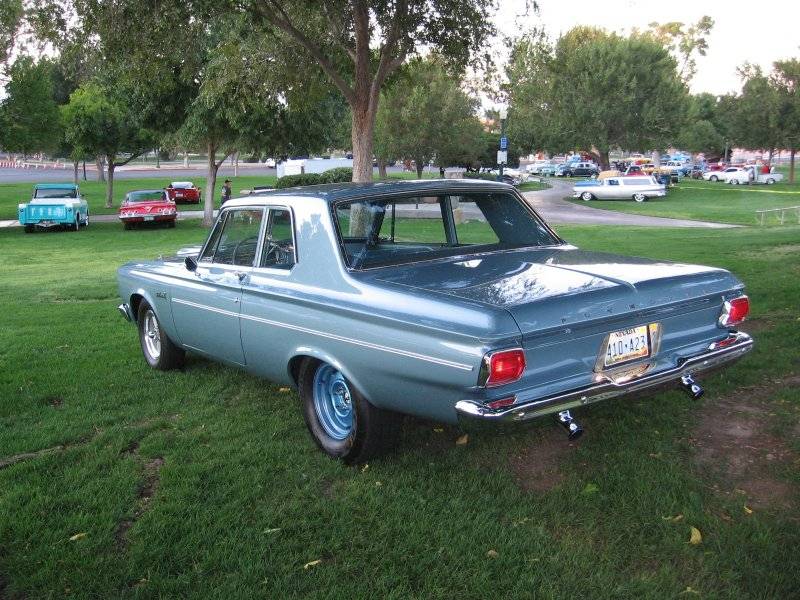

Hey i was just wondering if the 65 Belvedere was a full frame or uni body also what size are the widest rear tires I can run
'65 Belvedere is a unit body car. I think a 255R60 x 15" would fit in there fine, depending on rim offset.
When I first got my car, it had 265/50-15 Gatorbacks on it all around with 15X8 Welds, 4" bs. Later when I replaced them, same wheels, used Cooper 275/60-15 in the back and 235/60-15 up front. No rub issues.
