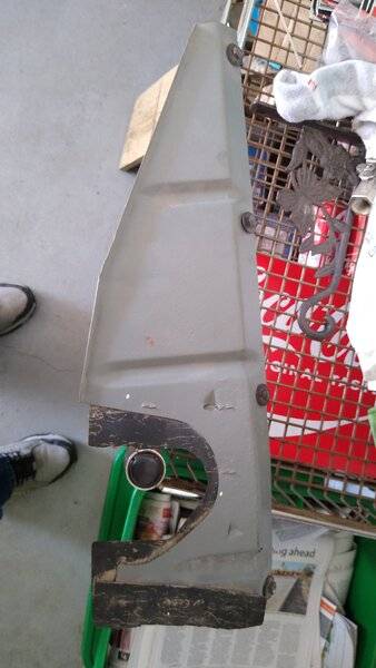

Where does shield fit into the picture? I don't see it in the service book.
Got this feeling there should be 2.
Thanks

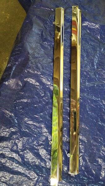

I have trim for a 65 Coronet and 65 Belvedere. I am building a Coronet.
Where do these 2 pieces of trim go?
Thanks
It goes on the driver's side front lower frame rail. It is a splash shield for the starter. The tie rod passes through the notch. Only one per car.
Great on the information!!! I don't need to run one down. Have to look for bolt holes when car comes back from the painter.
Thanks again!

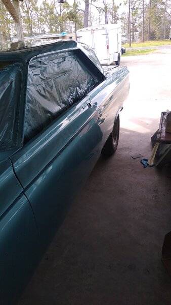

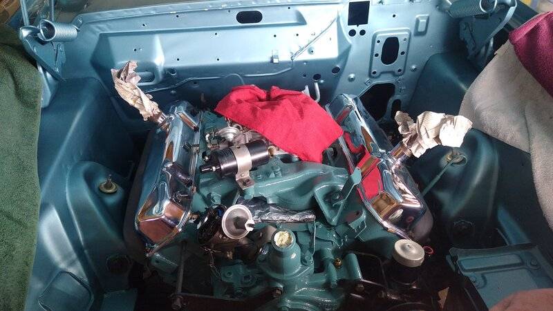

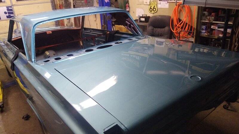

Car is back home! The name Norma Ann has be given to her. The female name of Mr Norm. Time to reassemble her

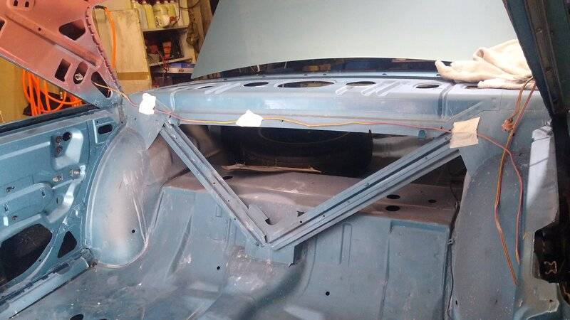

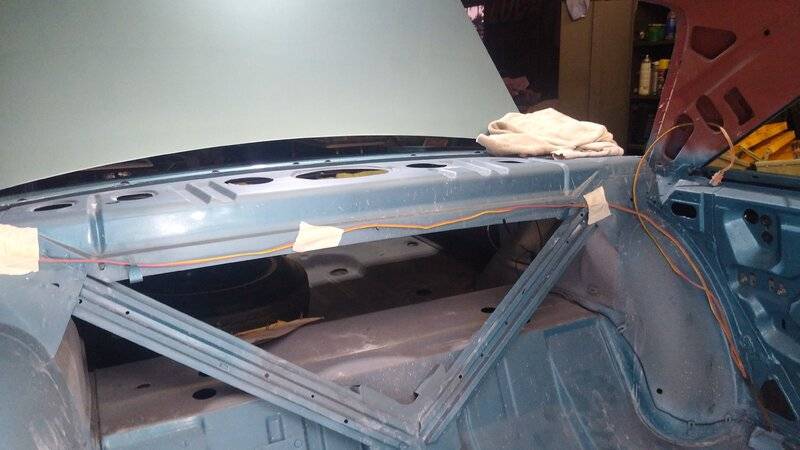

Is this the correct routing for rear courtesy light harness?
Thanks for the help

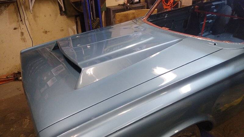

Very nice paint. You can call me a sceptic because I never believed any painter would do the work in anywhere close to a month. Just hasn’t been my experience.
But then here you are with the car painted. It looks beautiful!
Thanks!!
Thanks for the help
View attachment 1225398 View attachment 1225399
Thanks for the help
Mine is routed inside the roof structure with the passenger side across the center and into the roof frame work and down to the mounting point. Hope this helps, hard to explain
