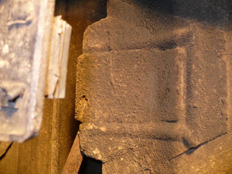

Check for boxed where front of rear springs mount and should be a snubber plate like picture. This picture is right above pinion snubber on rear differential it's a re-enforcement of floor hemi only. Horn and igntion relays on inner fender, not on firewall.

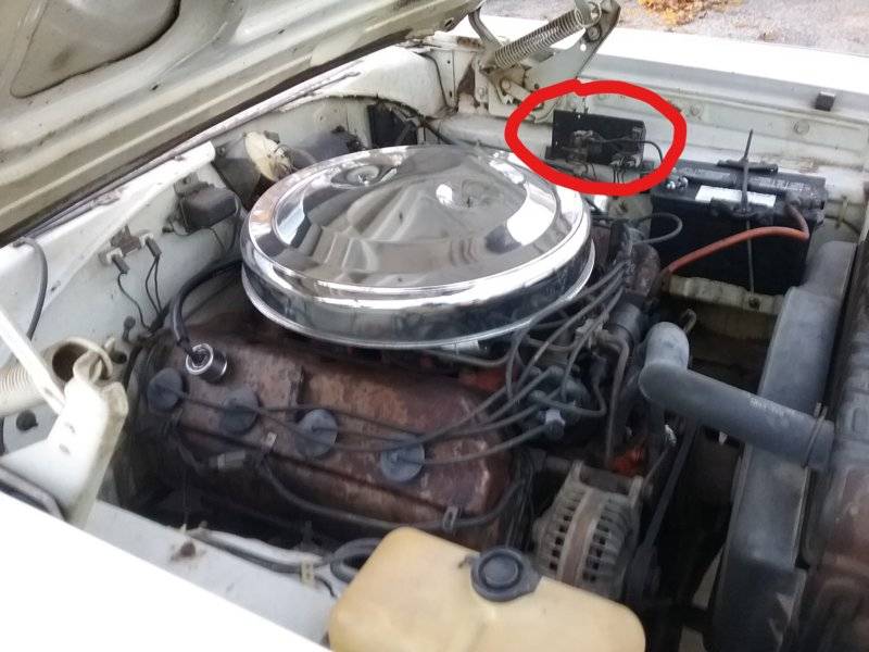

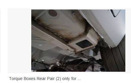

The car should have torque boxes on the front leaf spring hangers if it's an original Hemi car. There's also the '66 Hemi only starter relay mount next to the battery under the hood. These 2 things can be added to a non-Hemi car, but if they AREN'T there - red flags.
Picture of boxed in front of rear springs, they won't be as pretty.

Red circled relay mount on driver's inner fender.

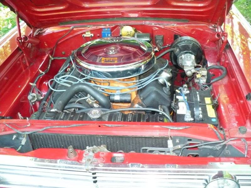

Does it still have the underhood wire harness? If so look for the 4 connector that goes to alt. ignition coil, temp sender, Hemi only from what I’ve seen. Look at the pic on the pass valve cover above.
