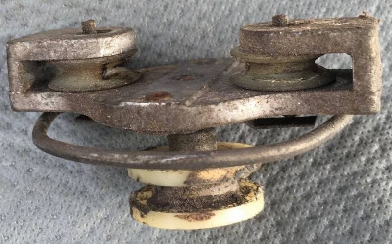

Here's a link where you can download a service manual for your 66. It'll show the adjustment screws & bolts. BTW, 66 & 67 quarter window mechanisms are different. Pull the inner panel and lubricate all moving points first like other have said. Especially the rollers that look like this photo and the rail they slide on.
On mine, the rail was covered with hard wax like grease and the 2 small rollers in the pic below were seized.
My rollers were pretty gummed up too. It’s not easy cleaning and lubing those in place and disassembling rear quarter windows and tracks is quite a chore. There’s no easy way to do this, pull the rear seat and back, pull the side panels and start cleaning and lubing. The FSM is definitely good to have for this. Good luck.
