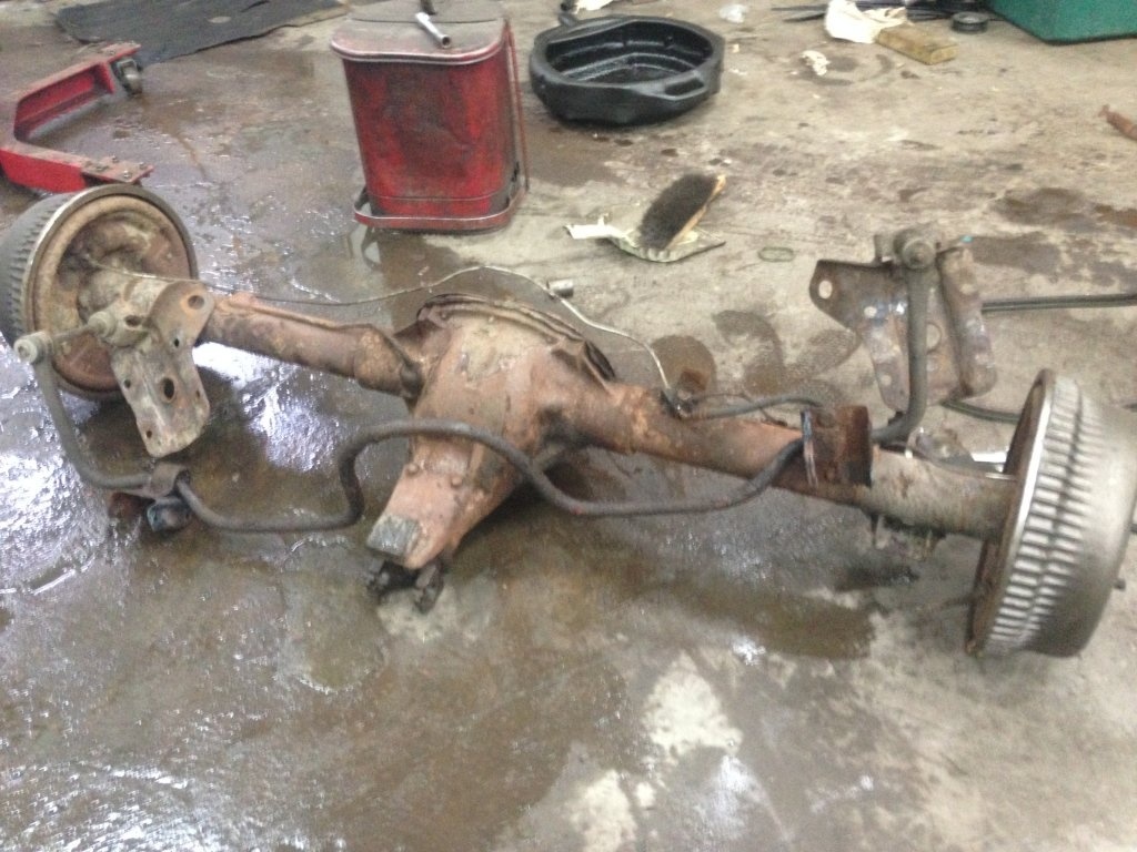

Also i am hoping to use the p.s. and power brake . to fit on the Belvedere with swapping drums to discs , hoping it will work .

I don't think the PB booster and M/C will swap over as the design changed from a 2 bolt to a 4 bolt M/C and the spacing changed at the firewall.
Be careful mixing steering parts as well.

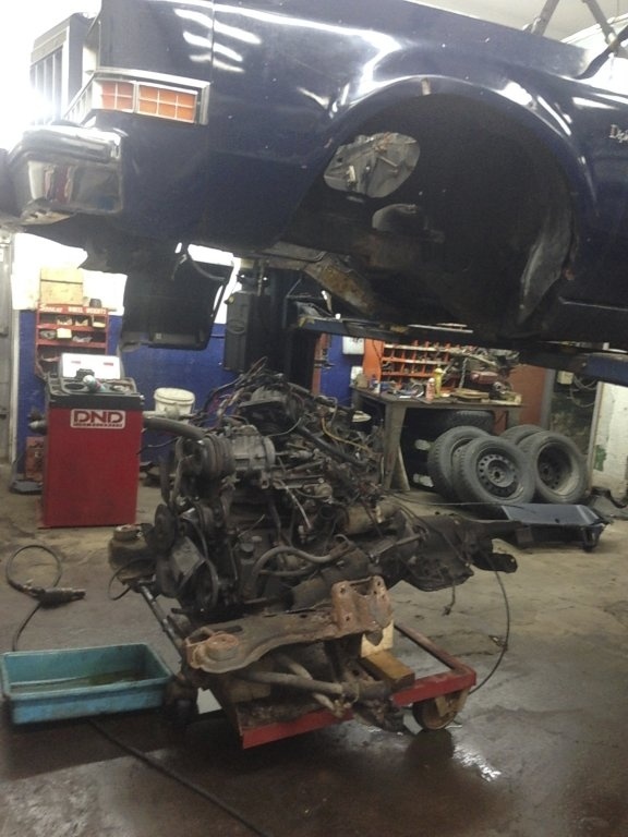

i plan on rebuilding the 82 engine , the hydraulic lifters and they better than the solid ones less head ache.
i was planning to shave the head to up the compression . and what cam should i use stock? I was thinking something
that would give me i lil more power , i plan on running headers . the electronic ignition i took off and will run for sure
my friend has a sun distributor machine so i can dial in the advance where i want it. i just scrapped the old cop car
last friday so have all the parts now , I'm pretty confidant the disc brakes and p.s. will bold right on .
will line up the tie rod end arm to see if the length are equal, and see what turning fro lock to lock is.
i kept the stab bars too hopefully fir them on
