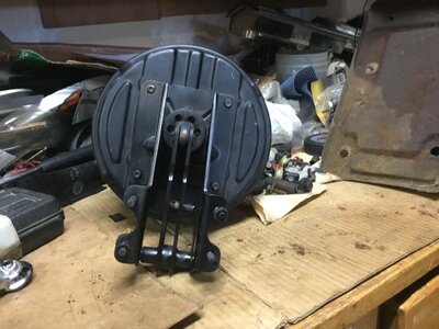

I have one off a car and one on the car, I can take photos.

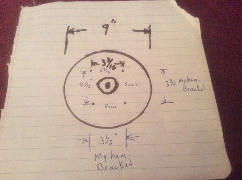

Both of the cars have the booster about 1 inch away from the bracket and the correct linkage. The 68 Bendix booster bolts directly to firewall bracket. I knew this would bring comment. My studs are the same spacing and size as the Hemi backing plate. Onward.
Booster bolt pattern on back of the 440 could be different. Boosters look the same.
If I am remembering right a -
Hemi booster has 3/8 "studs.
non hemi has 5/16 " studs

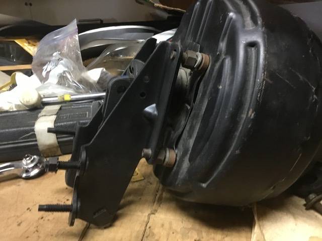

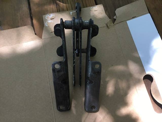

Here are the pictures of the bracket and booster from our 67 L 4 speed. I have a burnt 67 L 440 auto that looks the same. The 4 speed was factory ordered with discs.
