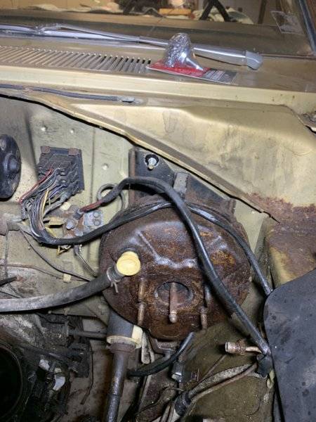

Looking for a good booster to replace the roached out one in MN Gold convert. I beleive these were the Bendix brand....but cant seem to find a part number on the sucker. I'll add some pics, but I'm sure there were a few types from that year....

The booster pictured appears to be a Bendix single diaphragm unit, that is generally used on drum brake installations. The Bendix tandem diaphragm booster is usually used on HP engines with front disc/rear drum set ups. Midland Ross boosters have an external clamp band holding the halfs together and are used on drum/drum installations. A body cars use smaller diameter units.
