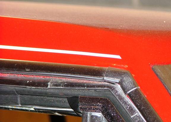

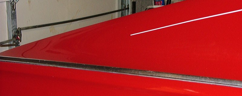

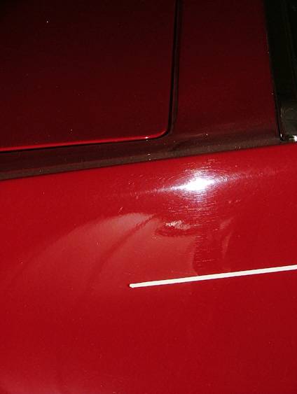

I have a copy of the 1966-67 Dodge Charger Source Guide for the Roof Stripe. However, I would like close up photos of the stripe from the beginning to the end. I need to know where it is installed relative to the roof rail and crease in the metal. Thanks!

I took these many years ago after we put them on my car
I measured a known factory stripe to get them right
