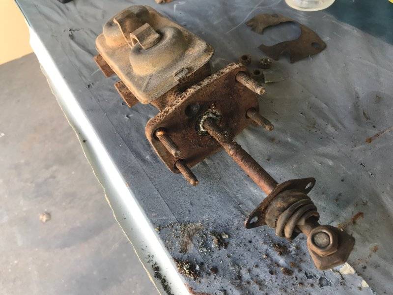

Does this look original? And is it worth trying to rebuild?
That is an Original MOPAR Lid, for sure…..
Flip the Master Cylinder over and see if it has the word
“ Bendix “ ( they were original for MOPAR, and put their name on their product…) and a casting number, like
222 6501…..
If it has those markings, it IS original….
Certainly worth Rebuilding or Resleeving , for you or for somebody else…….
