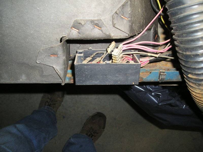

Hi gurus
I bought and underdash harness from yearone for my 1968 Plymouth sport statellite. I'm stumped on my fuse box wires. In my fuse box i have a bunch of pink wires on connectors that are not in my new fuse box. How do i go about attaching all these wires to the new box. here is a picture attached as reference. Its not my picture but its the same fuse box look as whats in my car now. any help would be appreciated.
Chris
I coulda swore you can slide that whole stacked brass connector setup onto the prong on the new fuse box but its been awhile since I did the wiring on my Charger......I could be wrong but I thought that's how it was transferred.
i think the same thing it should be a spade connector some have a small catch may need to wiggle to get off. that looks like a top stack i.e one on top of the other hooked to a common terminal with multiple male spades . i think ?

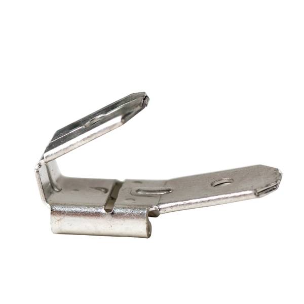

It should look something like this. And be able to slide off the main terminal.

Thanks guys for all the answers. I do have console lights and convertible top plus what ever else is plugged into the fuse box. This gives me comfort that i wont have to drill out copper rivets and figure out how to do any modifications to the new harness. Damn thing cost me 800$ us so around 1100$ canadian. Not chump change for me. Trying to slowly fix up my baby to more than sunny day drives only
