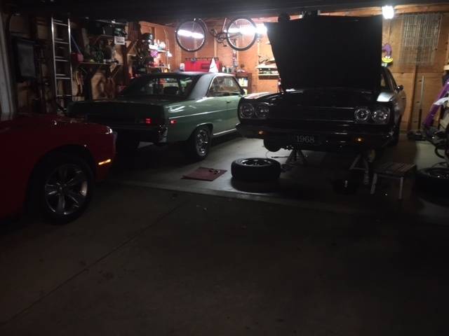

As Promised....
The Stable

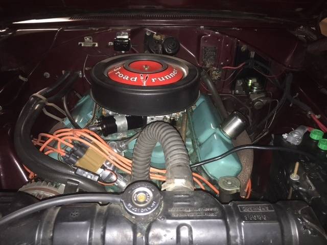

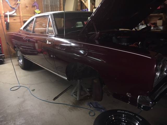

Engine

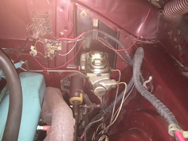

Master cylinder

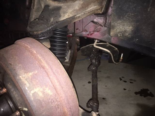

Brakes (so far)

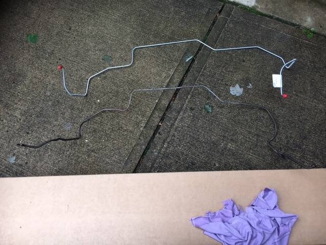

Making some progress....Out with the old, in with the new
Wrestling with the large line across fire wall...

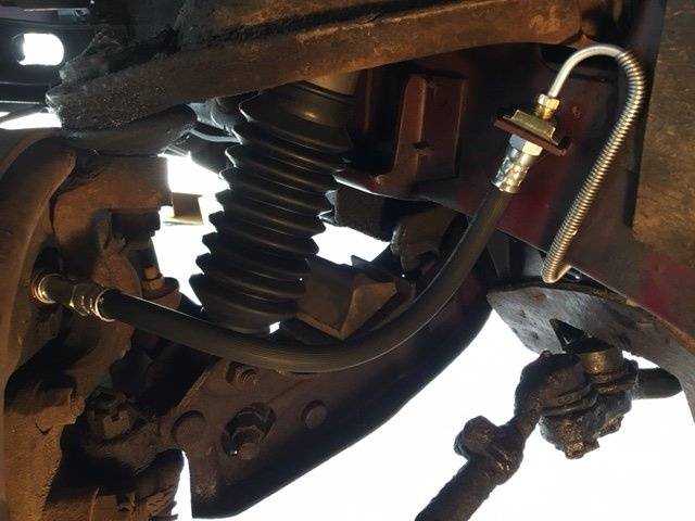

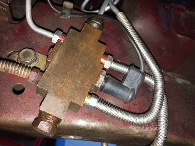

finished for now
I would grade Fine Lines products C.
They definitley needed to be tweaked a bit ESPECIALLY the two short lines running from the Master Cylinder to the Proportioning valve / junction block.

Well..... Today was not my day. Tried to bleed the brakes and nearly rounded off a bleeder screw. Front resevoir went down too low. Yeah, I bench bled the MC, but now will have to bleed the MC on the car.
No difference between wooden dowel pushing it in on a vise and brake push rod pushing from inside the car, right? FAAAAAck!
I've only bench bleed one master, and it didn't make any difference, didn't save any time.
