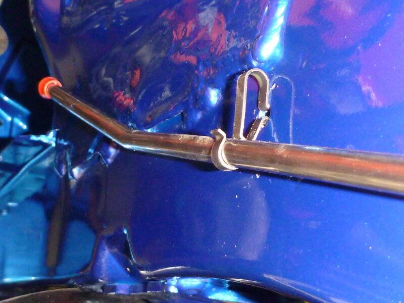

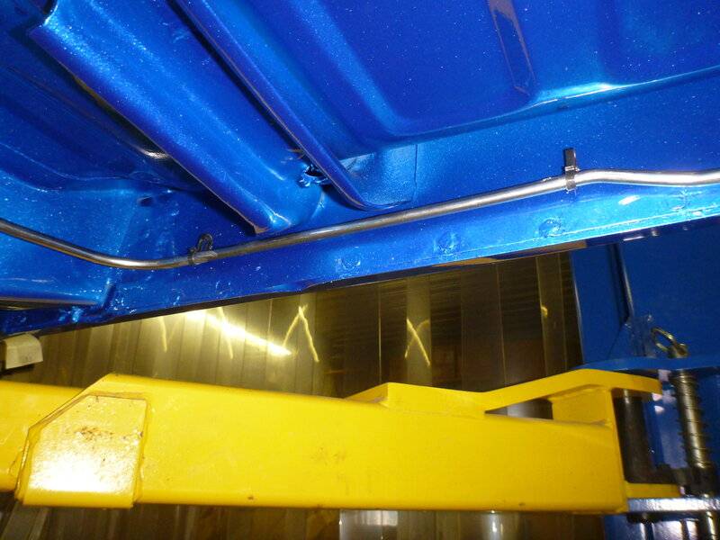

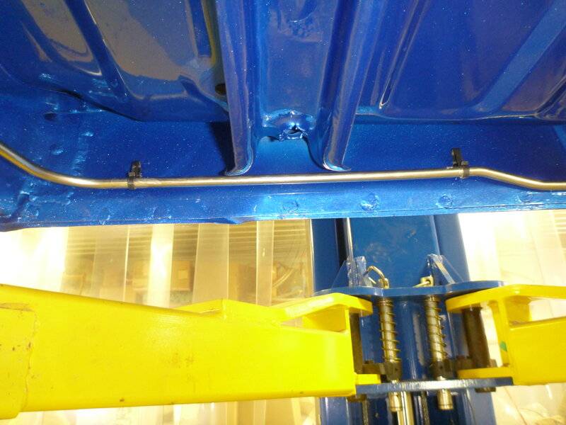

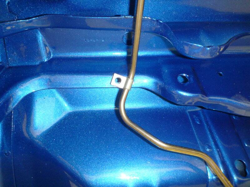

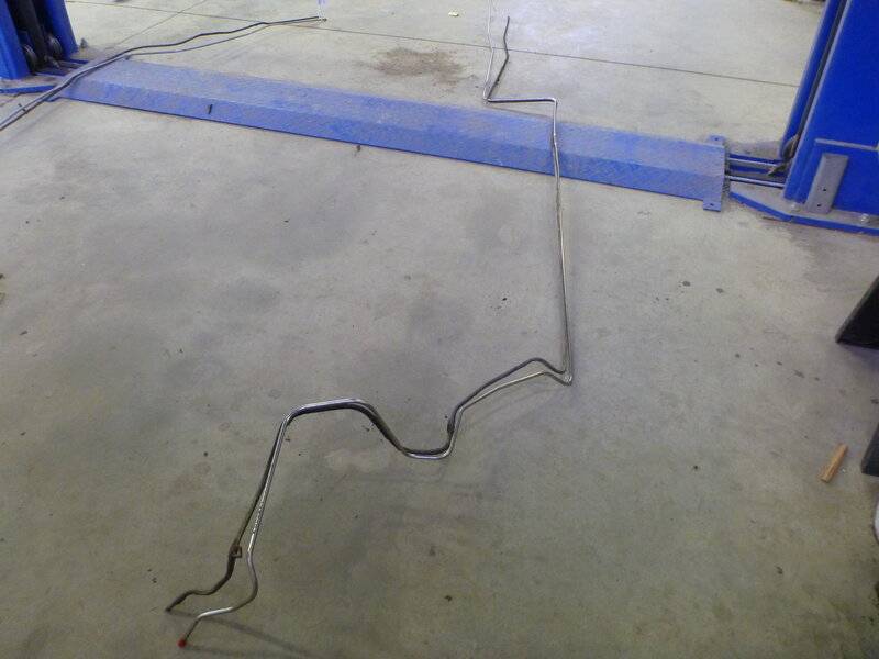

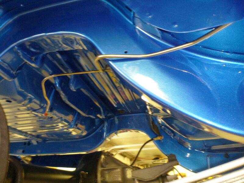

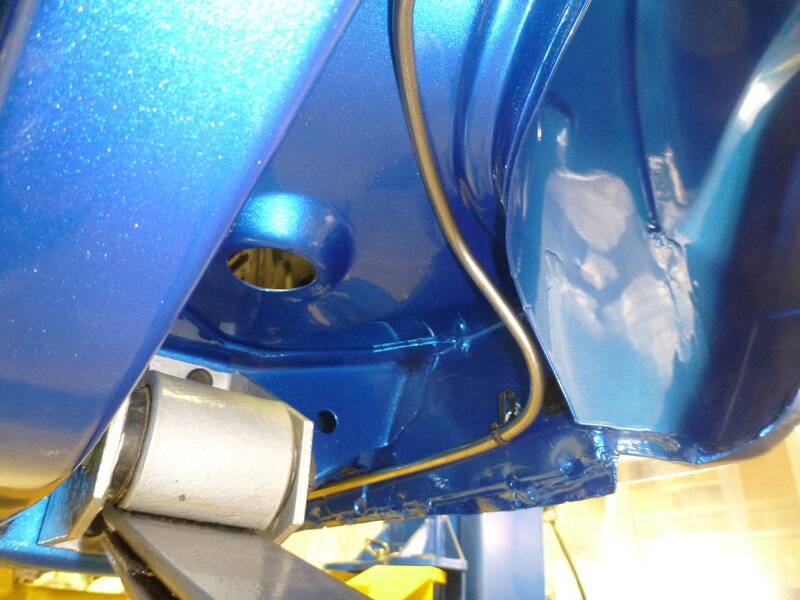

So the steel fuel line specifically for the 69 bee from most sites is around $70 plus shipping. I just found a 25 foot roll of coated steel 5/16 inch fuel/brake line for $18.99. I’m not going for Concourse so I’m thinking maybe I should just make my own line. Has anyone done this before?
Many have made their own lines, no different than brake lines. Here's shape and route if you want it correct.
