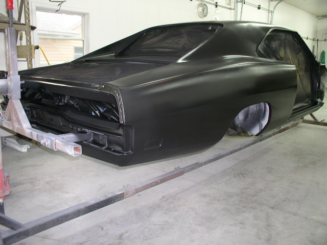

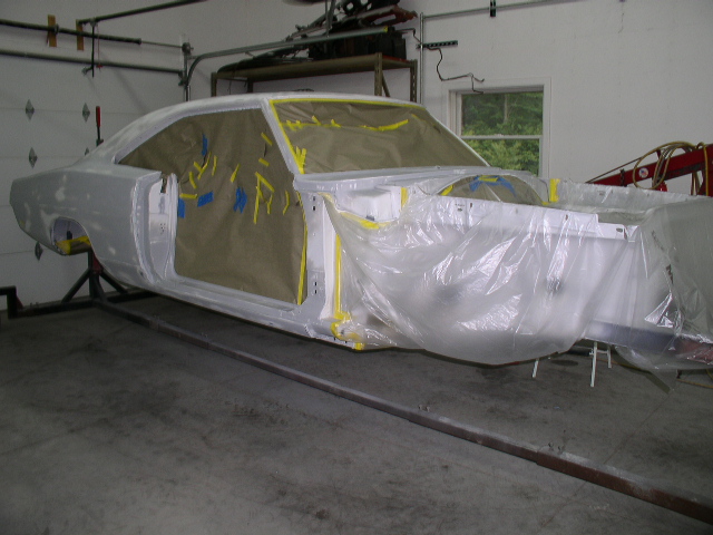

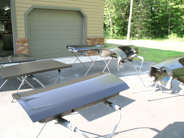

Figure I better get this thread updated before I get to far behind. We have spent every evening in the last 2 weeks working on the resurrection. The exterior shell and all bolt on parts have been blocked to 220 grit.
We then sprayed on 2 coats of a mid build primer. This is going to sit for a month before the final 400 and 600 blockings. This should let any shrinking that's going to happen take place so it won't come out in the paint.

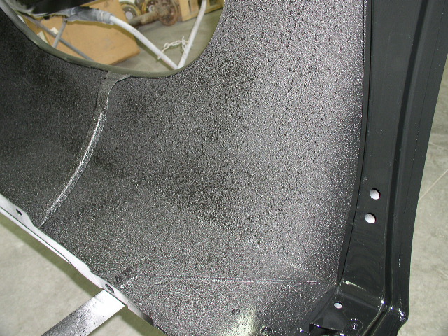

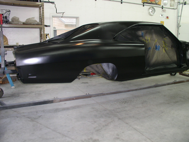

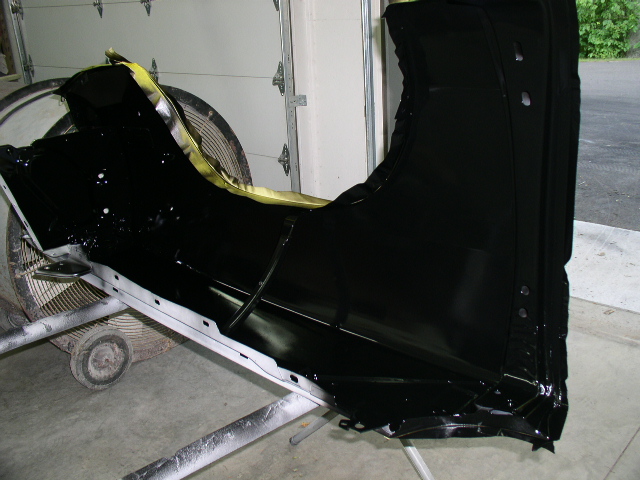

Next I wanted to get the undercoating on the rear quarter sides. I made a cardboard template copied from my Road Runner and taped it over the side marker. I am using the factory style undercoating that came from Restoration by Rick. I think it is a very decent product and looks good. Per Ricks directions we sprayed in 3 coats, let this dry overnight and then sprayed on another 3. It builds up nice with a decent texture.
At this time we also sealed, painted and undercoated the insides of the front fenders and the rear wheel wells.

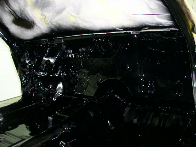

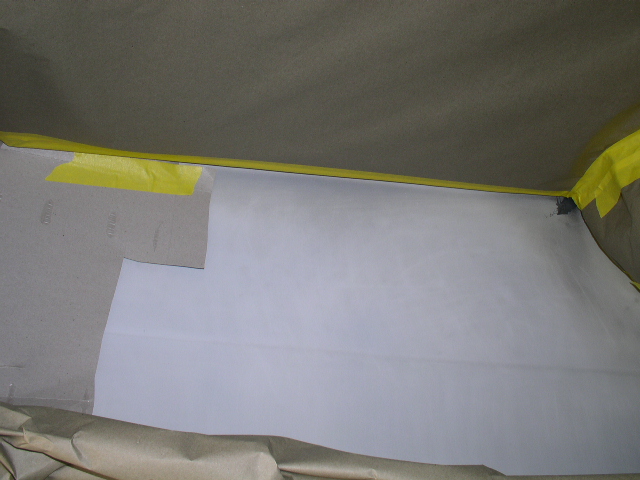

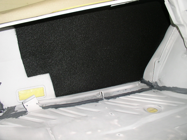

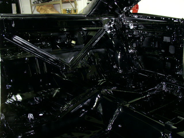

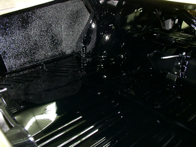

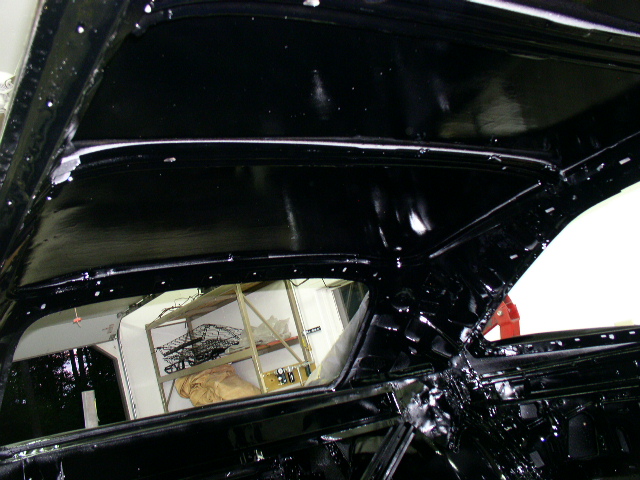

And then a very long day of sealing, painting, and clear in the interior and trunk. Here are some pictures, but they don't show up the best because of the lack of color.
As everyone can now see, I chickened out on the orange paint for a 2nd. generation Charger and decided to go as black as possible. The color is Martin Senour 8805 Factory Pack black. The ultimate black with nothing else added in. This would be equivalent to PPG 9900. This is what the wife wanted all along, so being the great guy I am I decided to keep peace in the family. This has been a great weight lifted off my shoulders to finally have the color picked out. I will admit that Props "Skeletor" (sic) was a huge influence in this decision. So thanks a bunch Will. Now the only decision is the color of the rump stripe. The better half wants matte black, while myself and 2 boys are voting for white.
