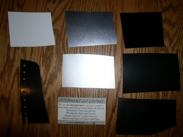

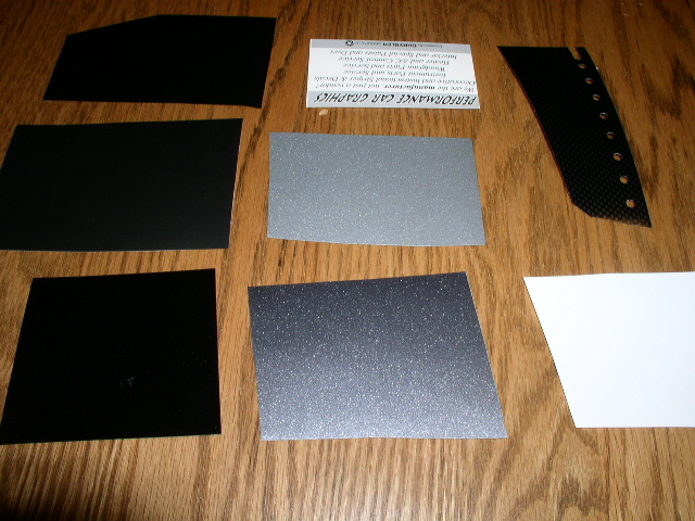

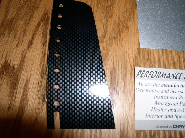

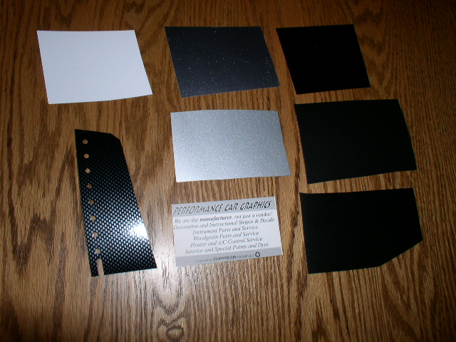

Not sure what the deal is with Phoenix Graphics. 2 weeks and 2 phone calls to them and still no samples of vinyl for my rump stripe. So I called Performance Car Graphics. The guy on the phone was a great help and said he would throw some samples in the mail. 3 days later they are in my mailbox. He sent gloss white, gloss black(for comparison), matte black, flat black(you can't ever get any wax on this one or it will turn milky), satin silver, a cool slate silver metalflake, and 1 called carbon fiber black/silver. Decisions, decisions....

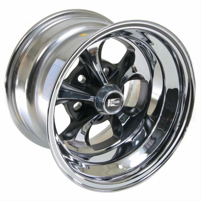

And on another note. With all the cars being dug out of barns and showing up on here recently and sporting old Keystone Klassic wheels, I had to inquire as to getting some made to fit the Charger. These were what I used 30 years ago and I still like the look, plus the little Philly has her heart set on them also. What the hell, she got her black Charger so why not her choice of wheels to - right? I am looking for 15x10 for the rears with a 5 or 5.5 inch backspace. This I will have to determine when I get the rearend in place hopefully in the not to distant future. The stock bs on this size is 4.125", so no good. I called Summit and got ahold of a really decent man who called out to California where they are made to see if it is even possible. No problem was the answer and even better was that they would be $8 cheaper than the standard size. He even double checked the price and it was confirmed. Even the 4 weeks to make them up wasn't unreasonable in my opinion. The only thing I was hoping for is they would make them up in non unilug, but they won't, so I guess I would have to live with that.

H2E, Always liked the look of Keystones myself. Those samples sure give you something to think about. Glad it's you and not me. The carbon fiber one is different. It looks good though.

Picking colors on this car has been challenging to say the least. At least the stripe would not be as hard to change after the fact if I didn't like it - unlike the body color.

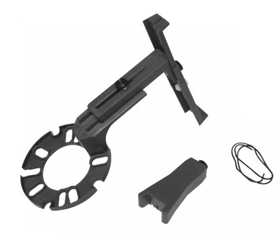

Ordered one of these tire/wheel measurement tools from Year One yesterday along with a couple of other small things with their 30% off sale. I figure $50. is cheap insurance to get the right backspace if I do go the custom route.

I like the Cragers too and have them on my RR. Just thinking I might need something a little different on this one.
I really don't care for the uni lugs but seems thats the only way, my old Cragers are the same, i hate them.
Nice choice on the wheels Joel, gonna look tough with 10" width on the rears. And thanks for the tip on performance car graphics, I'll be going to them instead now. Imo any dark gray or silver is an awesome stripe color with black body color, can't go wrong with that

Can you believe Phoenix Graphics still hasn't sent me the samples they told me were in the mail - twice? Site sponsor or not, I'm not ever giving them any of my business. Can't stand when people don't follow though with things. Do you think that stripe is matte black, or some kind of charcoal?
Wow that's ridiculous. It's sad that so many vendors have that exact same problem. Took me 6 months to get my wheels from coys (keep in mind I paid in full the day I ordered), seems like customer service is a lost art nowadays.
And that stripe is like a gunmetal/ charcoal grey metallic. I'm kinda split between that and flat black, keeping the wax off the black sounds like a pain
I really like the pic Speady posted "sweet". I went with a company up here by me "Pro Arts & Signs" for my rump stripe masking and just picked it up today. They have some really impressive looking work and get it done quickly "they had mine backwards" but made another one the spot for no additional cost. Good luck with the selection
Sounds like the flat black is the one you cant get any wax on. If you happen to get some on the matte there is a new product that will take care of it.

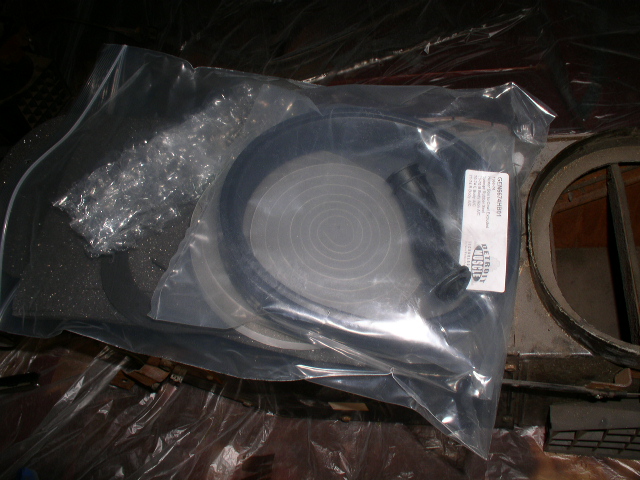

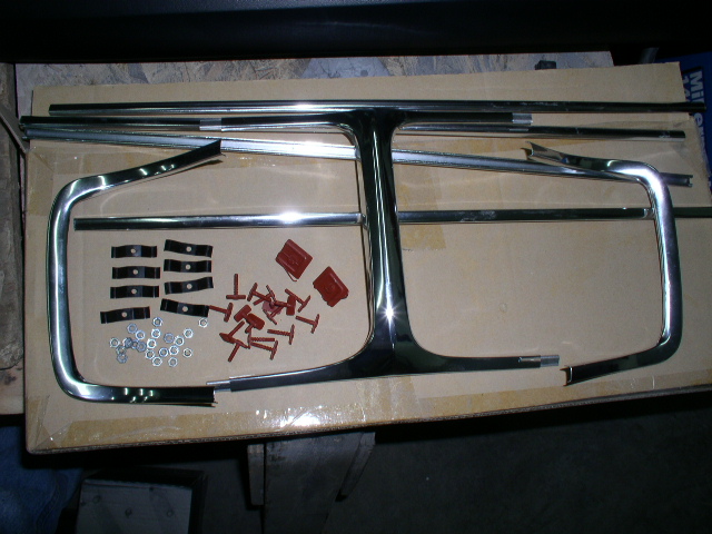

Well this past weekend I had big plans on getting my grill assembly together and set aside so I don't have to worry about damaging it. First thing I remembered is that the R/T emblem is still backordered for the headlight door, so that will have to wait. And then my original trim to grill fasteners were not in as good of condition as I thought they were after cleaning them up. So I ordered the stud/nut kit from Mega on Tuesday and it arrived today. 2 days and only $2. in shipping costs. I wish other vendors would treat their customers as well as Mega. On a side note, I bought the actual trim kit from Jeff @ 521 Restorations when I got all my sheet metal. There definitely is a thickness difference between the old and new, but it is not bad for a repo part made overseas. And it looks a whole lot better than my originals.
I also got the heater box gasket kit from Detroit Muscle Tech, so I have another project waiting for some of my time.

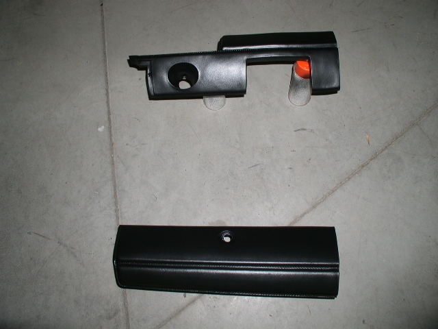

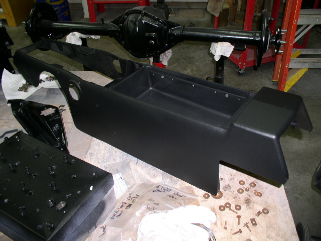

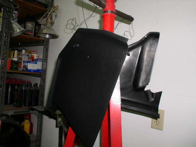

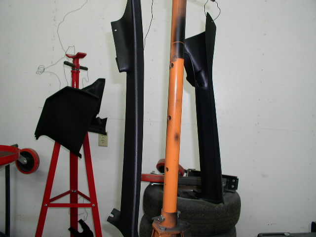

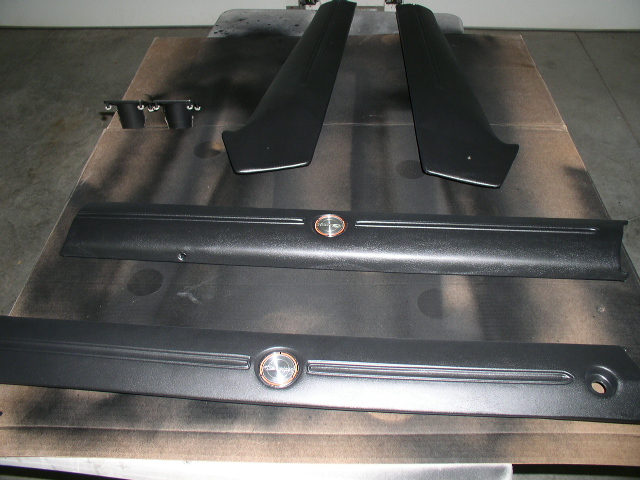

So with not being able to put the grill together, I decided to get all my interior trim freshened up. I used all SEM products to clean, adhesion promoters, plastic prep, and paint. I've used this stuff before and really had good luck with it. I use Landau black on all the soft trim and Satin black on all the hard plastic. One new thing I tried was the low luster clear on everything for a little better protection. After this I started on cleaning up some of the door parts.
