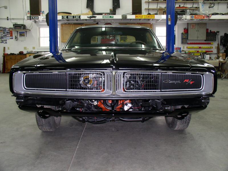

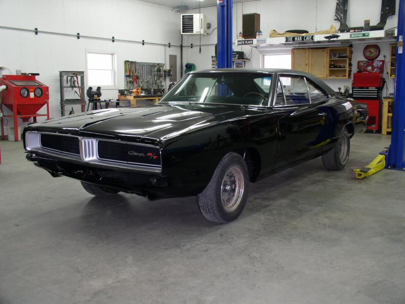

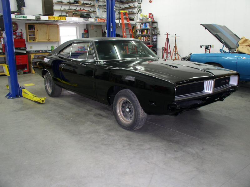

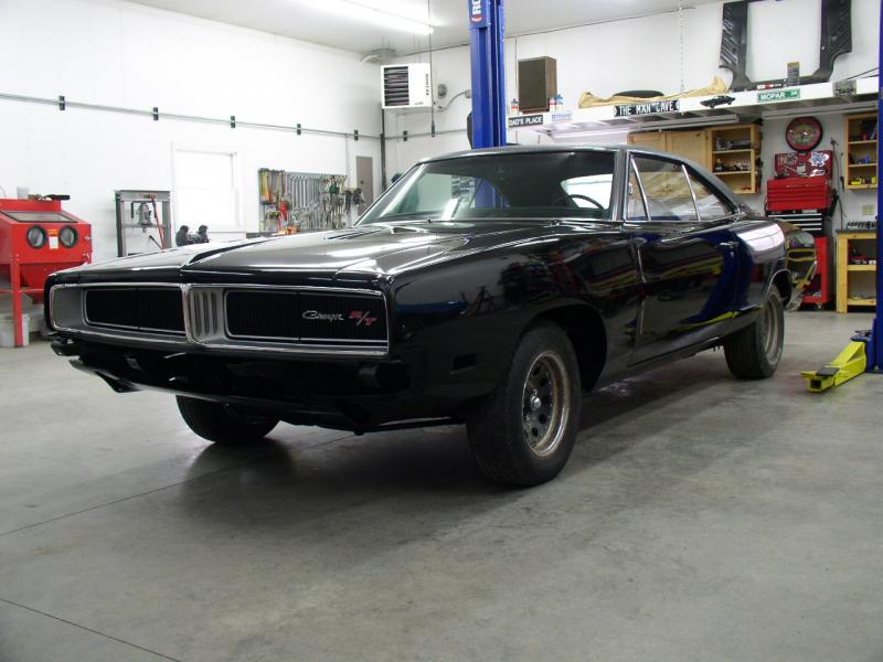

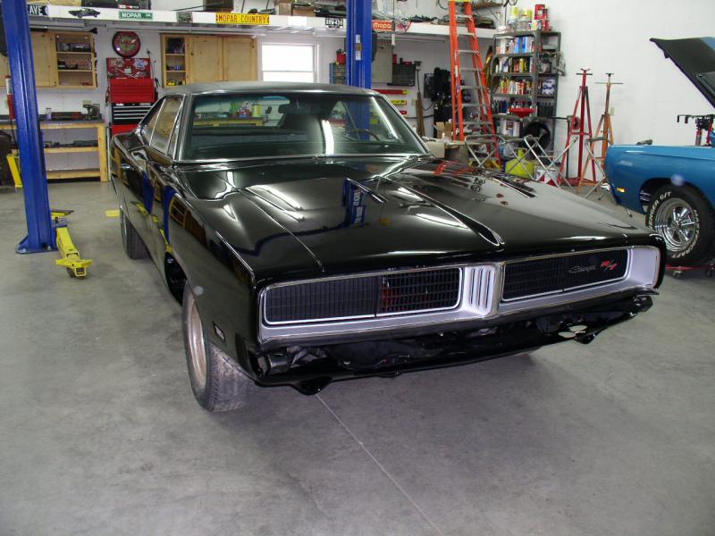

Thanks for the kind words guys. I'm to the point that I have to make a decision if I want the car wet sanded and buffed. I have kind of a mixed camp around here and was wondering what your opinions are. It came out real nice, but of coars there is a uniform orange peel on the vertical panels. The bodyshop that sprayed the exterior doesn't like to buff whole cars, just fix the runs in the clear. They think leaving it alone is the easiest to maintain, leaves a wetter look, doesn't attract as much dirt, doesn't need to be waxed every month, leaves more of the uv protectors in the clear, and as it sits now is far better than the factory sent them out. Two of my buds who have done bodywork in the past looked at it and said they would not buff it if it was their car either. On the other hand, the kid who did the bodywork feels that every car should be buffed to get it looking perfect. Bare in mind that this will be a driver and I don't care to polish it every time I want to take it out for a drive. Thoughts and opinions on this??
