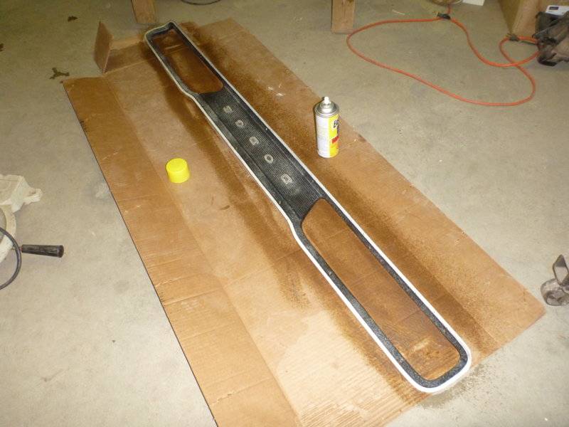

This tail panel trim plate is in very good shape. Thought I could just give it a buff and I'd be satisfied with it ready to repaint the black areas.
Too many scratches that are through the anodizing, so I guess I'm stripping it clean and polishing it out to remove them.

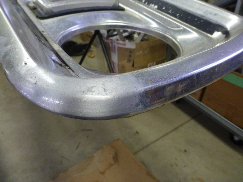

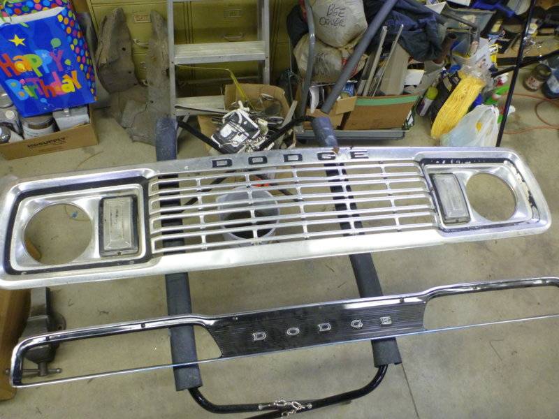

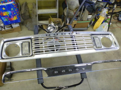

Thought I'd practice on something less valuable. The grill out of my '78 Ramcharger.
It's not just for ovens! And you'll see why you don't get it on anything else!!!
Quick spray on a corner of the grills anodized aluminum.
30 minutes later and a water rinse. The bright anodize is gone.

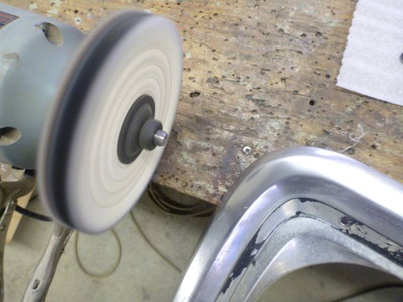

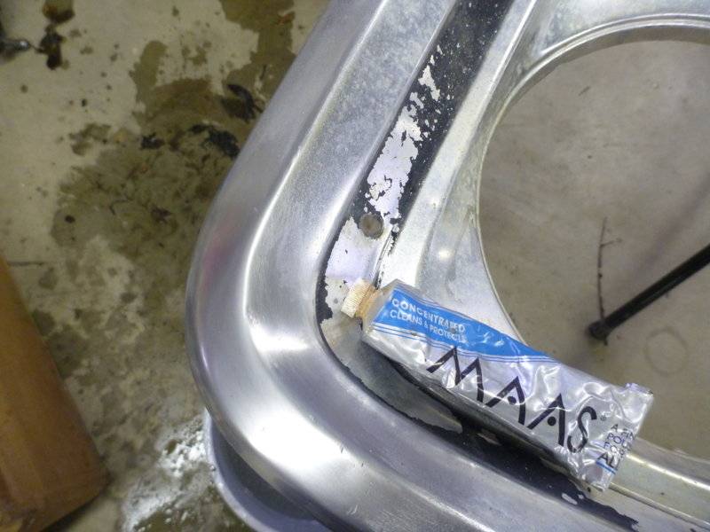

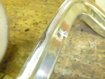

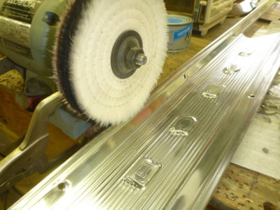

Sanded with 150/320/400 as shown here to get the pits and divets out and then 800/1000/2000 wet sanded. Probably should get some 3000 or 4000 as well before I do the Bee panel.

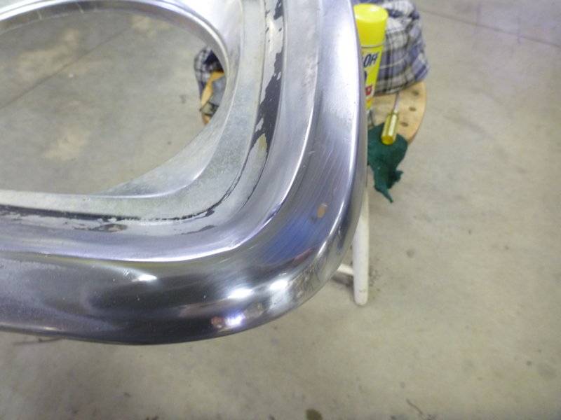

Cut and buff with "stainless" green and then rouge.
Hand polish with MAAS.
Came out not too bad, it's sure brighter and more reflective than the old pited bright anodized area.

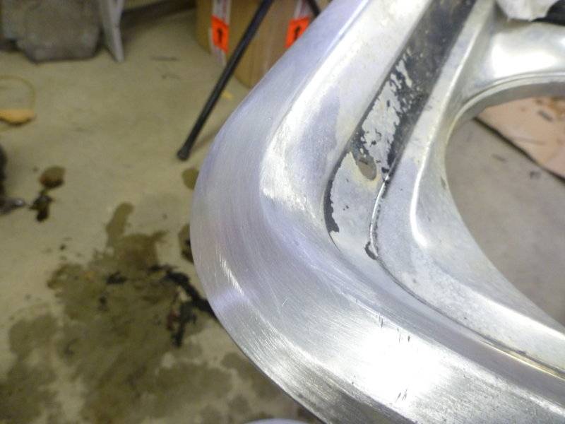

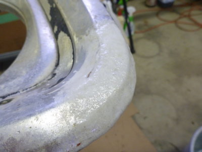

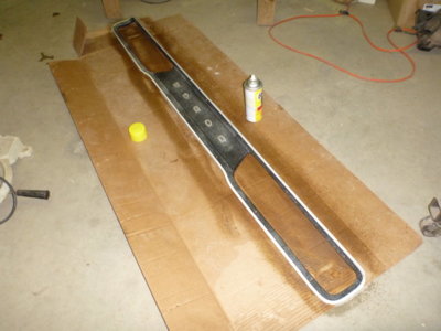

Not brave enough to try the trim panel I'm using first, so I tried stripping the anodize from my original OE off of the car to see how it went. I left it almost an hour with multiple reapplications and covered with plastic to cut evaporation. Not happy with the spotty results. Looks like I have to find some lye locally to make a solution to soak it.. and of course I have a 25 lb bag for the outhouse but it's 4 hours away at the lake!

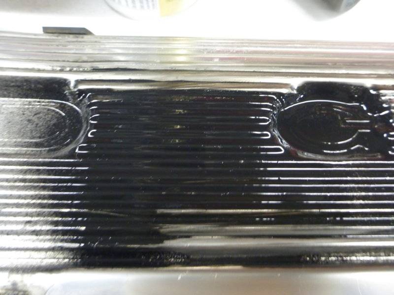

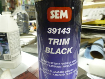

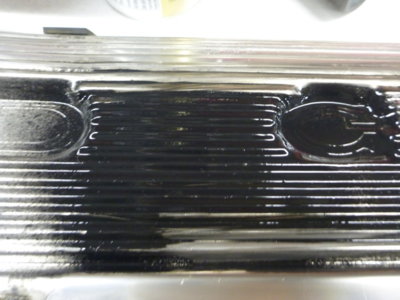

While the Easy Off was eating away I thought I'd try the highly recommended SEM trim paint on the back of the panel I am using. I bought multiple cans of this overpriced paint in anticipation of doing the grill and tail panel.

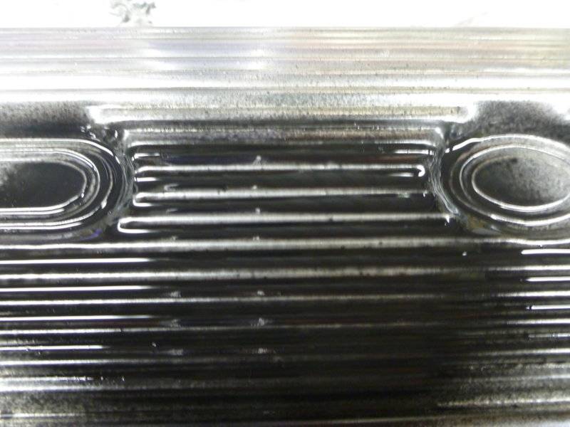

The SEM just runs off the peaks of the corrugations. It took NINE mist coats x 5 minutes apart to get reasonable coverage.
The Rust-Oleum that I used on my instrument cluster.
It took a SINGLE spray to cover better than NINE of the SEM. Either I'm doing something really wrong or Rustoleum makes damn good paint!

I used Duplicolor Semi Gloss and I think it's as close to factory and covers well. Etching primer is an option on bare aluminium also. See how this matches up to what you're looking for.
Thanks.. I just can't believe that 50 years later SEM's paint (that says with prep primer is not required) just runs off, compared to Ma Mopars paint of the day that one light coat got'r done without primer!
Paint has changed over the years with all the EPA bs. Even automotive paints aren't the same in the way they cover. I've tried all of the rattle cans lately and the Duplicolor has it all over the rest. It still acts like it should and even has the Sherwin Williams blue tip which makes a nice patteren.
