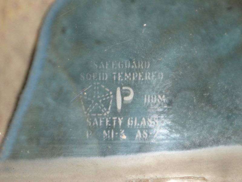

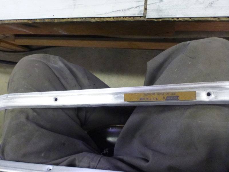

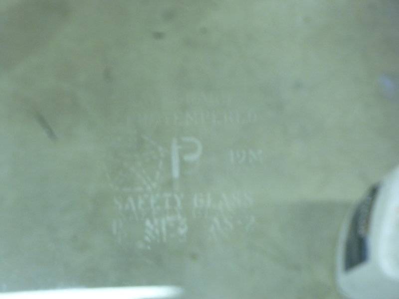

The one I put in is 128. I have 118, 19 and 39 as spares ! LOL Let me look for a picture.. or I'll go get one shortly. I keep procrastinating about making the 30 foot walk to the shop in -28C..
128 that I installed.
118 spare.
My OE 19
No rush Wayne for that frigid walk....the date and the logo are the clarifiers......
Here is the best pic I could find of the original rear glass.......Your logo style is the same as the one originally on my X.....My date was 108...

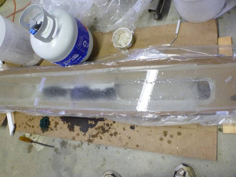

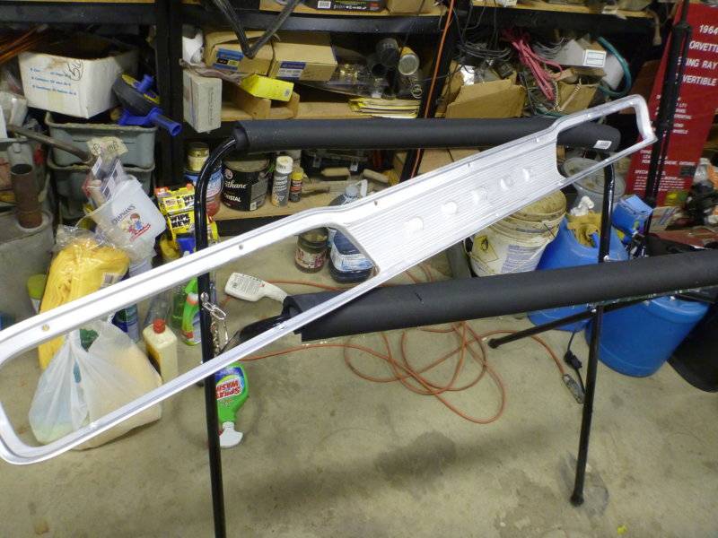

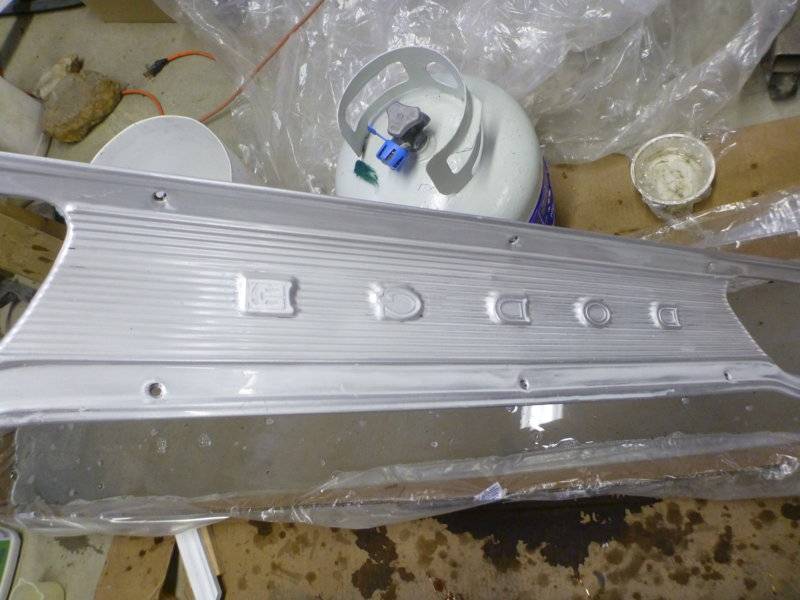

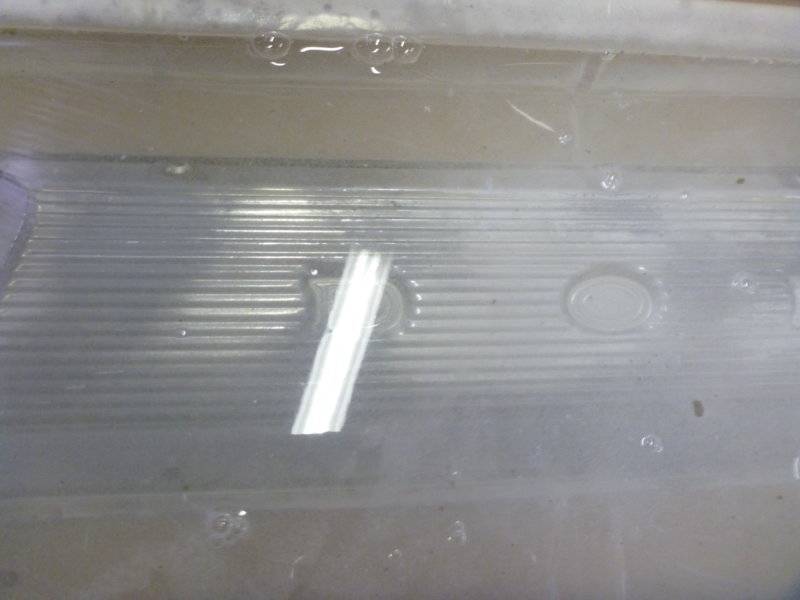

Soak box made from a propellor box and a roll of vapour barrier. If we're going to make hydrogen gas we may as well have some more flammables to help with the BOOM! (My OE panel shown, in just water... I only did the replacement in Lye).

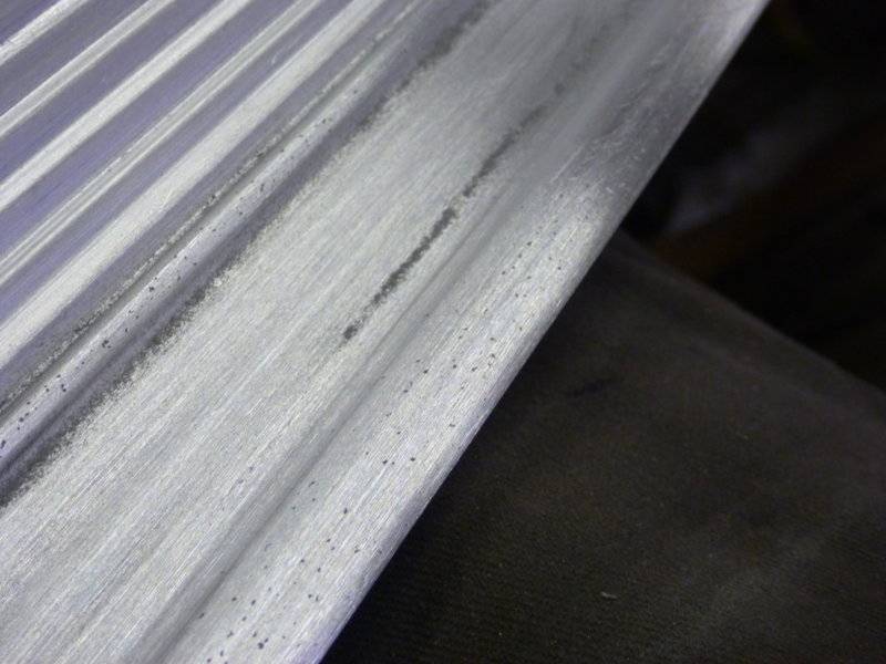

8 gallons of water and a volume measured 48 ounces of Lye crystals. You can see the gray and shiny spots as the anodize starts to come off. Only place I found Lye available was Home Hardware in the septic department. $30 for 3 kg.
Boil and bubble..
Almost there after 25 minutes. Still some anodizing to come off. A light scrub with green scotchbrite and back into the soup.
Nice and clean of all anodize.

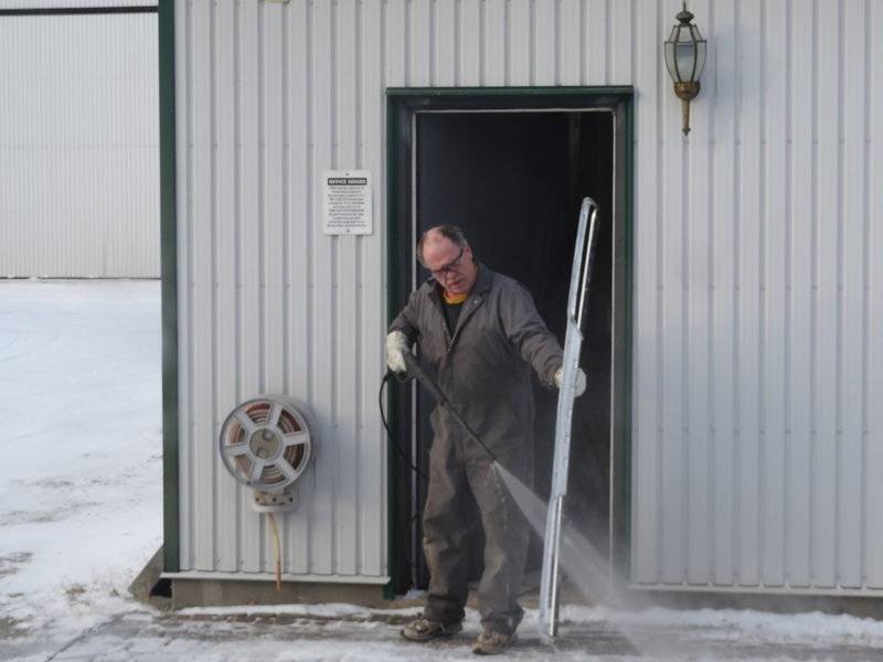

The wife caught the nut with the power washer from the kitchen window. -20C outside. Power washer not only rinsed, it took the blackish/gray sludge off from the process.
Ready for a LOT of nick removal, sanding and polishing. I ended up leaving it soaking for 45 minutes. I should have pulled it at about 35. The extra 10 minutes was when it really started to fizz. I should have known better and it added some minor pitting in places as it started to eat the aluminum.
Boil and bubble..

Doing that work outside......in that weather...
Now that is a true Mopar guy:thumbsup:

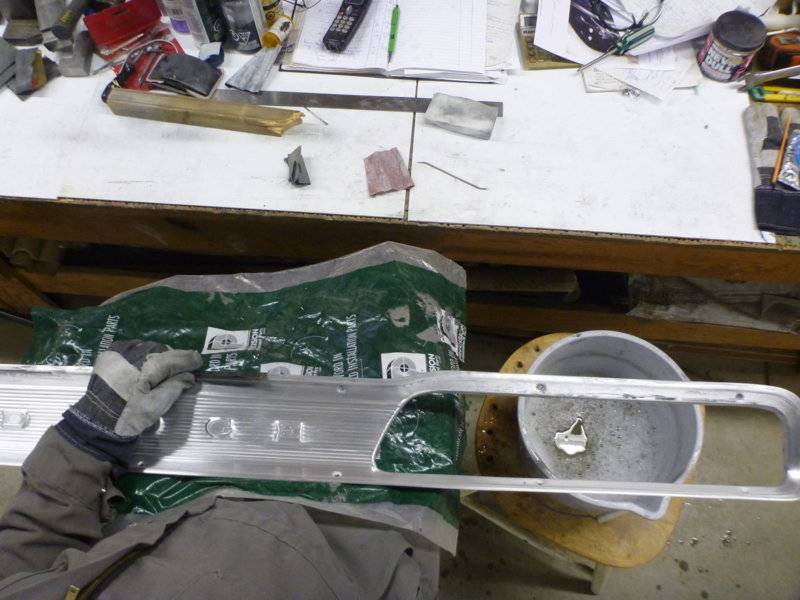

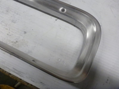

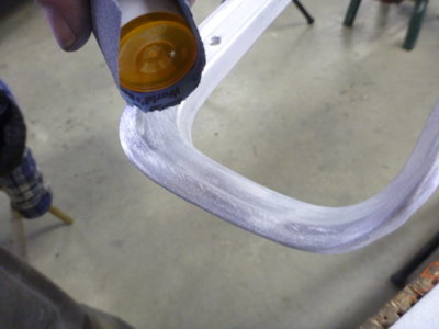

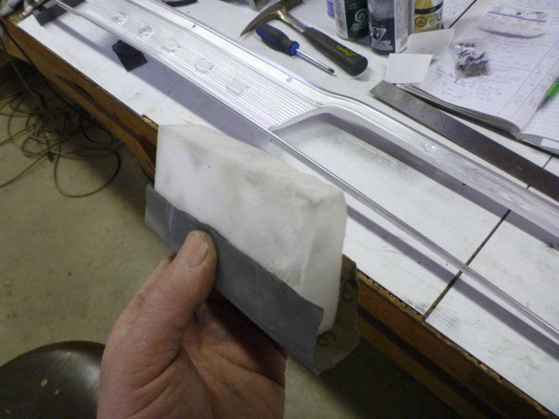

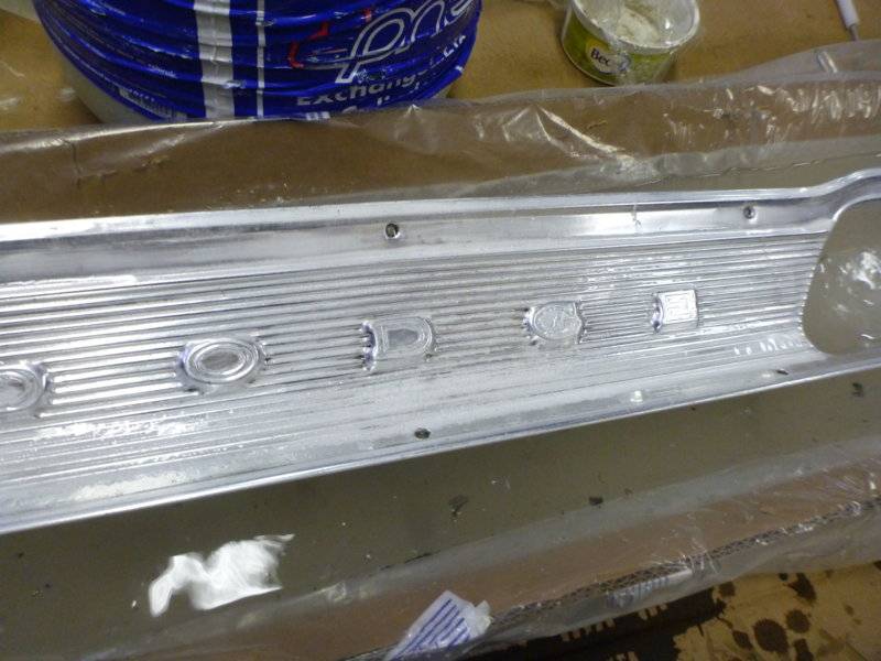

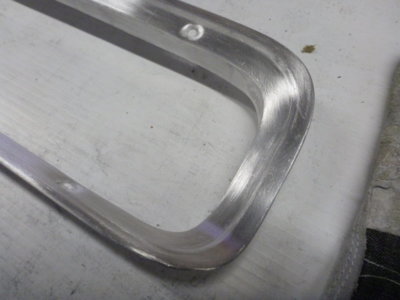

Mr Eraser foam block makes a good sanding block that will conform to the panel profiles.
Looks like I'm wasting my time starting with 150. Coarse #60 it is. Just gotta be careful with only .040 thickness to start with.

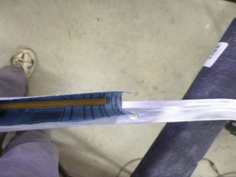

Dowel in the sandpaper for the tight concave areas.
Honing stone works nice to return the sharp edge from profiled to flat sections.

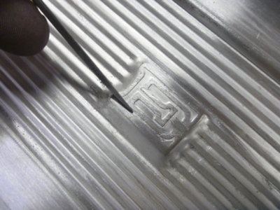

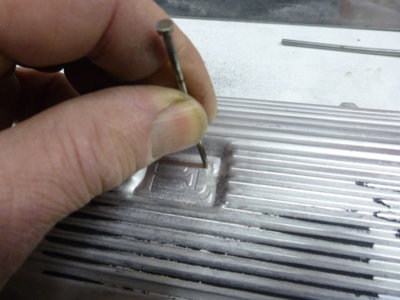

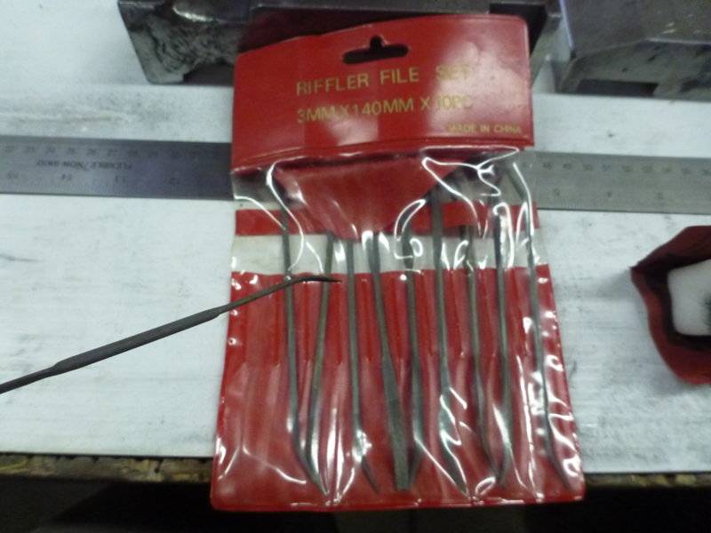

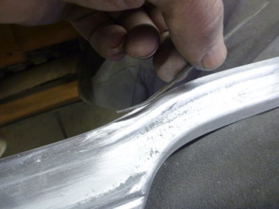

Riffler files. Don't start without a set!
The riffler file allows you to quickly remove any dents you've pushed up, while maintaining the profile.
Small file being used to correct the detent area (that gets black paint) in the "E". Almost absent on this tail piece and my OE barely had it there, so an original pressing issue that I am correcting.
Pill bottle has correct profile for the end sections concave area. Easy to hold and works well.
That $3000 US NOS tail panel is starting to look good right about now! Pull up a bar stool and make yourself comfy as you'll be doing this for a LONG time!

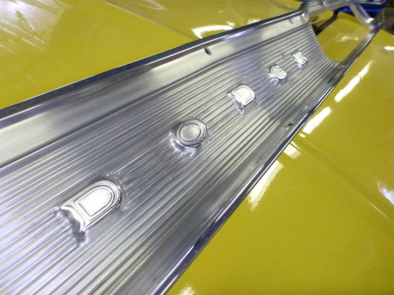

All pits removed, dents pushed up as I went and smooth. Todays work was 4 hours and 45 minutes of filing, minor dent clean up and sanding to this stage. 11 hours and 45 minutes to date on THIS tail panel for paint removal, dent removal, shape correction, anodize removal and todays work! Now you know why the NOS seller has a market at $3000 ! Still have to sand 320/400/800/1000/2000, cut and polish on the wheel, tape and paint...and try to wipe the DODGE clean without f'ng it up.

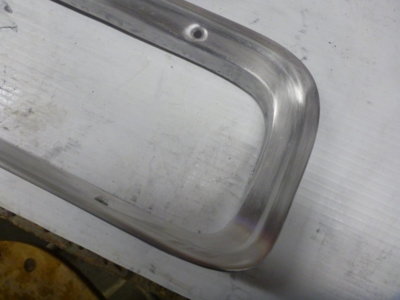

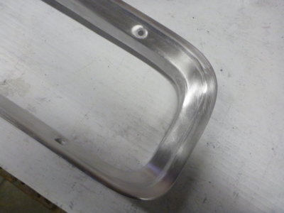

Realized the E was not only missing the lower indent, they also missed pressing part of the end tip. Upside down on a block of wood and using an old ejector pin that fit the exact width to tap in the shape.
About an hour and a half just spent on letters with the pin and riffler files. Sanding out pits on the letters = less indent for paint and some needed to be added, especially on the D's.
Sanded to 150 dry.
320 dry.
So it doesn't look like you pissed your pants wet sanding with 400 and up.
400 then 800 wet done, now onto 1000.
1000 and then 2000 wet done. (note outer profile is the "show" inner gets painted black)

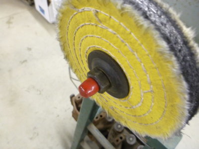

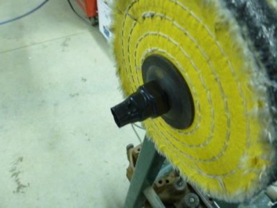

Someone elses restoration comments had me remember to do this! Rubber cap on threads of the polisher.
Then electrical tape. On the very first buff I hit it and DIDN'T have to start over with sanding!!

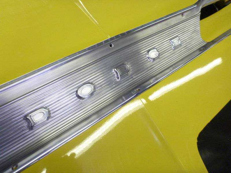

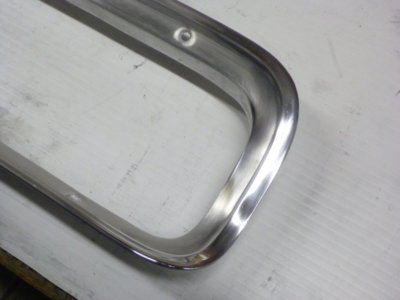

A quick 5 minute hit with green on the one wheel and rouge on the softer wheel just to see how it's going to come out. Still a few little pits, but better than it's EVER looked on my car. Today adds 5 more hours to this tail panel ! Still needs the remainder cut and polished and then taped and painted.
beerestoration2019 324.JPG beerestoration2019 328.JPG beerestoration2019 330.JPG beerestoration2019 331.JPG beerestoration2019 334.JPG beerestoration2019 336.JPG beerestoration2019 338.JPG beerestoration2019 339.JPG beerestoration2019 340.JPG beerestoration2019 347.JPG

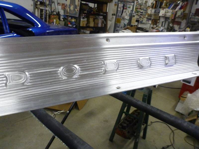

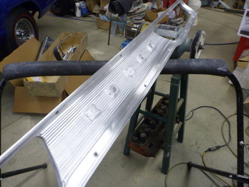

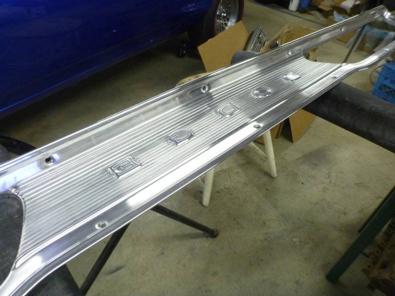

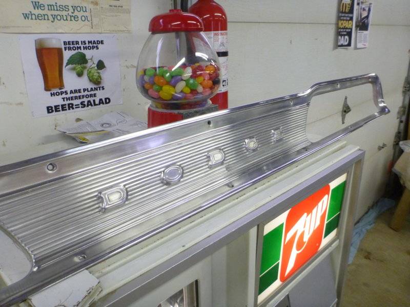

Tail panel power polished on the harder wheel with green compound.
You'll wanna sit down for this and hold on TIGHT. No way I could keep 6' running through the wheel standing up. Lost some gray hair through the day, all the black **** flying off the wheel is on my head!

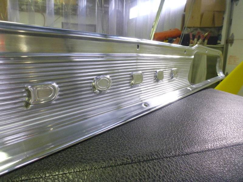

Power polished with Rouge on the softer wheel and then realized I had forgot to do the upper and lower corrugations as they don't get paint.

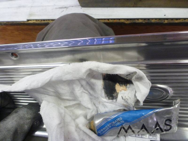

Hand polish with MAAS. You can see both the ceiling corrugations and the blue of my car reflecting.
Trying to get a good shot and almost impossible. Looks like chrome in person.
Another try for a good shot here, with Jellybean! Is it perfect.. No.. is it better than when it came down the Lynch Road assembly line.. probably.
Rubbed down with corn starch and then almost an hour to get it cleaned up, to no black on cloth, with wax and grease remover.

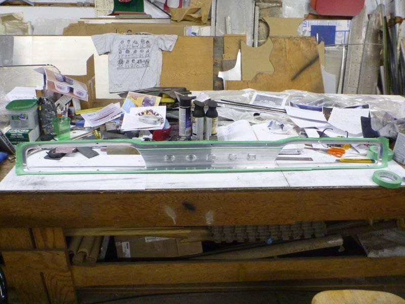

Everything taped off except the lower corrugation. Enough for today. Wish I could find the daily drinker with steady hands,from the paint line, that would have just wiped the details clean after being painted! Ma Mopar sure didn't tape them off... 21 hours - 45 minutes to this stage!

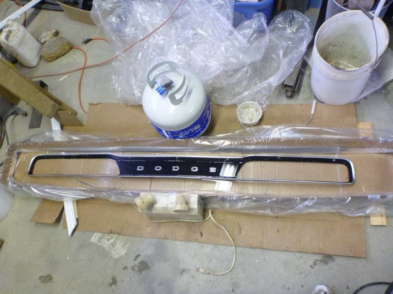

Paint tomorrow, I did a test swipe this afternoon on my OE tail panel about 2 hours after paint and worked well. Hopefully the real deal goes as good!
