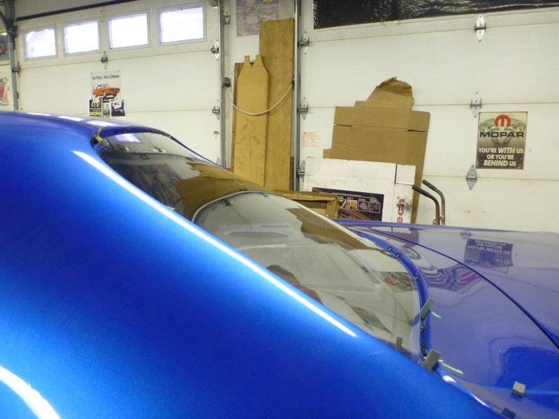

Front glass, other than three little defects trapped in between layers is exact. You'd see it went in fine if you read through my entire restoration thread. Don't jinx me on the door glass, it's sitting beside my work bench. Seemed to match the OE's curve and exact same thickness.

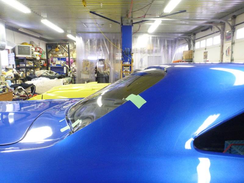

Cripes! It cannot be that difficult to produce a correctly shaped piece of glass. Maybe they did wind tunnel testing and the bubble shape is more aerodynamic lol.
Justin that picture doesn't have me convinced that the full OE concave is there either... I'll have to come and see it in person!! :thumbsup:
The OE glass I ended up installing...
I wish I took a picture of the original glass laid over it.......You know how particular I am.....So all the glass I got from ECS. I matched up to the original......There was no discrepancy with any of them.......I gave away the original glass to a friend who needed it for his bird but thats back in Texas......
Any part NOS, reproduction and even original if replaced....I compare, compare and compare.....Test fit etc....before the final fit....Pictures are hard to distinguish sometimes but the proof lied in a part that fits right and matched the original part....
After the glass was in and I got deep in my thread I kicked myself for not doing that.......
