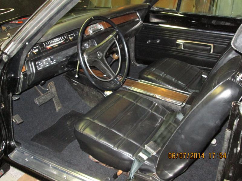

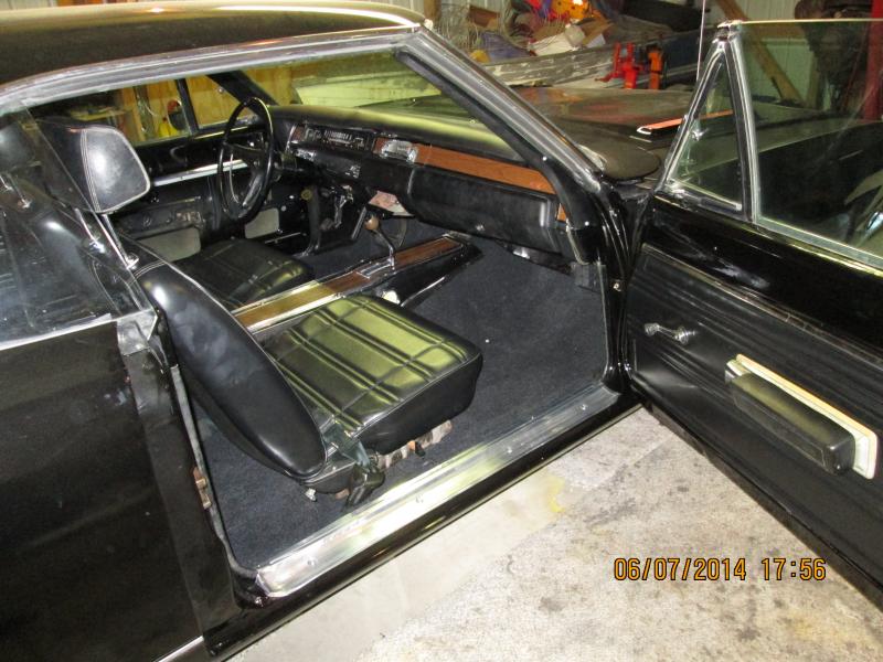

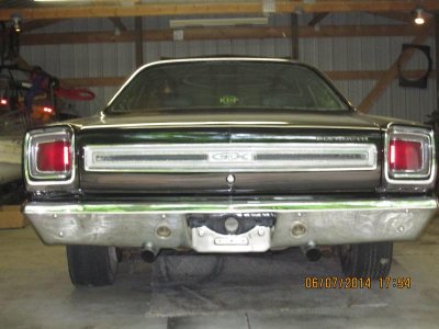

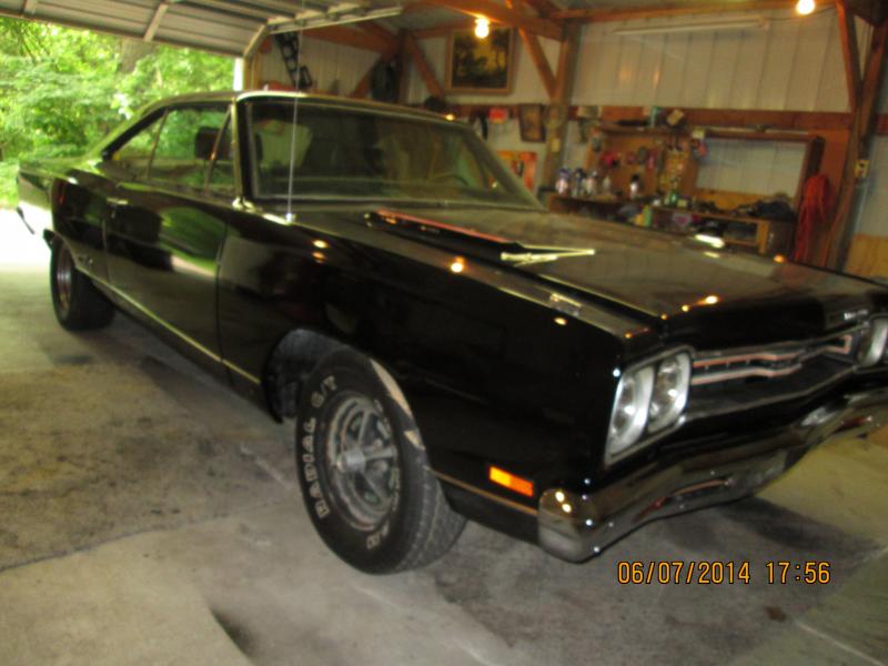

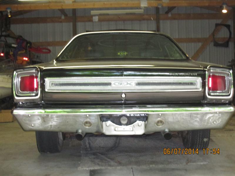

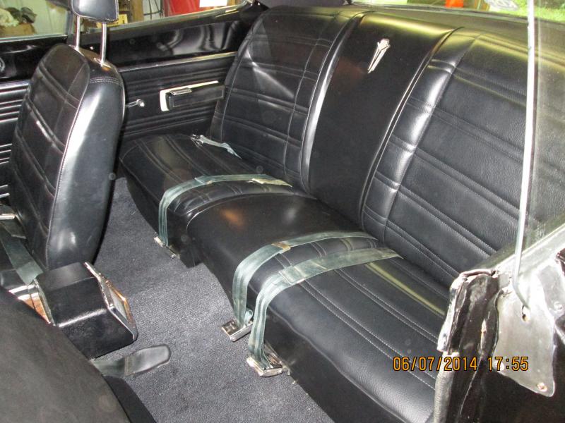

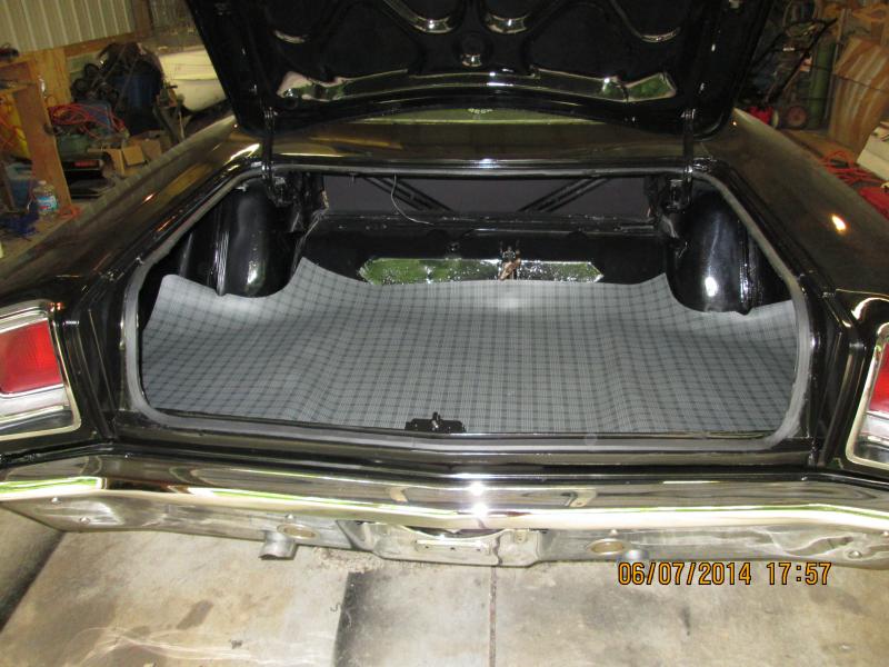

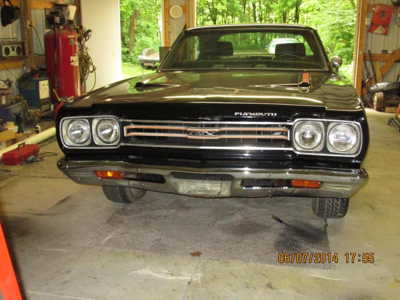

Seats in yesterday. Using a solder iron works nifty to burn bolt holes. I first used a 10d nail to go thru the bolt holes from underneath the car. Then used solder iron were nail stuck thru the carpet. Makes a quick mess free hole. No need to cut an "x" first.

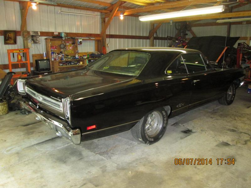

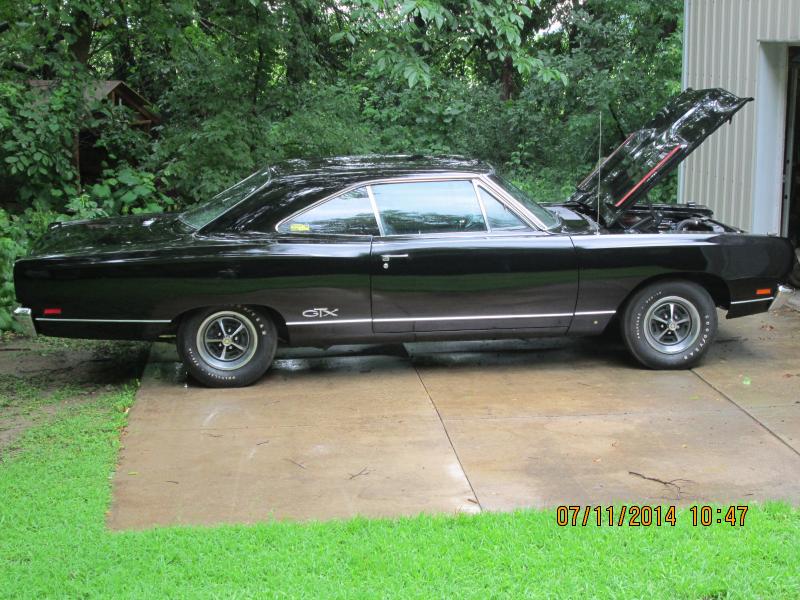

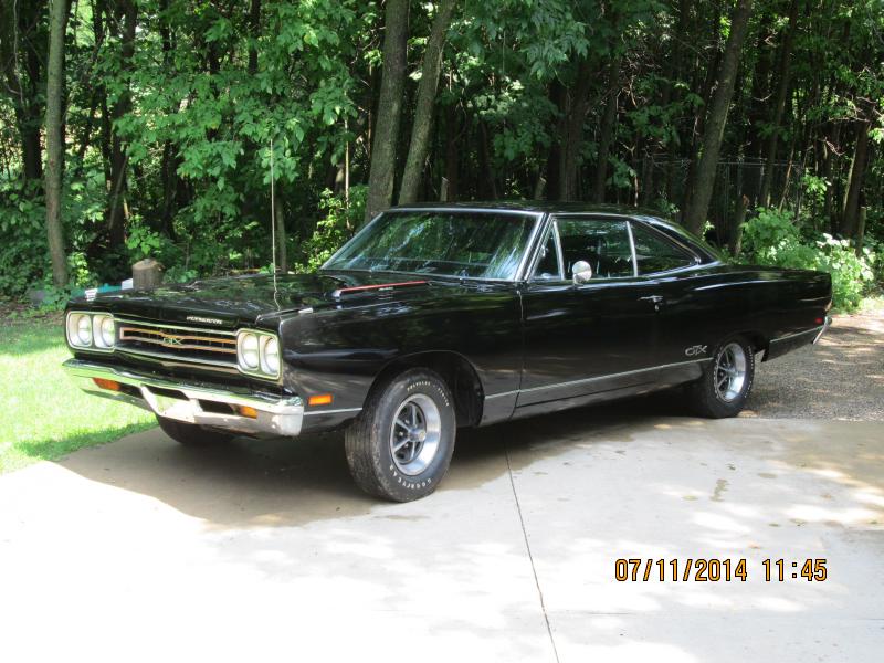

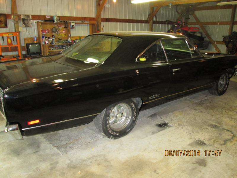

Remaining: side trim pieces to be mounted on the doors..I ordered some new real trim clips that mount with a nut inside the doors..before installing the door trim...The plastic clips that came with the trim set is absolute junk! Get the rest of the trim on the car and then the bumpers. Then, new rubber brake lines, and good to go..
