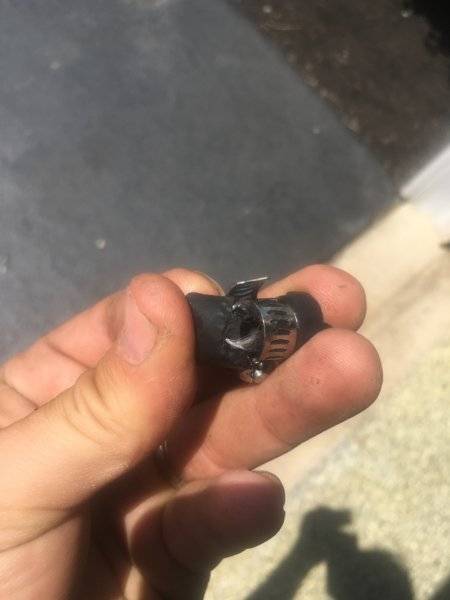

Dealt with 2 different fuel leaks. The first was over tightening of the fuel clamp which cut the line. The second leak was on the fuel tank itself. Original tank.... the vent line tit had broken its weld at some point and I didn’t catch it apparently. Since it’s st the top of the tank, not much fuel came out. Used some gas tank repair epoxy and let it sit for an hour and it seems to be fine.
