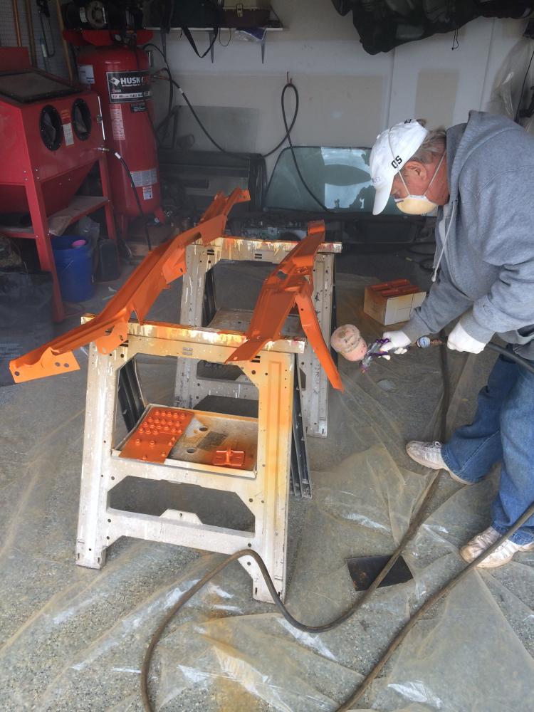

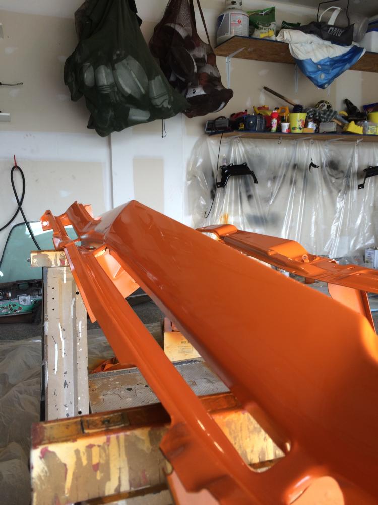

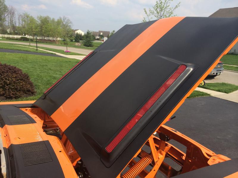

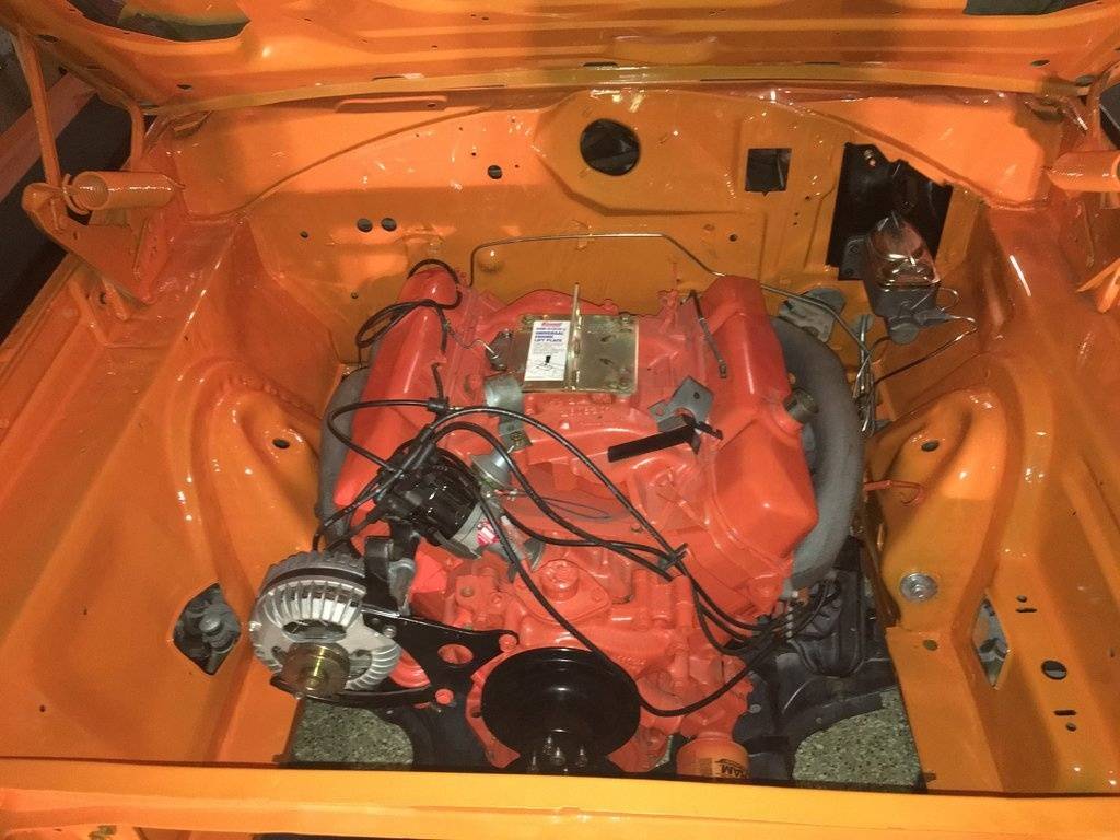

Didn't like it....so we re-shot it. That seems to be a common theme with the product I got from the body shop. Next week, we're going to re-shoot the engine bay.
My father is an incredible painter. I wish I would have known....I would have let him spray the whole car. He offered to paint it for me when I first got it, but, sadly, I didn't trust him to give me the product I was looking for. He's been painting for 45 years....not cars though. He painted high dollar homes....mostly airless guns. The dude has mad skills. Being forced into this situation I have a new found respect for him. Can't thank him enough.

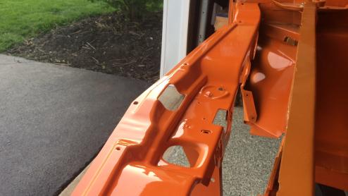

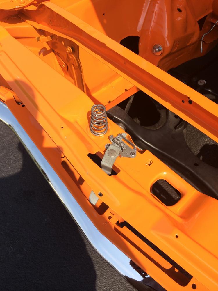

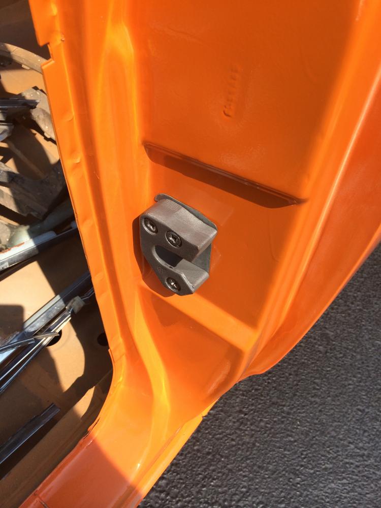

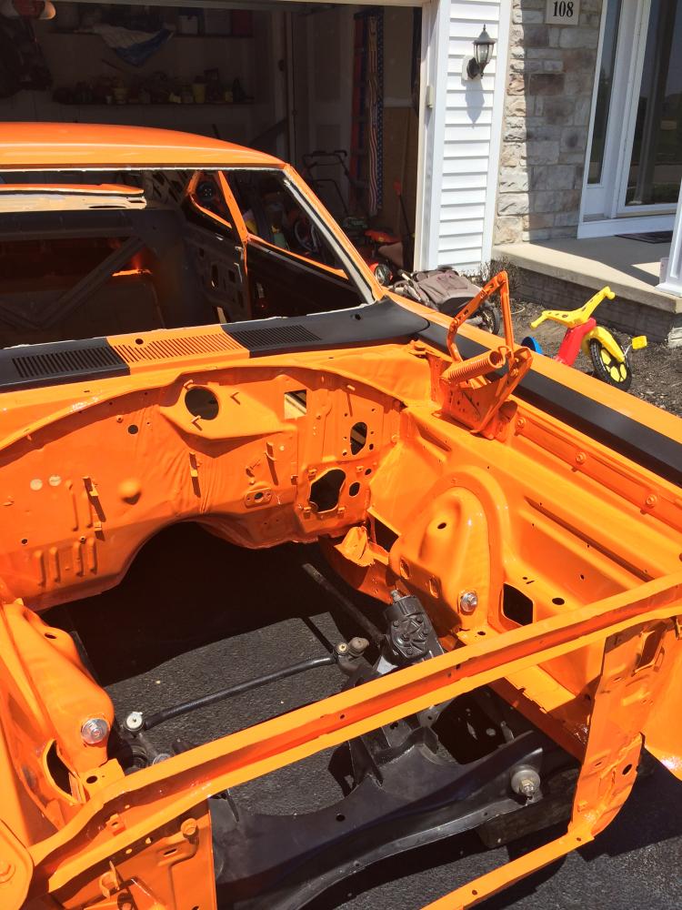

Radiator support on the right was shot by the "pro"....hood latch was done by my father. THe exterior body panels are ok....he just half assed all the cut in work. We're making it right.

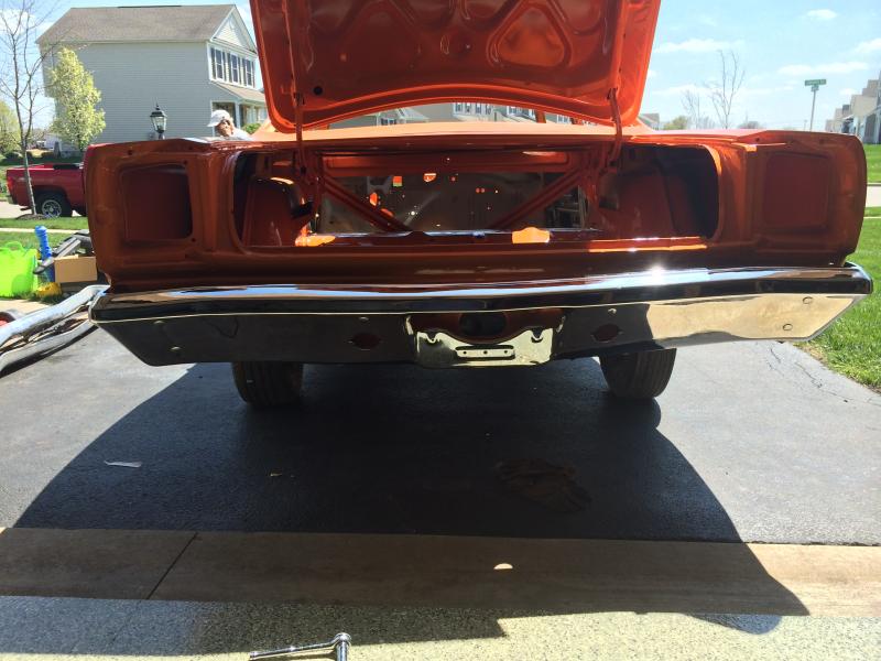

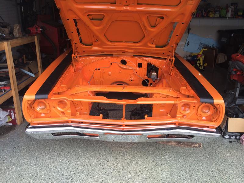

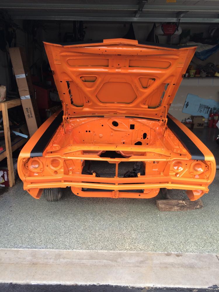

Engine bay re-painted. Stripe lines cleaned up. Front valance, hood and hood latch support back on. Test fitted and mounted rear bumper.

Thanks! We got it fixed though, pretty determined. Still working thru the hood alignment issues.

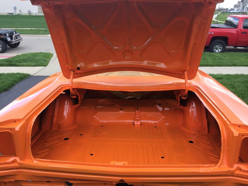

Last couple of days we've mounted the front bumper, master cylinder, front brake lines, all latches, hood release, painted and mounted hood insert grills and started polishing stainless steel. I'll get some updated pics soon.
Here are some pics...

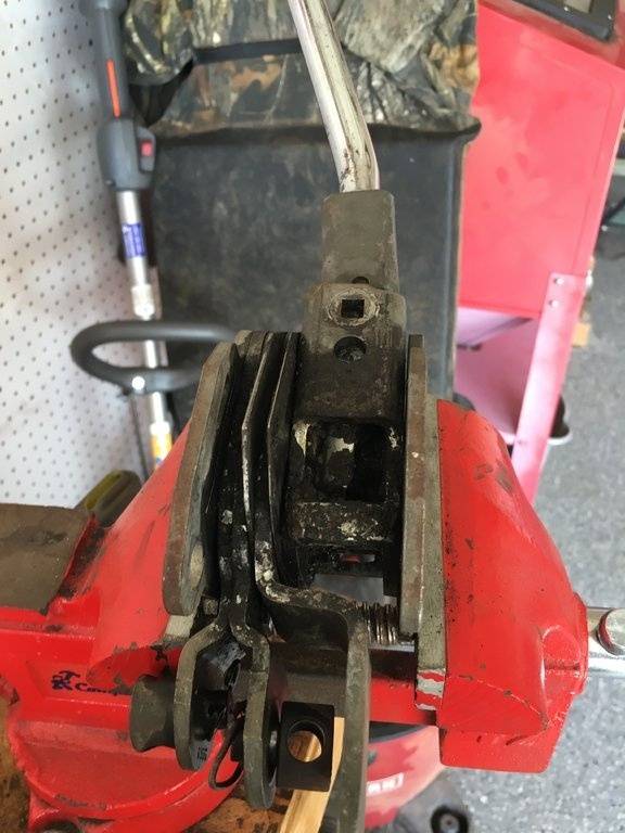

Did you know that there are roller bearings on the clutch pedal around the pivot shaft? I didn't....
So, I was tearing down my pedal assembly to get ready for painting today. Lost a bunch of roller bearings. Now what? Are those replaceable?
Found the clutch pedal bearings at Rock auto. Good deal!

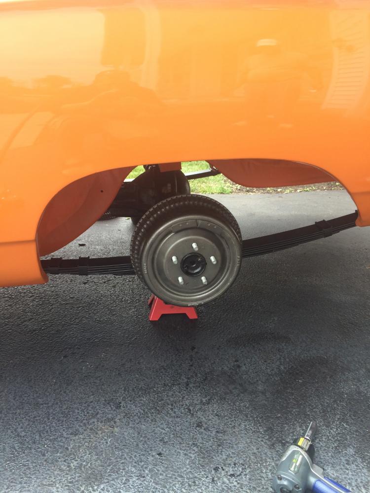

Had the last 3 days off....and feel like I accomplished nothing.

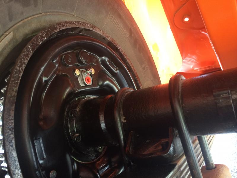

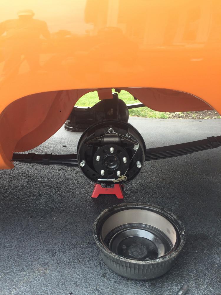

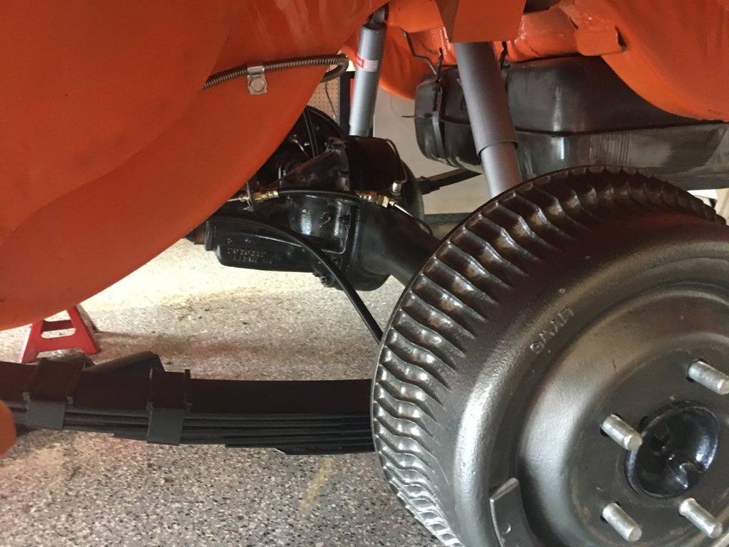

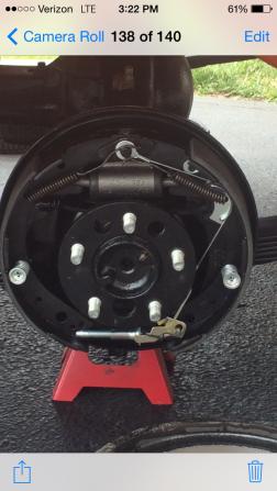

Monday, went to Napa to order all the rear brake parts. Went home to add some lighting in the garage....sick of not being able to see anything. Went back to Napa to pick up the parts around 3:30. Didn't even open the packages...had to pick up kids from school and blah blah blah.

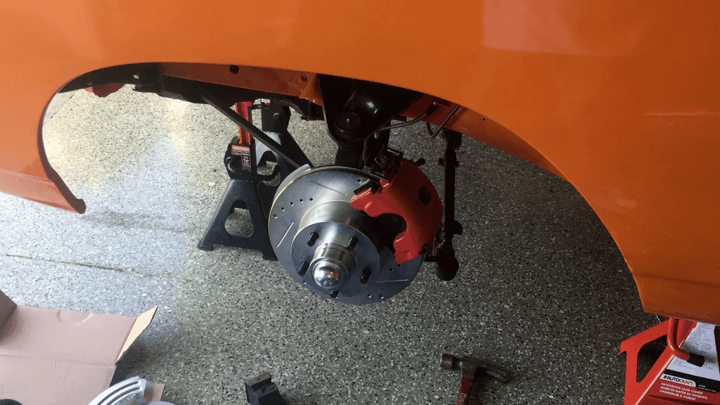

Tuesday, pulled off the drums and backing plates. Found overspray on the leaf springs and 8 3/4. Dad repainted those while I cleaned and painted brake parts. Open the boxes around 11:30 AM to start assembly on the brakes....only to find they were 10 inch shoes. Back to Napa to re-order. Get parts Tuesday afternoon on the 3:30 delivery. Back to the house to start over again. Wheel cylinder threads didn't fit the bolts that I took off the car. Back to the hardware store for new bolts. Back home and realized the self adjuster cables were for 10 inch also...ugh. Disassemble everything, backing plates back on....car back in the garage. Back to Napa to order the correct self adjusting cable.
Wednesday, pick up correct parts at 10 am. Finally, started assembly....only to realize the hardware kits weren't correct either. The self adjuster spring was the short one (that attaches to the adjuster) and not the longer one (Primary to secondary shoe) required. I left everything assembled this time....I can add that this weekend.
So, still waiting on e-brake cable and self adjuster springs.

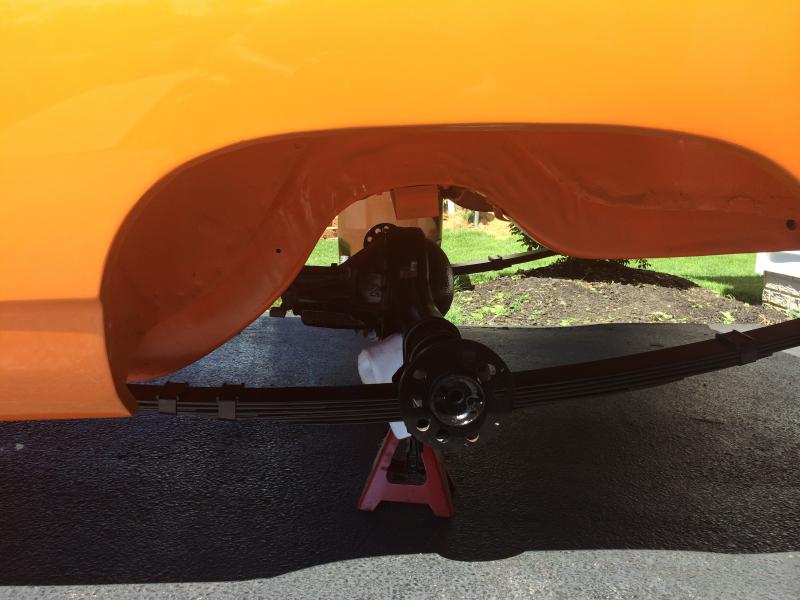

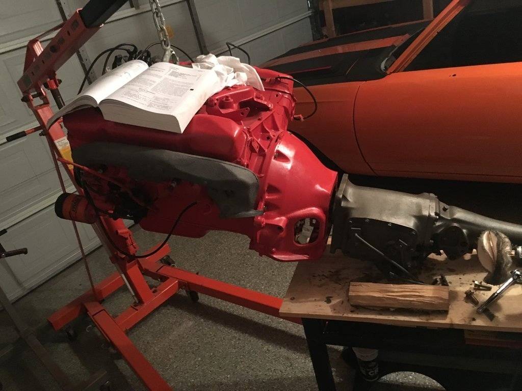

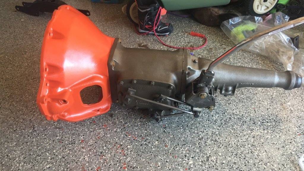

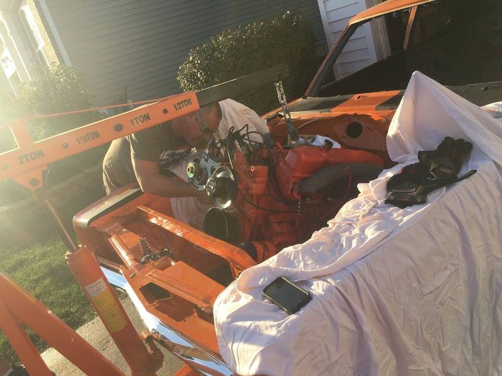

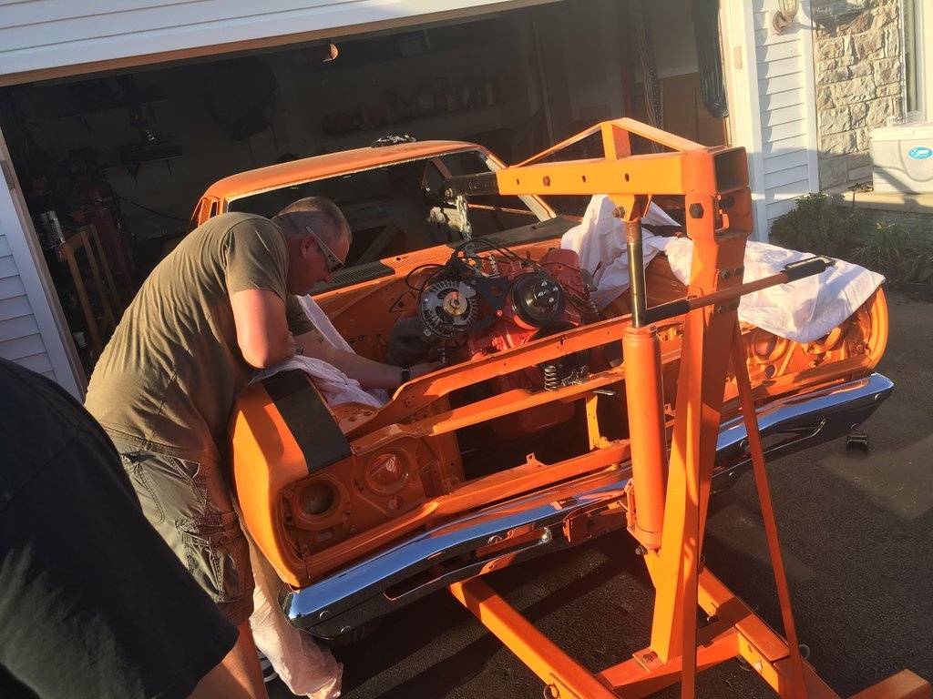

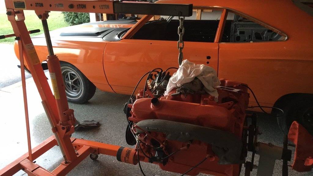

So....I've been a little busy. Can't believe it's been over a year since I've last posted. I try to check back in a bit more often.
IMG_1347.JPG IMG_1348.JPG IMG_1351.JPG IMG_1352.JPG IMG_1360.JPG IMG_1364.JPG IMG_1371.JPG IMG_1372.JPG IMG_1374.JPG IMG_1657.JPG
Nice progress - I bet you are happy about having the drive train back in the car! Thanks for checking back in with us.
