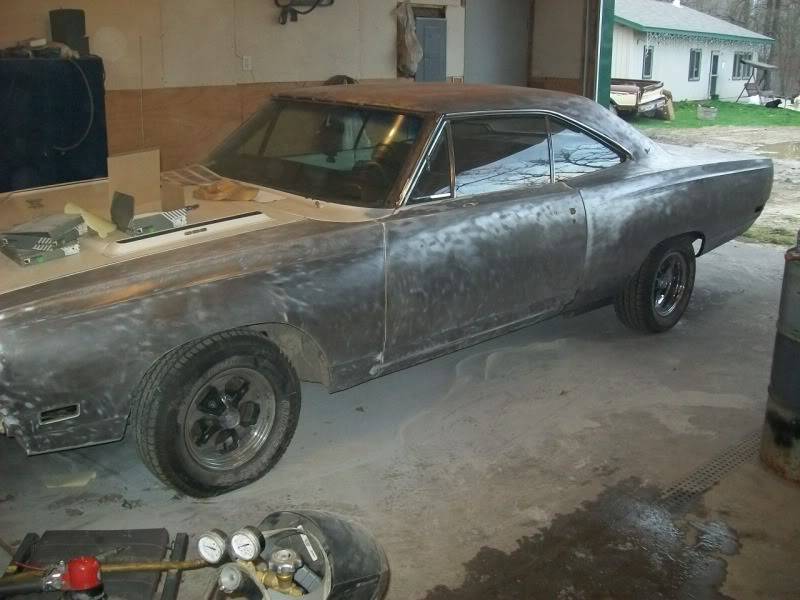

I think I just used about a 1/4" drill bit for the trunk pan holes.

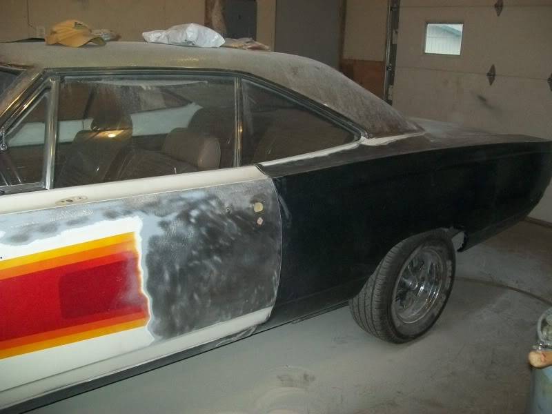

Just a little sanding tonight, getting down to bare metal.

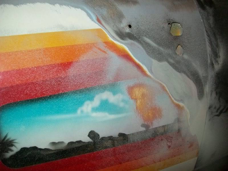

bondo excavation.
The dent in this door must have had a half a gallon of bondo in it, there is no sign of thenm even trying to pull the dent. I think I'll get by with a little less filler when I redo it.

Yikes......Lotza mud.

I just got a PM reply to my hunt for a windshield gasket. (moparsteve636)
I could have a new gasket in my hands as soon as the end of May.
That's really good news that's going to breathe some life back into this project. I was actually slowing the pace a bit because I was so gloom & doom over this gasket and really wanting to pull the old one for propper cleaning/prep of the glas tray and a nice new leak proof install.
Time to pick up the pace a little bit again.

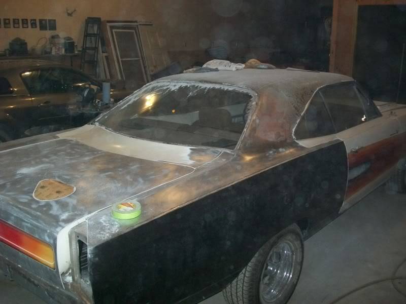

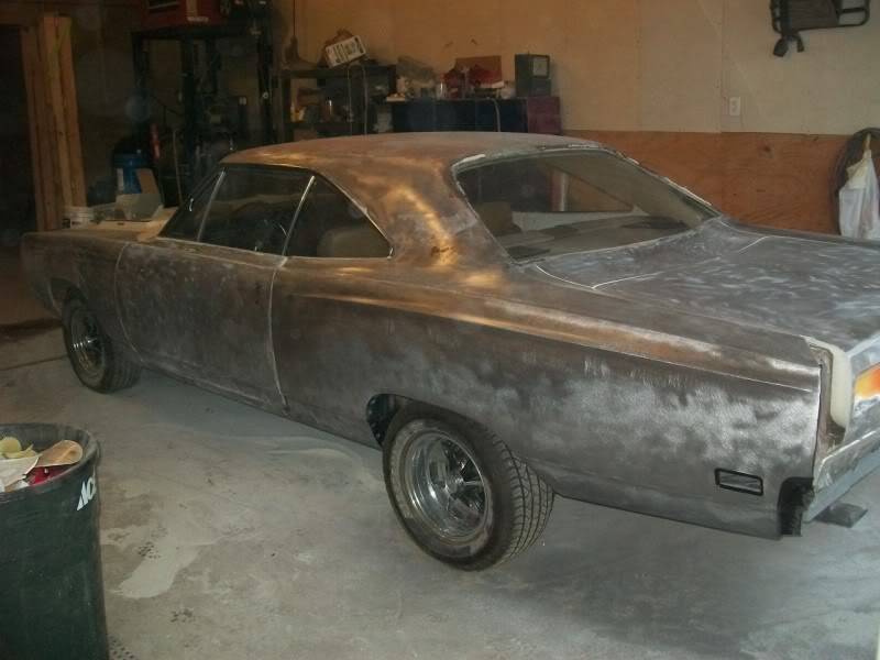

Pert neer half way sanded.
Mopar steve's talk of a possible windshield gasket by the end of the month inspired a pretty good heap of work tonight.
That is awesome news, I need me 1 or 2 of those myself. Car looks very bland compared to last week! you better get some paint on that old hippy!
First pass at shredding all the old paint and fillers off this side. I'll go around the entire car again with 80 grit to "clean" things further.
But it feels really good seeing the slate partially wiped clean so I can take a fresh run at the body work and paint.
A lot of things have changed in the past 35 years when this car was last refinished. Better products are available today and more importantly the car is 3 1/2 decades older and that much more desireable. So the expectations are up quite a lot as far as body & paint.
unfortunately I uncovered more problems with the rocker than I thought I was going to find.
I can patch it, but I might have replaced the rocker entirely if I had known sooner. Rookie mistake by not exploring the rocker further before putting the quarter skin on.
But it's ok, it will be fixed correctly when I'm done.
