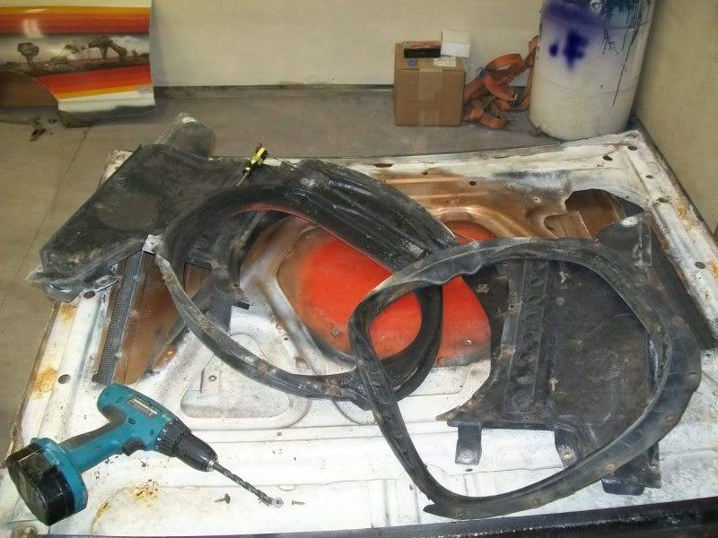

So, this is what it looks like when you take an air grabber hood apart.

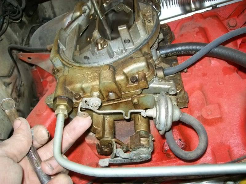

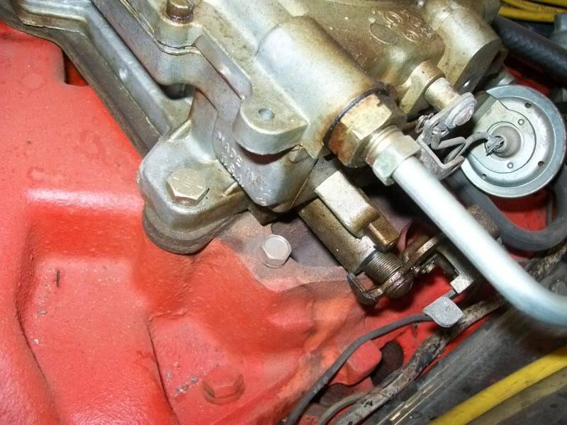

Someone please tell me what I am missing in the way of a choke actuator here...

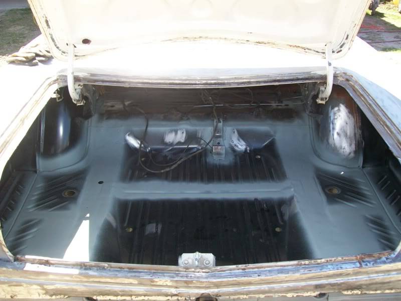

trunk getting close to primer and seam sealer.
I guess I don't. I can try to take some though.

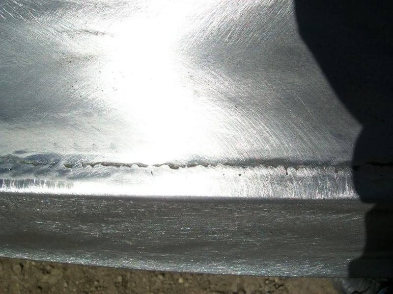

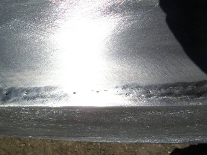

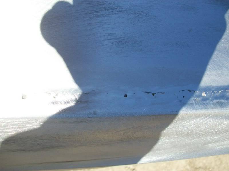

Being a eventual connection of a series of tack welds, it aint pretty lol!!
pretty sure I'm missing something like this for my choke... would explain the fits i have warming this car up to idle.

Do you have any close up pics of the finish weld on the 1/4 skins?
I'll try to get a picture of that today. Like I said, as far as a weld goes, not pretty but it's the best I can do without warping things all to hell lol!!

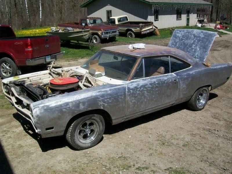

Sunny day! I get to work on the car outside today! Wooo!!

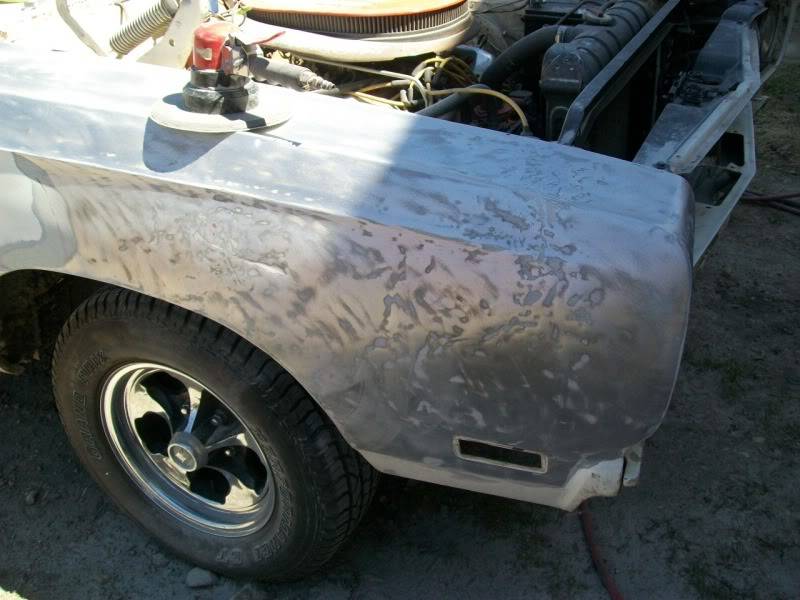

Dents, dents, dents.

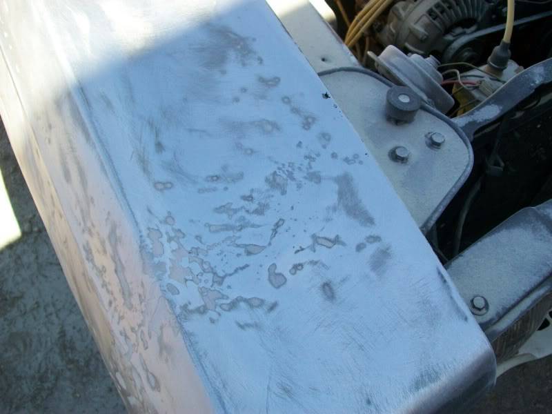

RH fender is junk, but I'll have to try and save it because I can't fork out $700 for a new one.
I've been hogging bondo off this smashed and hammer formed fender for an hour & a half now... makes me non happy.
But it is a very nice day, first we've had so far this year, The wife got on the riding mower and started the first mowing for the year today. (that's how late our spring is this year)

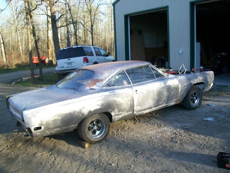

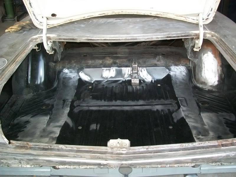

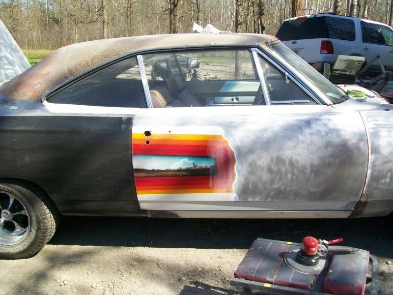

The car is running again, I prepped and epoxy primed the underside of the trunk and hung the fuel tank under the car again. So, I started the car and drove it outside of the garage for today's work, which did make me pretty happy :)
Did some epoxy priming inside the trunk too.
Oh, some close up pics of my ugly topside quarter skin welds for superfreak.
Ok, I'm heading back outside for more bondo excavation on that fender. I had to come inside and grab a book and see what a new one cost before I continued on it. $700 bucks... yeah I'll work with it, see what I can do.
I'm trying like hell to get the rest of the car sanded today.

Man, for about 140 bucks I could strip that baby down in about 50 minutes inside and outside and behind the headlight areas that you would never ever get to!

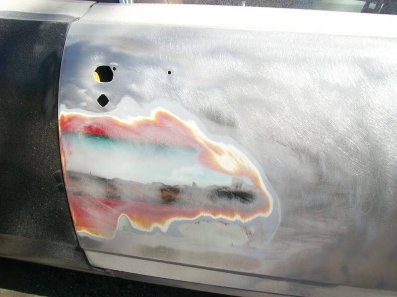

The door and rocker made up for the front fender, really nice door & rocker on this side.
My god Dave.........That's nutz how many dents/dings are in that poor car. Someone drive that through a field full of claymore's? Your Martin Hammer are gonna be attached at the hip.. Looking real Good! Moving right along.........
I sure am glad to have the bulk of the paint/primers/fillers off the car. It's nearing that 'clean slate" status that I look forward to.
