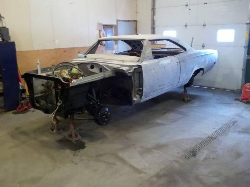

Nasty day under a 44 yr old plymouth. Tiny wire wheel on a 90 degree angle die grinder. Various scrapers and wire brushes....
She pretty spiffy under there now, springs, axle, All that under the car junk. Primed with epoxy, then a shot of satin black urethane.

It's snowing so I can't blast the last fender... dammit.
