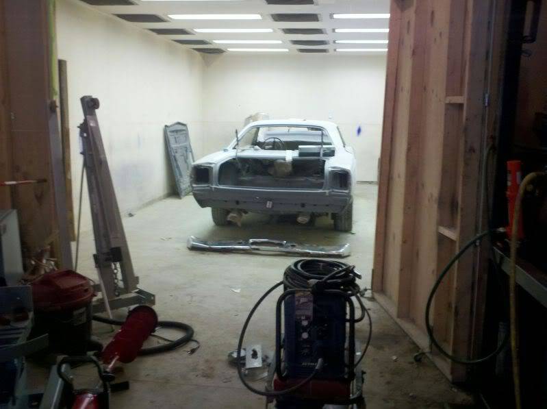

1969 Road Runner facelift
It is back in the booth.

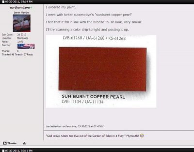

Dave, dupont code shows AY2ET7 Bronze metalic. checked the link that will put up and looked under plymouth and their code said saddle bronze. Hope you find the right color/code.
Good news, I found my papers for the base coat we matched to my factory paint. A while back I took my driver's door over to a friend's colision repair shop and we used his metallic color selector cards to find the BEST match possible in outdoor lighting. We matched to the paint that was under the factory door weatherstripping, it was nicely preserved, no sun fade.
I'm really happy I didn't lose that color code lol!
Look over at my Satellite thread Dave, the T5 color I used there is a blend, not a true T5, but a little darker and with more metallic flake in it. If you like that code, I will post the paint code for you, when I get back to TX.
Donny, I LOVE that color you came up with. But my tag reads T7, so I'm chasing a little different critter. The color we picked out is a very nice modern likeness of T7 in a base clear formula.

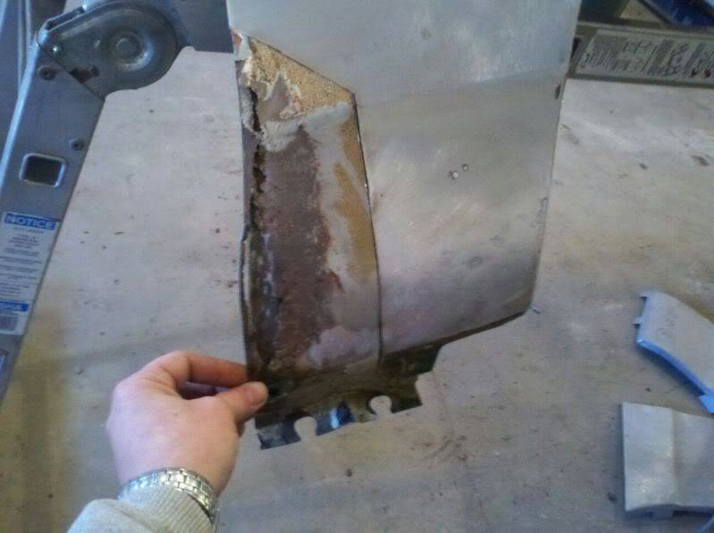

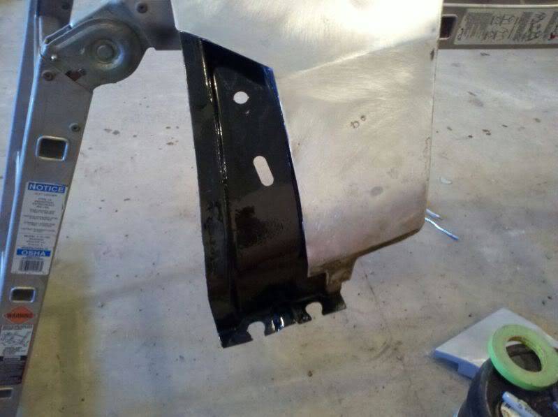

Time to fix these front fenders and get them back on the car.

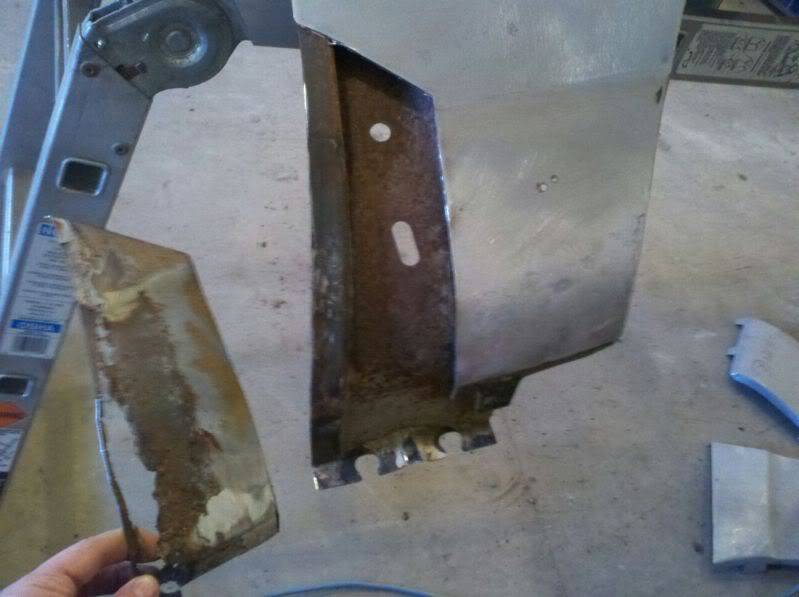

Out with the badness.

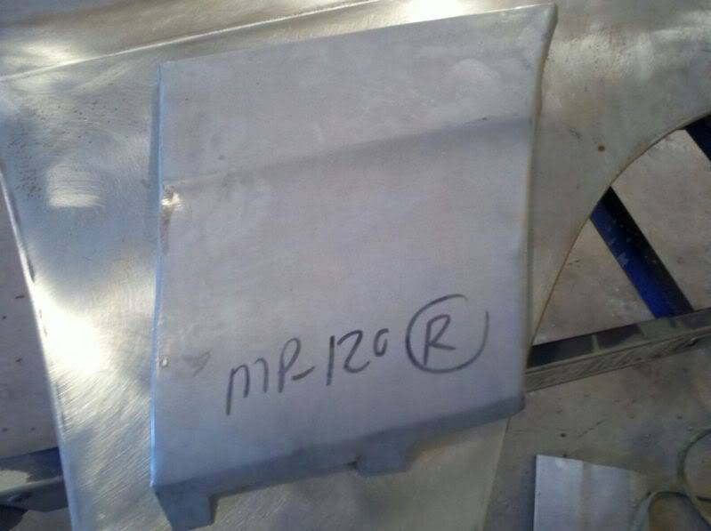

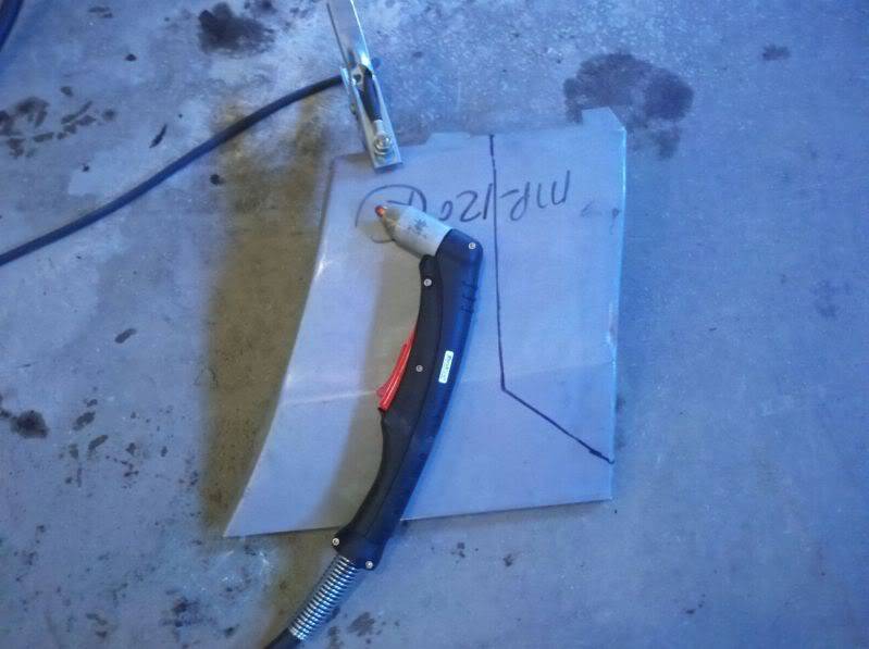

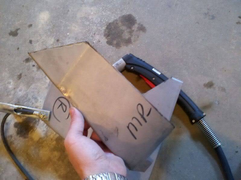

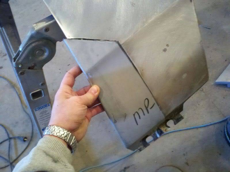

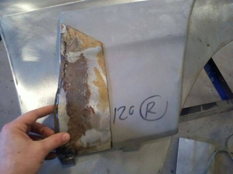

Now to cut a patch from this formed repair panel.
Using the carefully removed badness as a template.

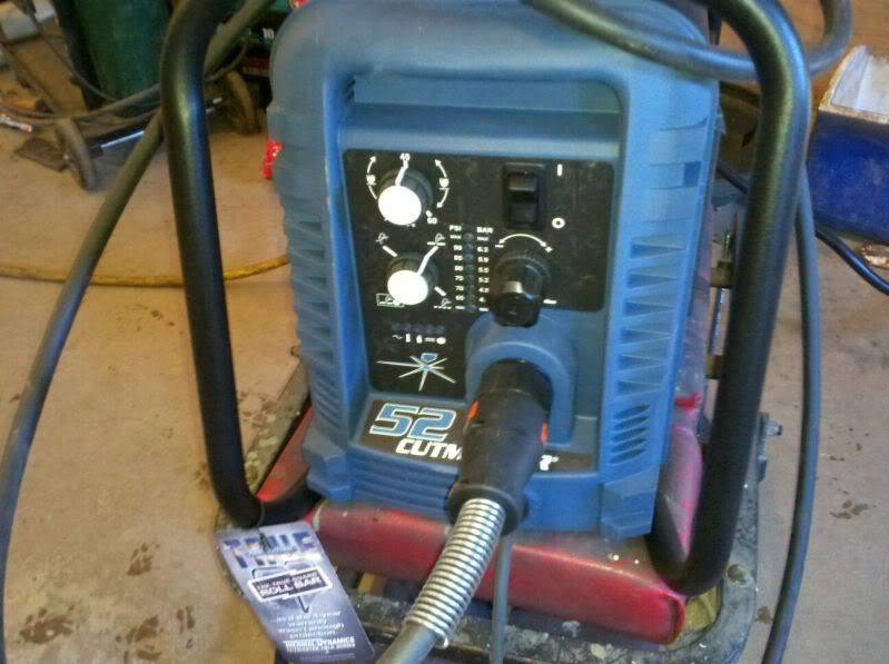

time to try the new plasma cutter.

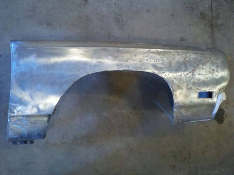

I cut it a bit big so I could fine tune the edges with the grinder.

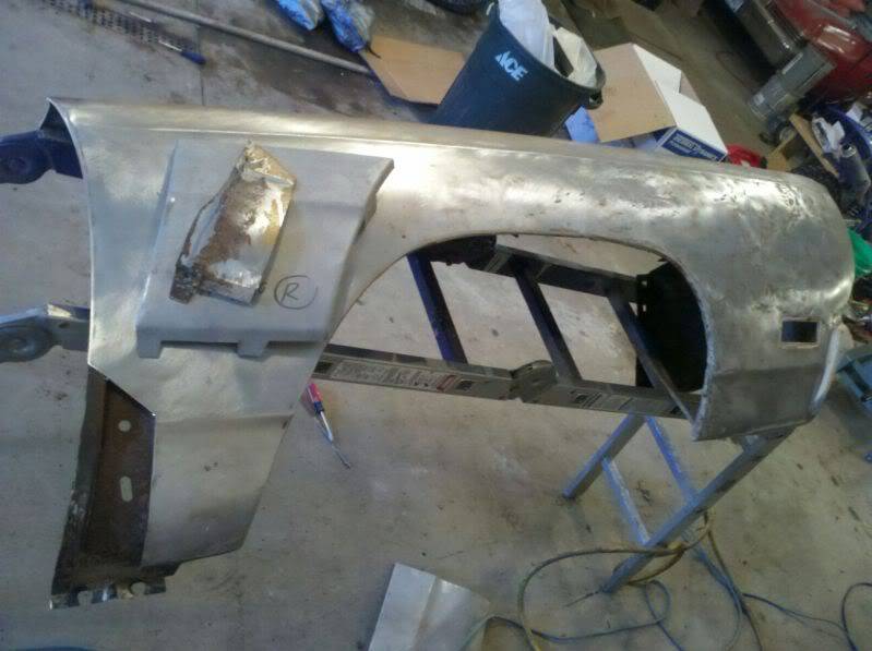

Sealed the under structure before fitting the new piece.

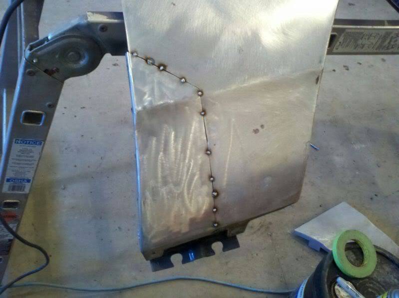

Tacked.

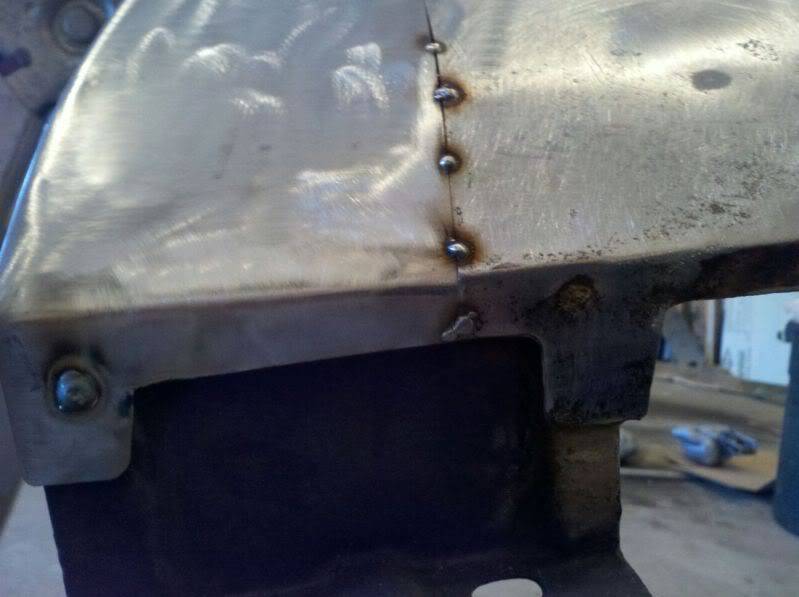

After welding the patch, rolling the rear edge around and plug welding and also welding shut about 12 little screw holes on the wheel opening lip from where previous owners had installed fender moldings from a sport satellite and some mud flaps.

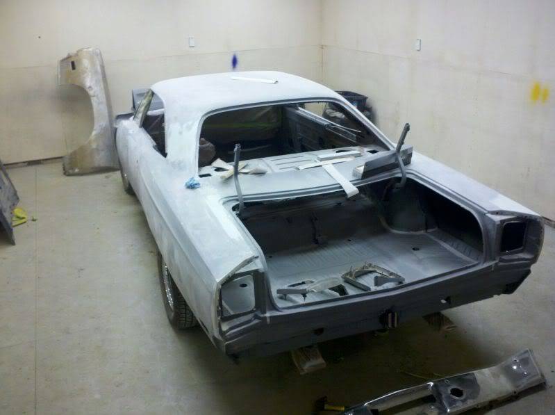

Well I think I'm going to get dressed and do a little Easter morning roadrunner work. I'd like to blow some epoxy on those fenders and hang em back on the car.
Really itching to get some color on this car.
