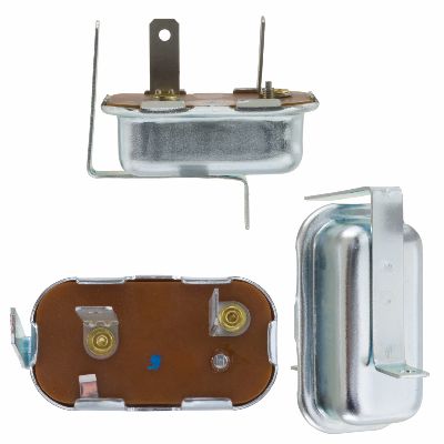

I got all my 3/8" sending unit, straps J-bolts & new 19gal fuel tank from, Mancini Racing... the gauge problem could be the dark blue wire going to the sending unit, from the fuel gauge or even a ground from the sending unit to the body {they're usually on the steel fuel line, with a click on strap/ground grounding the sending unit to the fuel line, thru the body}, you can add a ground wire too {especially if your not using a steel fuel line any longer}, even the cluster ground {or lack of good ground} or even the Voltage Limiter {it drops the voltage from 12vt to 5vt, see below} on the back of the gauge cluster, they are known to cause issues, with the printed circuits/type gauge clusters.... the one shown below is for a 68 but I think they are the same as the 69's.... I got mine from www.MegaPartsUSA.com , if I remember correctly, I think there are digital voltage limiters available now too, I don't remember where I saw them thou....
I had researched all of that stuff and I had been messing around with grounds on the tank and up at ins panel, also tried new limiter like you show here. At the time I had collected individual elect parts to make a new style limiter following a tech article I had found. But since then I believe someone has started offering a digital direct replacement like you mentioned. I also need a device for my factory tach to read correctly since I have elect ign.

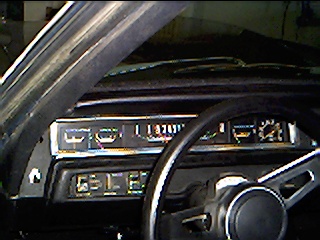

I have a 68 RR RM23 I have CEI electronic ignition, with a Chrome box/ECU & my little stock square in dash tach on the far right side, works just fine... soon to be a custom gauge panel
