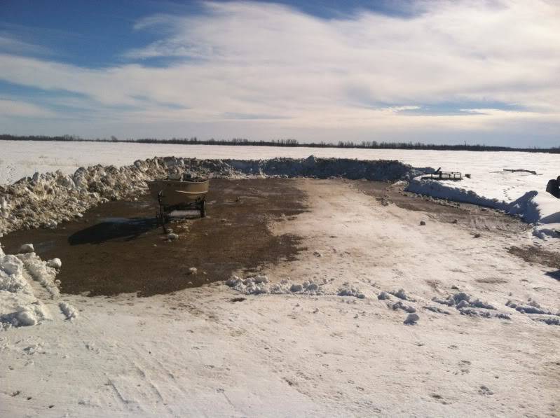

old googly eyes did some heavy snow bashing to clear off my future shop site.
Get that ground thawed out so I can start building.
I have roughly a 50' by 100' spot cleared off here, it sure doesn't look like it in this picture though. I need to clear a bit more off the right side of the photo. But that's basically the spot for the new shop.

How big is the new shop going to be?
Tentative plans are for 50x80, 14' ceiling.
I wouldn't doubt that frost estimate or that thaw timeline. Doing everything I can to speed that up (short of heat blankets) and I'm not opposed to such measures. lol.

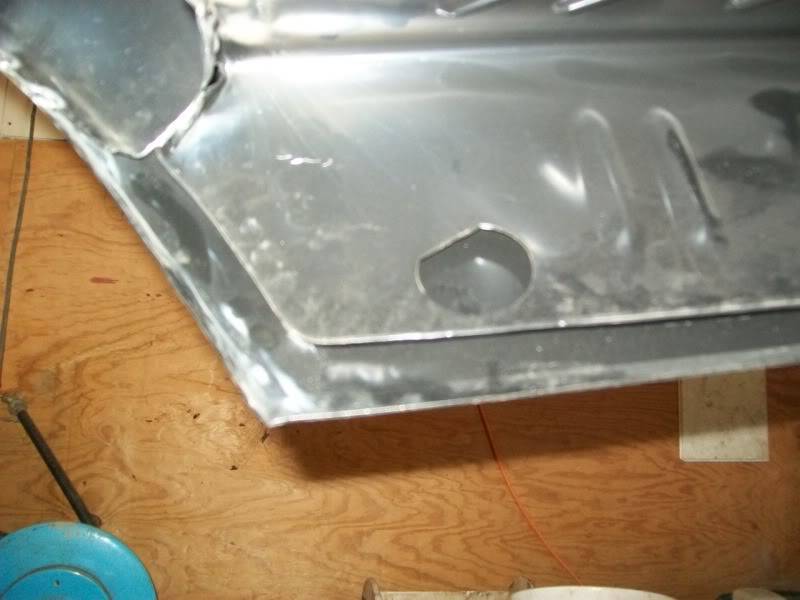

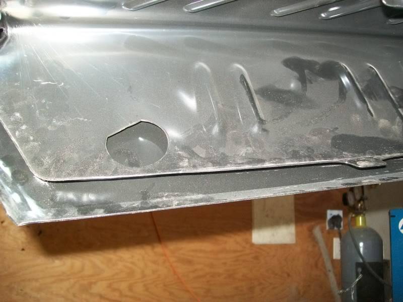

Here's something I'm not too happy with, the AMD trunk extensions don't come even close to reaching the wheel opening lip or the bottom edge of the quarter.
These 2 tabs could reach but that's all I got for now.
How did you solved this problem, Dave? I feel like this is a common deal with aftermarket parts.
I bent the lower trunk ext lip down to reach the bottom of the quarter So I could get weld contact approximately every 3".
it was frustrating and I wish I would have mocked it all up better so I could have caught it before the piece was welded in. In the end I was satisfied with this area but I will be mocking things up for fit better in the future. I had no such problems with trunk floor extensions on a 68 coronet I did a few years ago, different brand.
