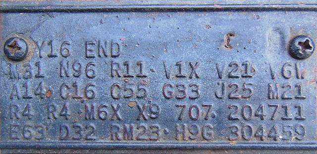

So the '69 RR i just picked up is an A14 spring special also. Mine is R4, R4, Black Vinyl Top, White longitudinal (pin) stripes, Road Wheels?
Unfortunately it is now blue, no vinyl top, mag wheels, junk fiberglass hood instead of air grabber and 4 spd. instead of console automatic. But it's straight!
What are the road wheels? and the black hood paint, is that the whole hood or the stripes on the hood?

Thanks CoronetRTguy. Deciphering the fender tag and broadcst sheet is a real experience. Here is the fender tag:

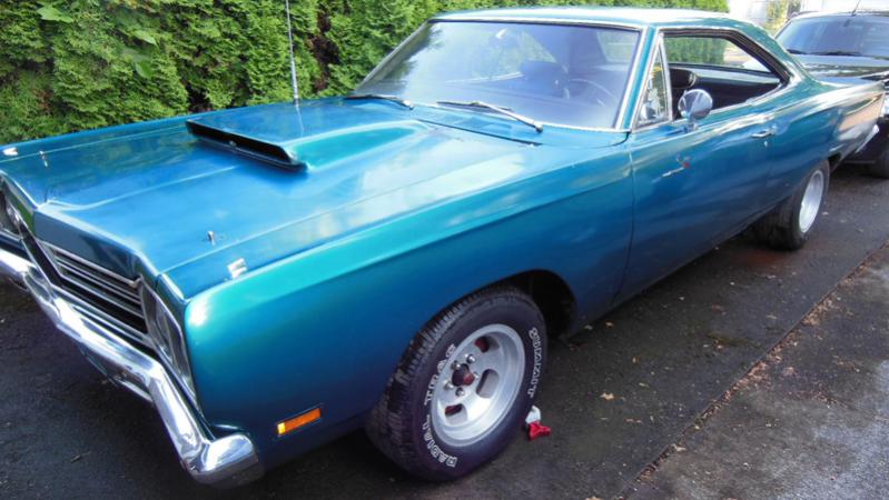

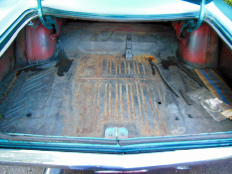

I'm really interested in getting back to the R4 red with the black vinyl top. It's one of my favorite color combos. I also found out yesterday that the engine is actually a 65' 383. Another challenge will be to find the airgrabber hood. This is how it looks currently:

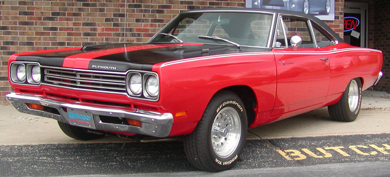

This is what it is supposed to look like except with the Magnum 500 wheels:
I don't know about the white stripes, and I don't think the black hood stripes go with the black top. I think it would look good with Chrysler cop wheels in body color and a small cap too.

Nice looking bird. Where in SW Washington are you located? I'm just down I5 in Tigard,Or.
You mentioned you were looking for an air grabber hood for it, where have you been looking?
I've seen a couple recently.
goose69, I'm in Longview, about 45 miles N. of Portland. I've only been looking on CL and parts places for the hood so far. I'd be happy if I could find a complete hood (w/air grabber parts) locally (within 50-100 miles) for a decent price. The fiberglass hood is absolute junk but will keep the rain out of the carb. I need to email Wildcat and see if they have anything.
