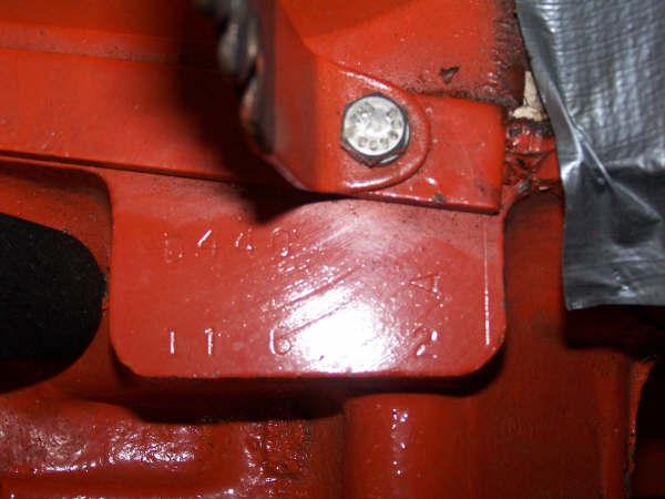

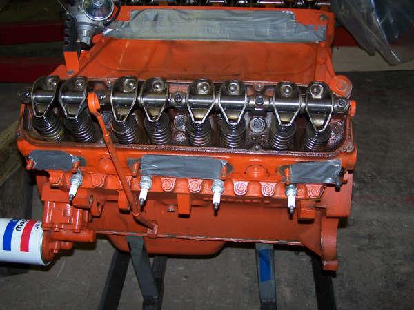

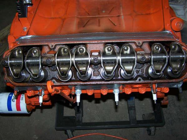

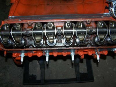

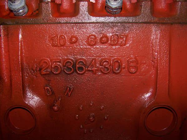

I went and looked at the motor and here are the pictures...it is not the original motor to the Cuda even though the Cuda is an original 440 car. This particular engine was built in 1967 which would also signify a forged/steel crank. He still hasn't told me a price...what do you think would be a good price to pay for this motor. What I see is what I get to include the valve covers (I took them off for the pics).

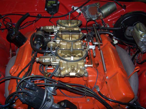

This last picture is what it looked like before he pulled it out of the 'cuda.

It's a 68....or to be more precise it was originally from a 68 model car. Casting date is 10/6/67 with an assembly date of 11/6/67. Still if you're planning on NOT using it as is, then it's a CORE motor and worth less. But I doubt he is gonna look at it like that. I'd try to get him to cough up a price first.

That does NOT look like a six pack balancer to me. If it has the 70/71 "six pack" rods in it, then he spent a TON of money trying to have it balanced without the correct matching balancer.
And like I said, that is a 1968 motor. Therefore it is NOT a "six pack" motor. He might have had it built with the other rods (69 six packs did NOT have the bigger rods), and he obviously has a six pack intake and carbs on it, but that doesn't make it a "six pack" motor.
