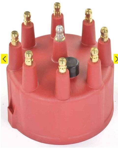

Quick question so as to not hijack.
I have cut to fit silicone wires installed now, and I left "extra" length to re-cut them once I selected a wire management "system".
For those who have used a distributor cap with "male" terminals:
1: Am I right in perceiving the overall diameter of that section of the cap itself as smaller than the same cap that has female sockets for the plug wires?
2: Is that (male cap wire terminals) a more secure way to connect the end of the plug wires?
I believe that Progression Ignition (what I'm switching to from my flawlessly performing FBO system) is about to release a new design smaller diameter (possibly smaller overall) distributor and cap, and they should resolve the occasional issue with some combinations of valve covers, heads, and engines that have required "clearancing" (the nicer sounding word for "grinding off").
So, what is the most secure, male cap terminals or female?
Here are 2 MOPAR generic examples:
Looking at these 2, the male terminals cap is visibly a bit smaller in diameter overall:
