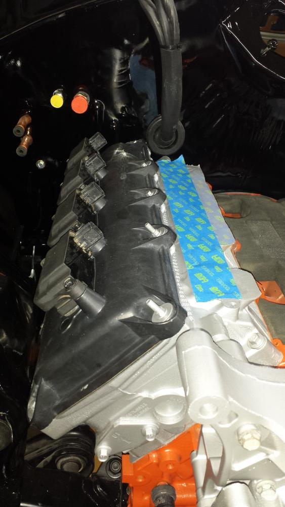

1970 Satellite getting a 6.1 Hemi
Looks good! Making progress is always nice. Do you happen to have some good pictures of the shock tower/torsion bar area with the motor and steering box installed? I plan on doing
a turbo setup in mine and I'm sure custom header are in order, but I'd love to see how much (little) room there is to work with.
No pics of that yet...but it will be going back in next week and I can take a lot of pics for ya. I can tell ya it's tight but not as bad as u would think.
Steering centerlink/pitman arm hits the milodon oil pan when steering is turned to the right. Suggestions? It might be the fast ratio arms I have on there.
I modded the hell out of my arm because of the same problem. I also made my mounts so the engine sits a bunch lower then with TTI's. I took a piece of 1" bar stock and welded it to the bottom of the arm (took like an hour of solid welding to get that even with the old bar) and then recessed the top side to clear. If you used the TTI stuff then it very well might have been the fast ratio arms.

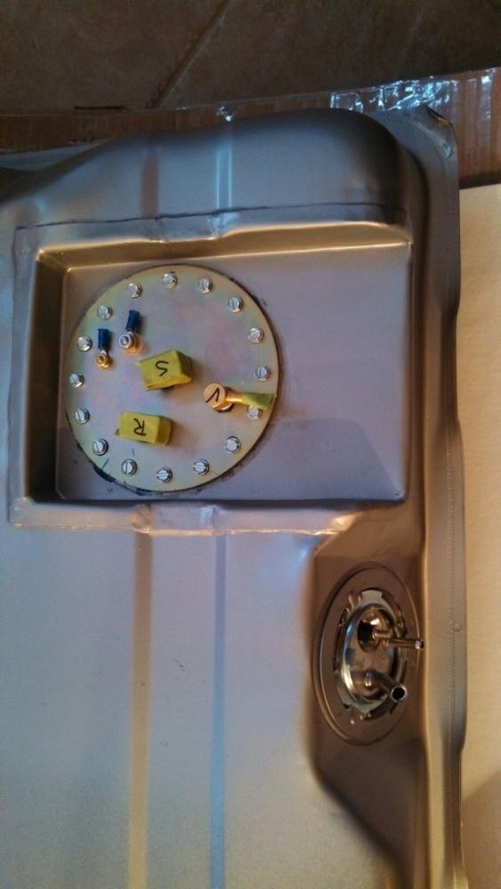

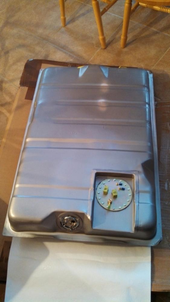

Anybody know if I use a in-tank pump from tanksinc with a stock style tank if I have to weld in a recess or is there a way to do it without more cutting and welding to the tank?
Im hoping to not have to spend a fortune on the fuel system.
This is on a 69 so not sure if tank and firewall are the same

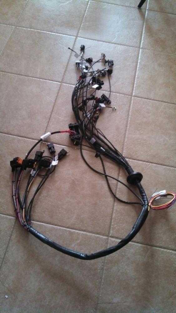

i stripped all the old wiringing out of mine and replaced it with a painless kit. when you go to hook up the motor harness to the factory, you will have to get a gm ignition switch. hotwire told me you cant use the mopar column. i learned the hard way. i know my 6.1 is all stock but dam this thing rocks. mine is 600lbs lighter than the challenger, you are gonna love it.
here is my tank for the 70 i got from modern muscle and the wire harness from hotwire. the wire harness is all labled and it was perfect. so easy to wire up.
