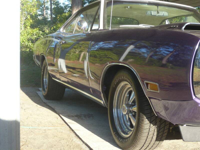

drums or disc up front? I have 235 on my front 8 inch with 4 bs with disc and back is 275 10inch with 4 1/2 bs on my 70 Bee

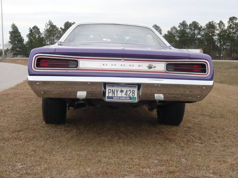

I wished I went with 225 up front,Im happy with the 275 on back I think 295 will be tight if not mini tubed. JMO
my back tire 275

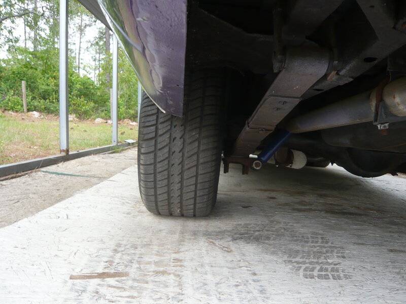

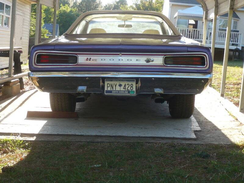

my rim is 10 inch with 4 1/2 bs on back with 275/60/15
I agree with 33 IMP 295 is a big tire so I hope a member can tell you the exact bs on their rim for it to work.
Yep, and your tire is 3/4" narrower than the 295/50, and it looks like you still have a bit of room from your tire to the spring. I think he will need to use all that room to get a 295 to fit.

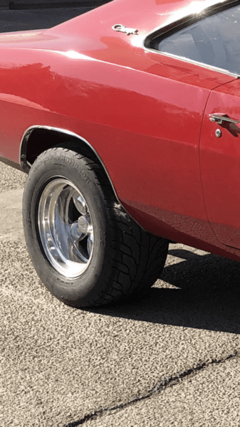

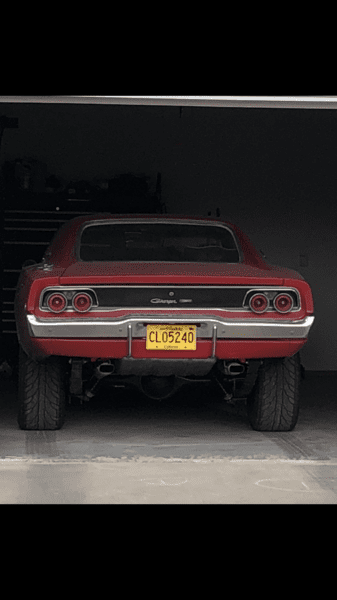

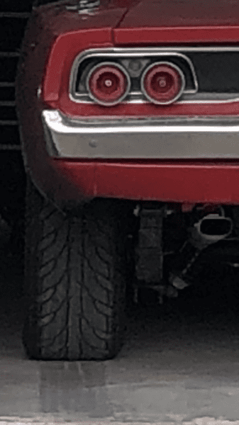

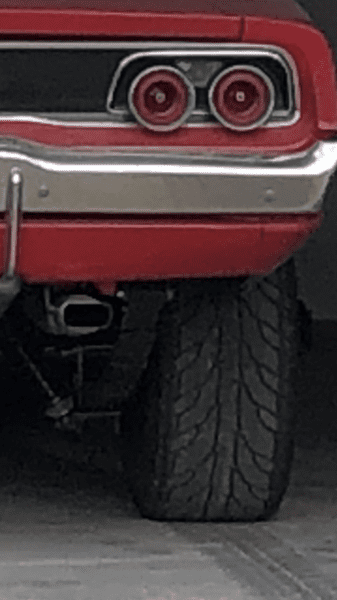

I have Mickey Thompson’s 28x 12 sportsman’s. I have disk brakes on the rear. Wheels are 15x10 with a 4.75” offset. On a 68 charger I could go wider yet. Probably 14” for sure without hitting. Sorry the pics aren’t great. If you need better ones just let me know
