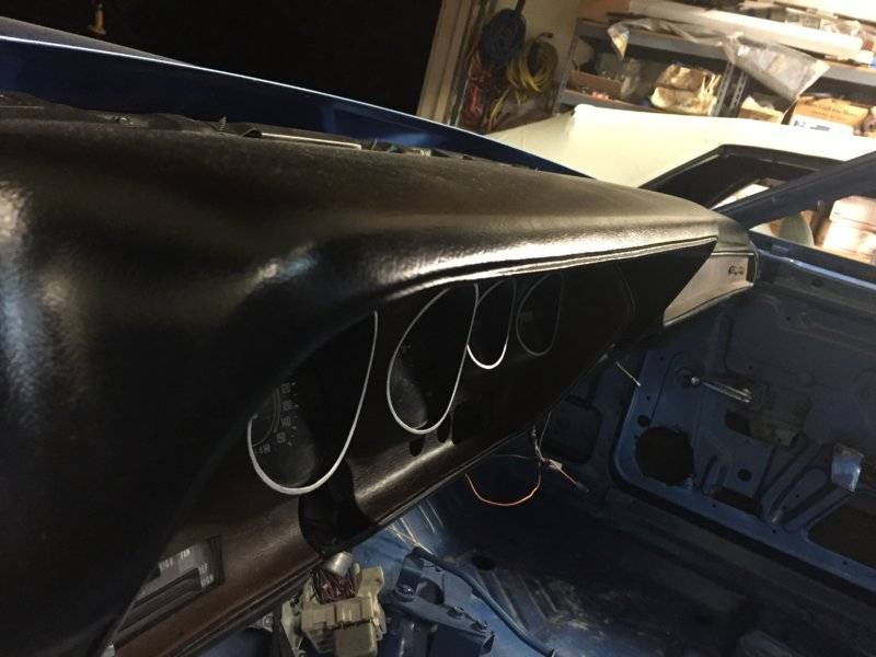

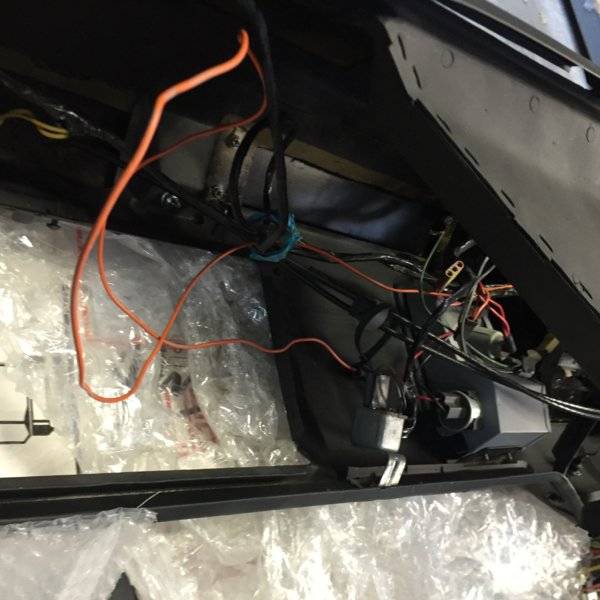

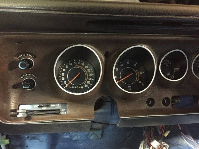

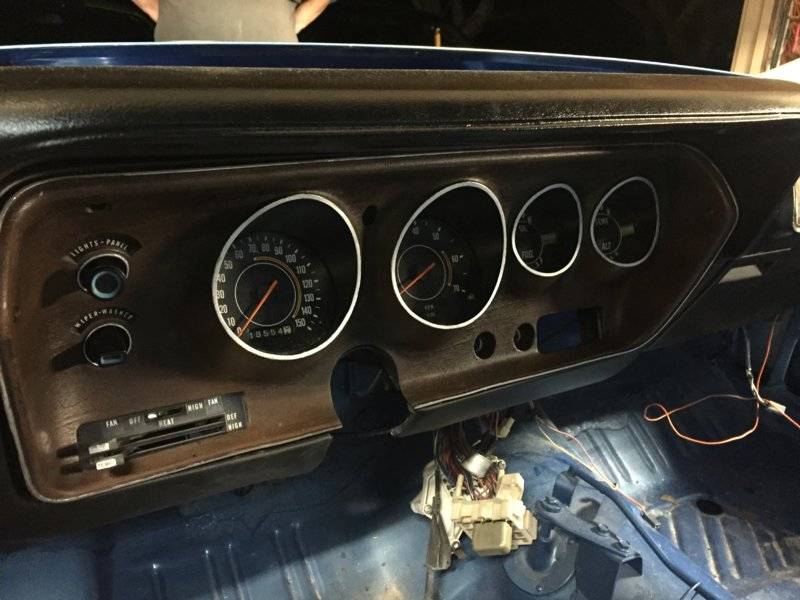

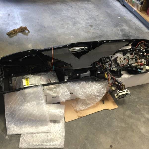

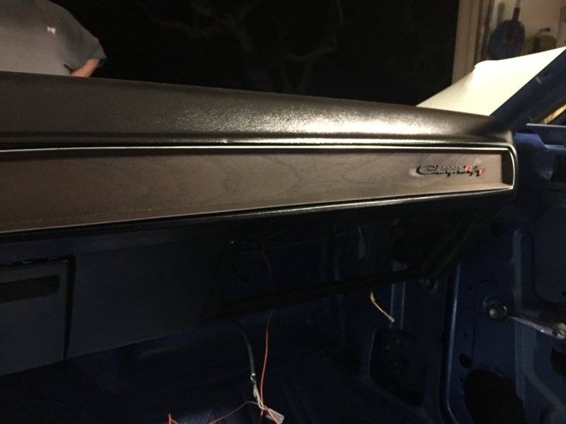

Currently trial fitting dash parts and testing gauges and wiring for problems. When done, gauge bezel and parts will be sent out for restoration before re-installation.

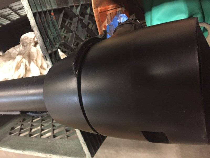

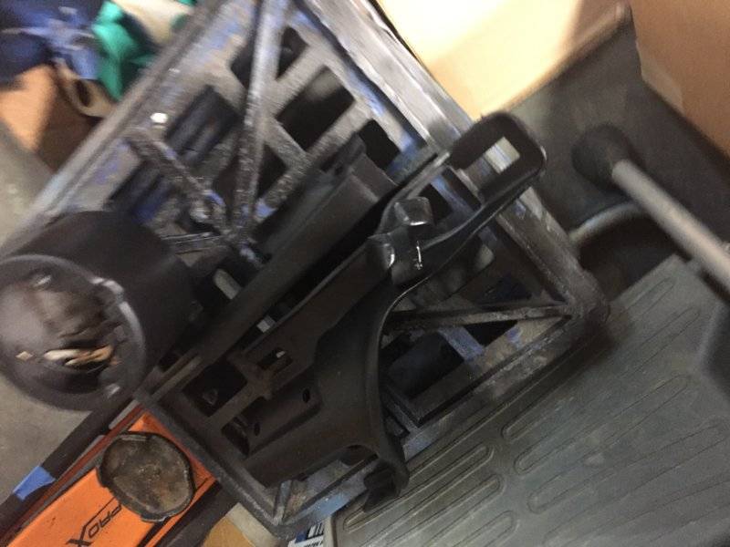

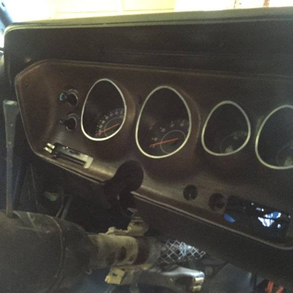

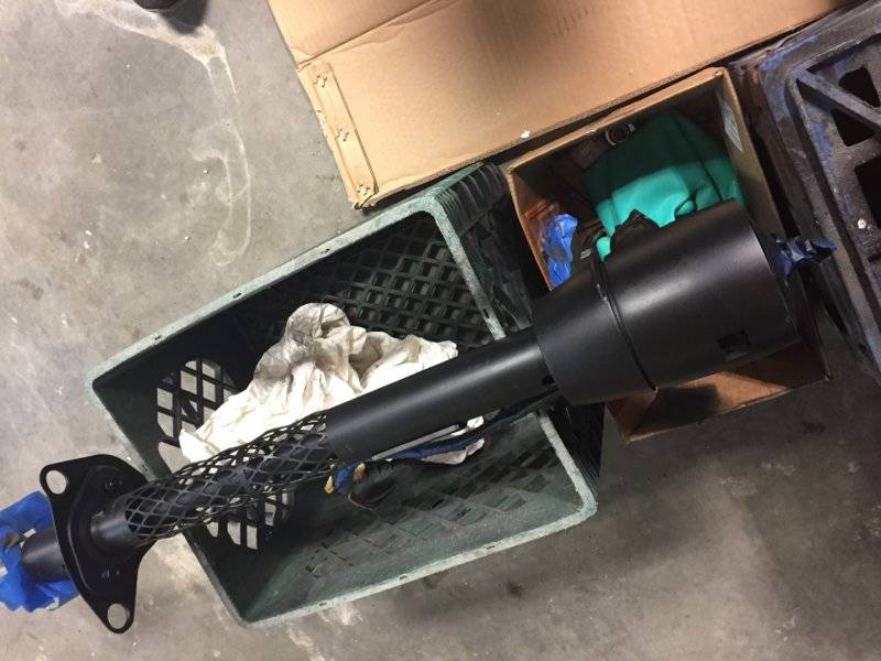

Mike was kind enough to take the column apart and restore it,,needs a bit more detailing. Will be getting a Tuff steering wheel I have been saving in my closet for over 25 years.

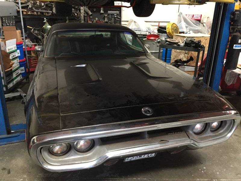

Looking good! Is the hood black out a decal or paint on (stencil?)

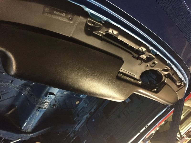

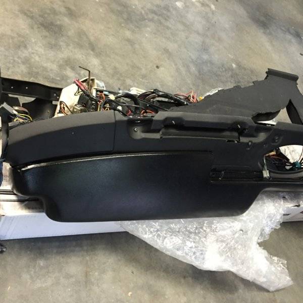

Testing gauges and harness looked good, so out it goes for some detail work. Dash pad was nos, but dyed twice in wrong shade of color, so that is getting redone while the dash frame is getting pulled out. Painting the cowl/windshield area the body shop could not get to while the dash frame was in place. Full disassembly of the dash will be done soon.

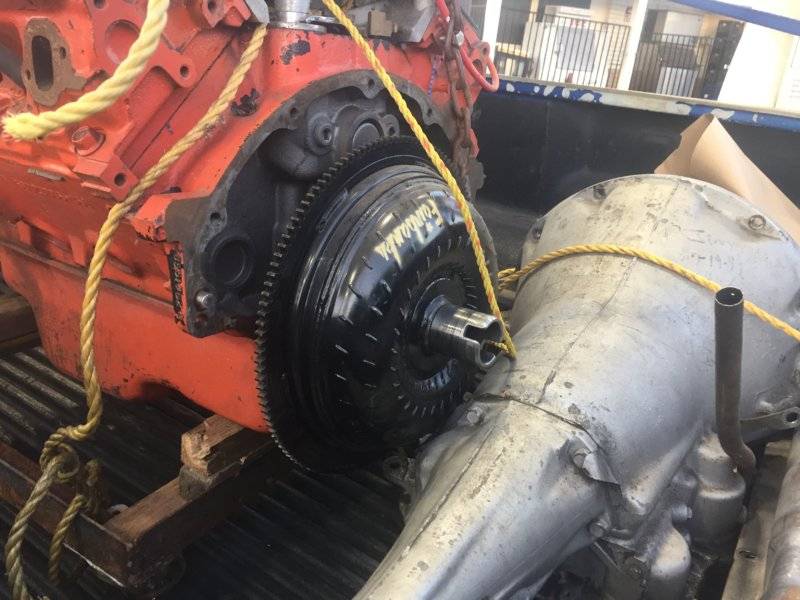

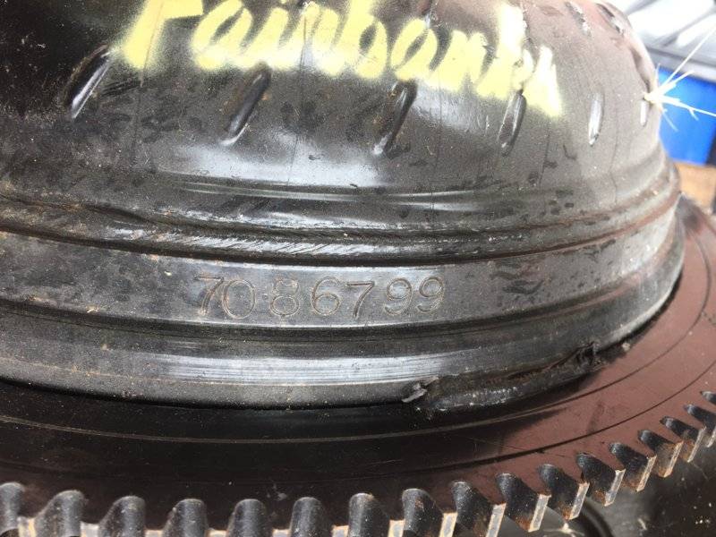

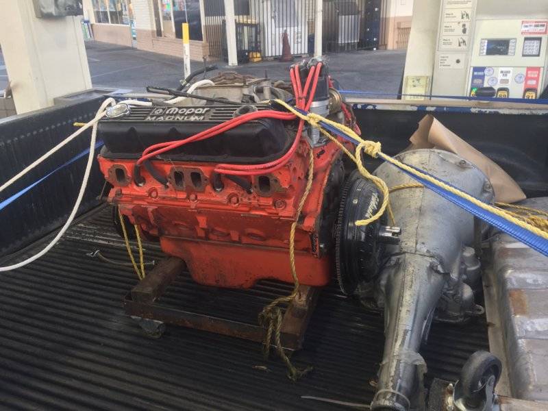

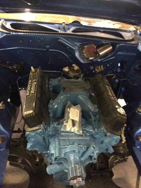

Dropping motor off next for inspection and detailing. 380HP 5.9 Magnum Crate engine with rebuilt 727 trans. was told the cam was upgraded (no specs) and should be closer to 400hp and have good freeway manners and a little more rowdy street attitude. Was an older trans as it still has a Fairbanks torque converter in it. Stock valve covers will go back on with correct year acrylic blue paint on the motor. Still not sure if it will use headers or stock manifolds at this time.

Finally had a chance to update. Picked this little jem while looking for a driver while the charger is resto mode. Hope to get to it later in December. will post pics on another thread soon, so keep an eye out.

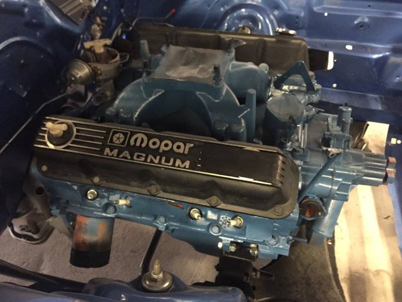

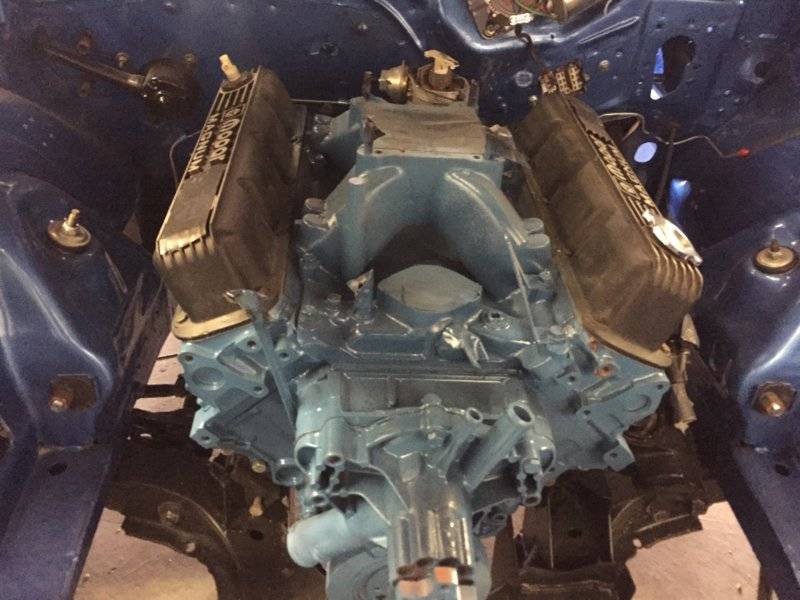

Been awhile since some updates. Motor was checked, cleaned, regasketed and sprayed blue , trans got gleanup too, but in silver. Transplanted and waiting to get TTI exhaust on next.

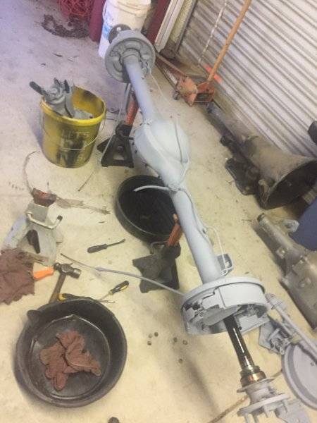

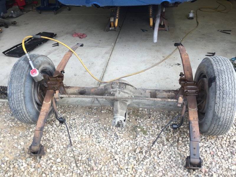

Though the u-bolts have been soaked for a week and and again in the morning, the bolts would not come out.

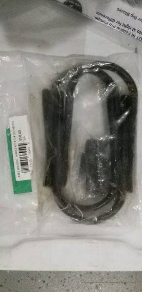

Ended up taking it to a local shop where two torches were put to it til it glowed and used an industrial gun on it and could only free 5 bolts. Decided to just cut them and order the correct u-bolts to make my buddy happy who is doing the installation. Sorry, forgot to take picks of it. In the meantime, getting everything cleaned enough for sandblast and coating for next week.
Finally had a chance to update. Picked this little jem while looking for a driver while the charger is resto mode. Hope to get to it later in December. will post pics on another thread soon, so keep an eye out.View attachment 868866

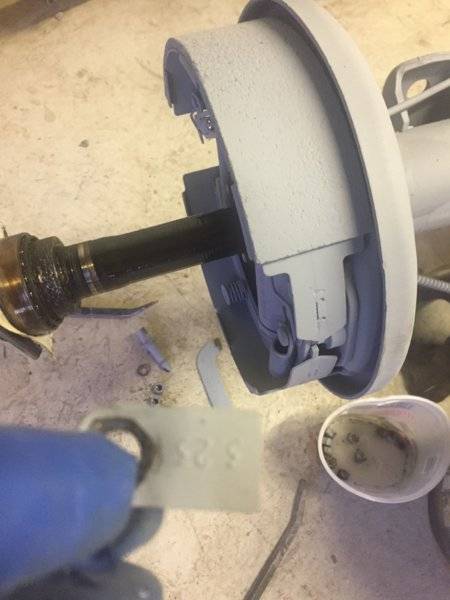

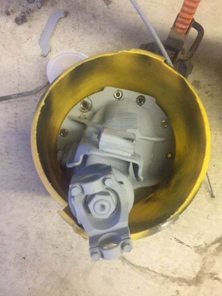

Well the rear came back from media blasting and primer coat. Left it sealed because to keep the sand out. Inside was super clean being 92k mile car. Repaint, seals and new bearing along with brake hardware has been ordered. Though it was a 3:55 but turns out to be 3:23. Not a heart breaker, but the freeway rpm’s will be much nicer though. Should be done by the weekend if the weather permits painting and all the parts arrive. Even picked up the correct u-bolts for it.
