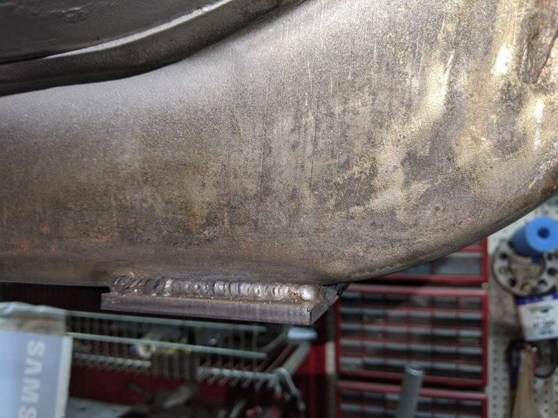

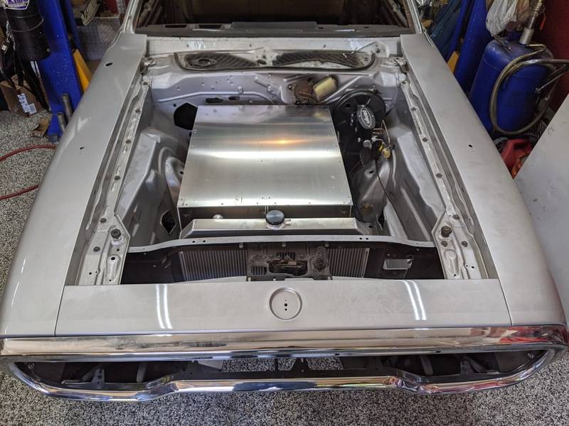

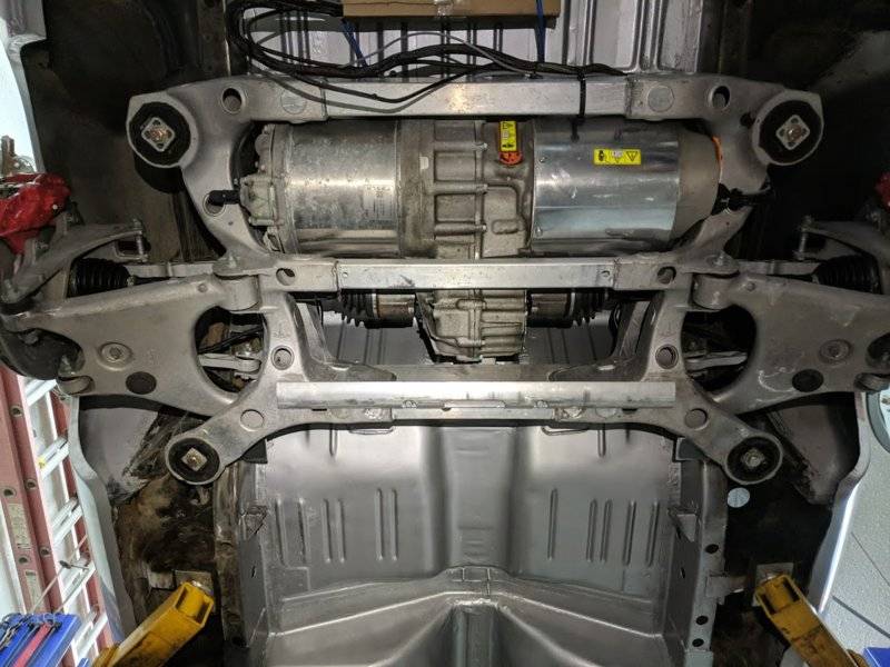

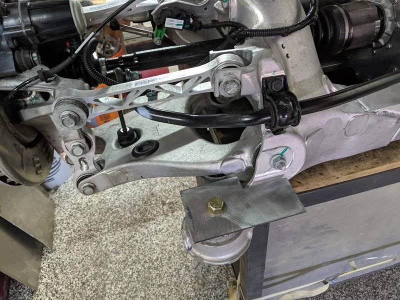

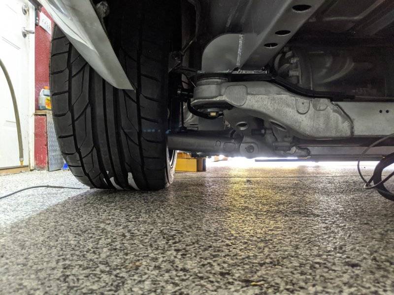

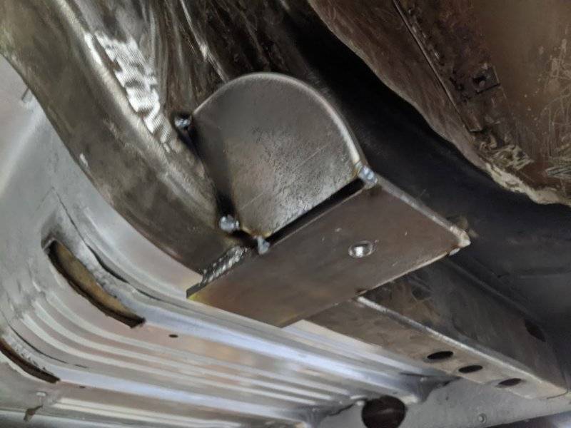

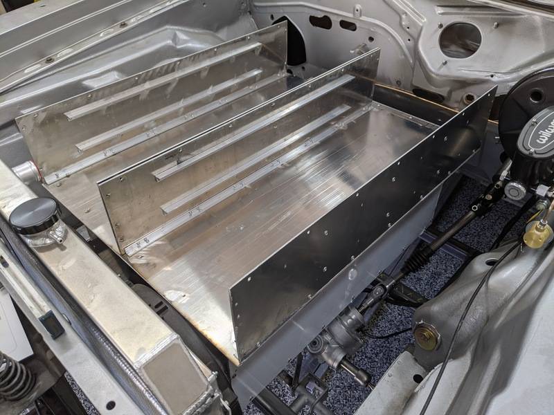

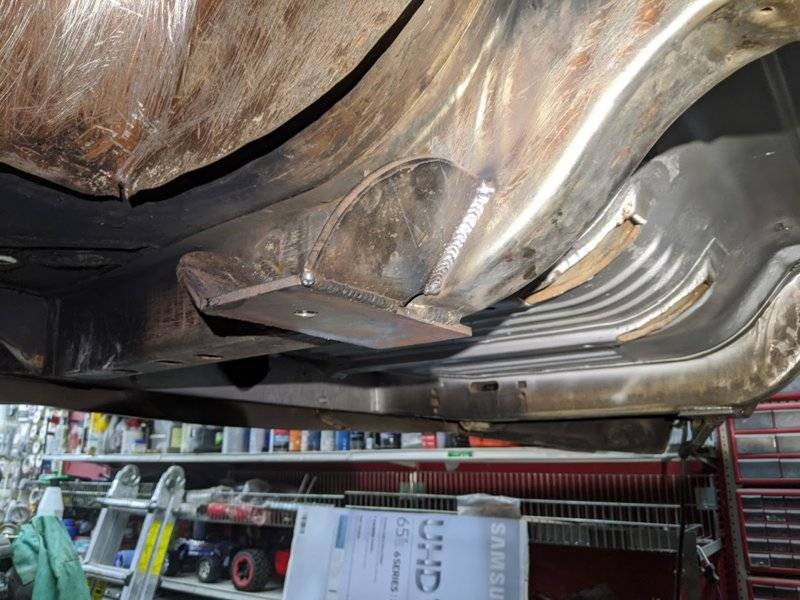

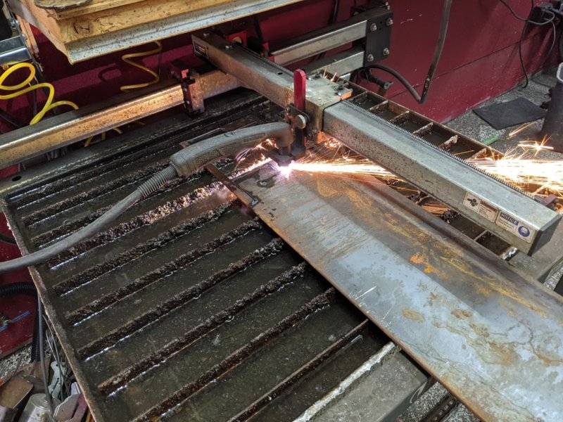

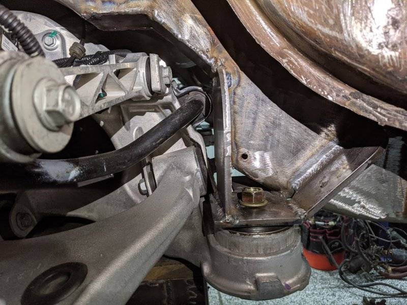

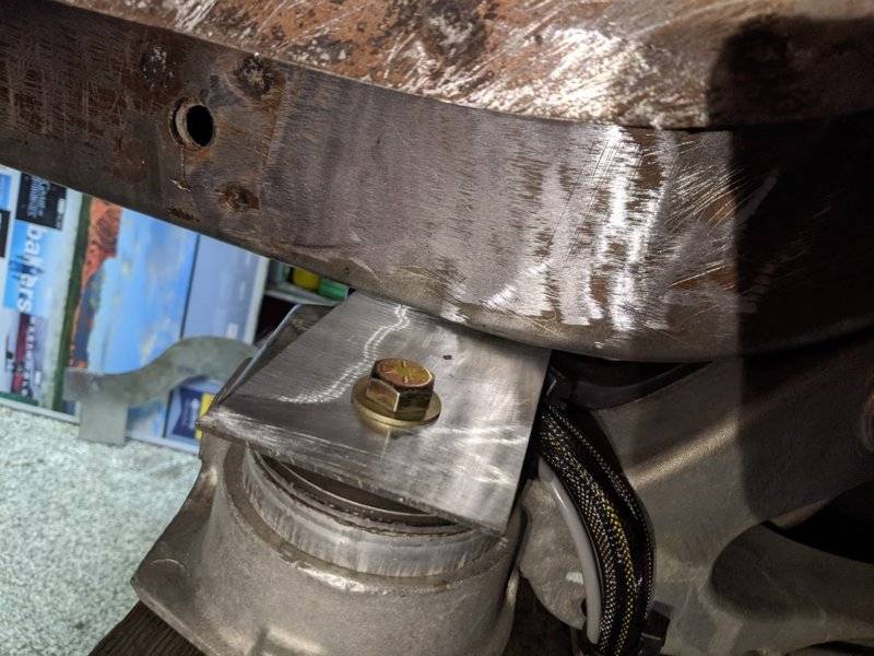

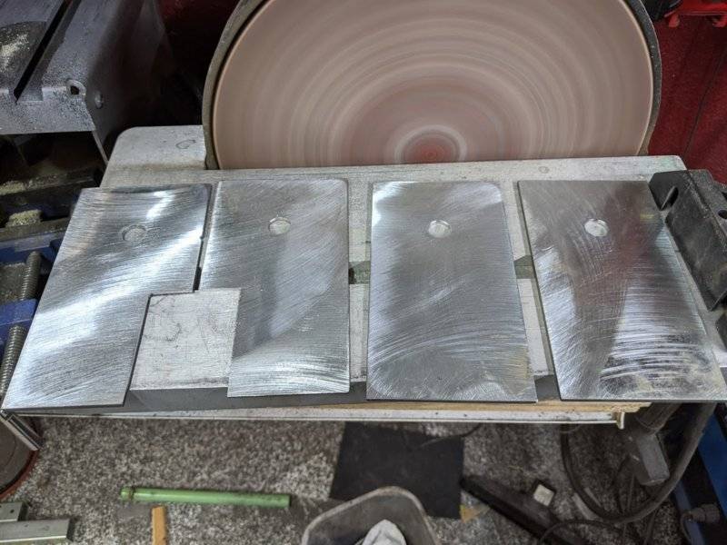

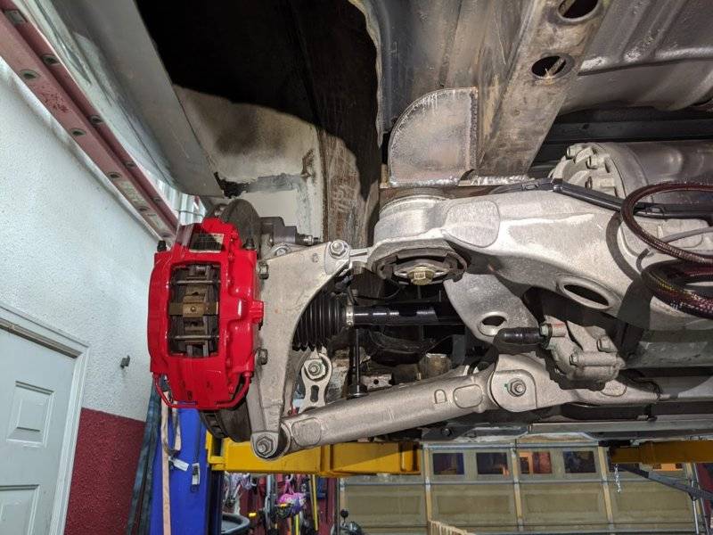

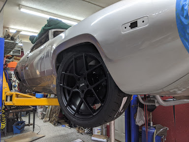

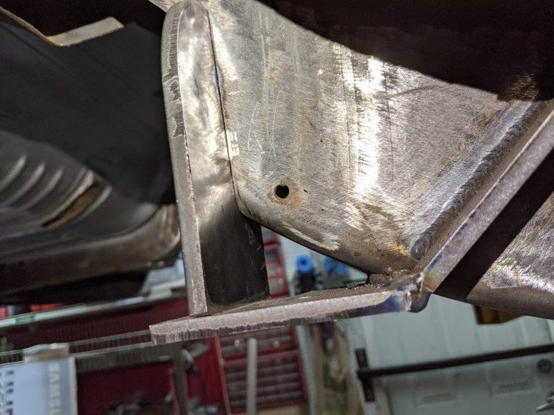

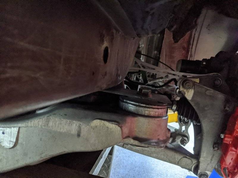

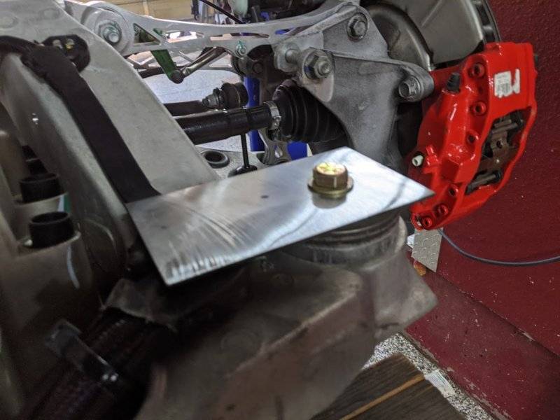

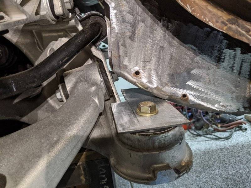

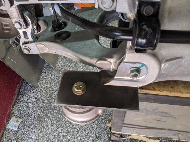

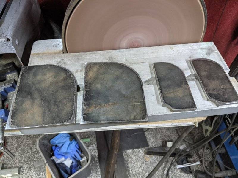

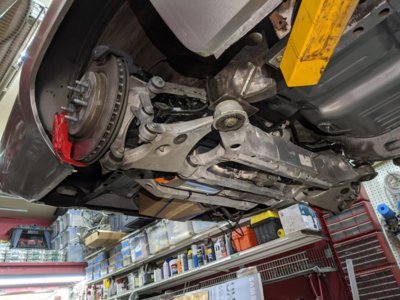

Fabricating some mounts.
IMG_20200221_104542.jpg IMG_20200221_105130.jpg IMG_20200221_105140.jpg IMG_20200221_105721.jpg IMG_20200221_110930.jpg IMG_20200221_110936.jpg IMG_20200221_112552.jpg IMG_20200221_120335.jpg IMG_20200221_121443.jpg IMG_20200221_171332.jpg
This is such a sweet build. Based on your pictures, it looks like it's not as far off from fitment as you would think. I doubt it's anytime soon but as we grow more towards electric, your car may be used as the template to keep our cars relevant and on the road.
Fantastic project, I cannot say I am EV fan per se but I do understand the torque side having gotten to drive a EV vehicle a few times. I love the fabrication most, very inventive and well executed.

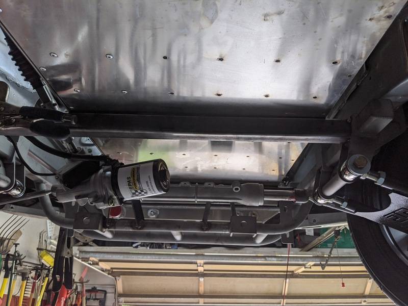

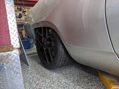

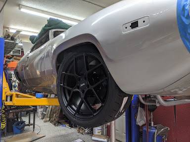

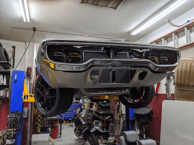

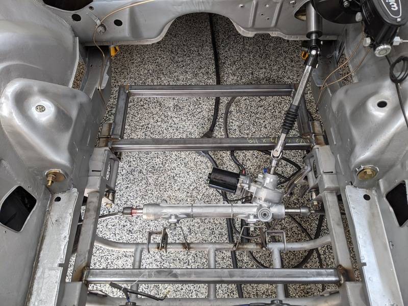

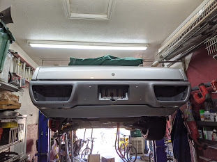

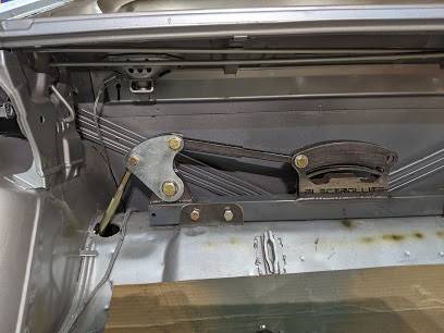

A little progress update...Here are some photos and a video of the suspension build.
Had to build a Pushrod suspension because there was no room under the car. Also got the headlights mounted, trying to decide if I want body color bumpers, and got the Gerst K-members and 14 inch wilwoods mounted. Electric Power rack coming soon...
IMG_20200326_152727.jpg IMG_20200326_153055.jpg IMG_20200328_181940.jpg IMG_20200328_202608.jpg IMG_20200401_201722.jpg IMG_20200403_141735.jpg IMG_20200403_180056.jpg IMG_20200405_104522.jpg

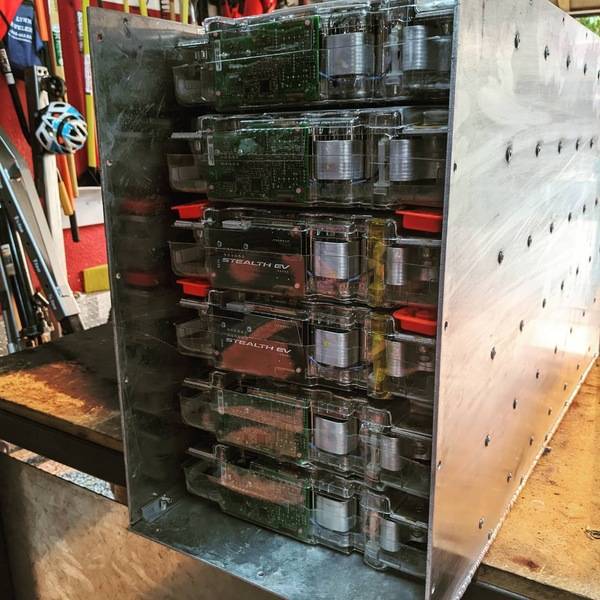

I had a friendly request for an update and realized it has been awhile.

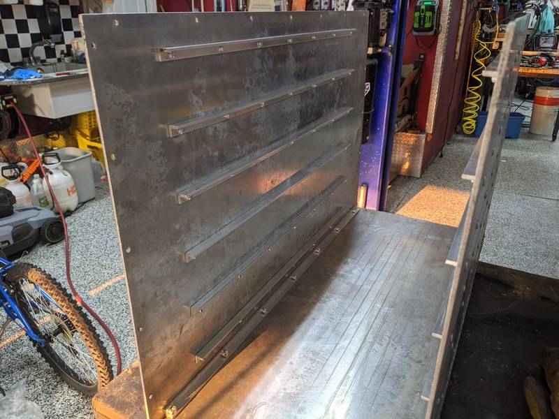

Electric Rack and pinion is mounted, suspension is done, and the car is a roller. Battery boxes are well under way, and the low voltage wiring is about 90% done. Next will be final assembly of the battery modules, installing the interior, windows, trim etc. Hopefully I can power it up in a couple months.
