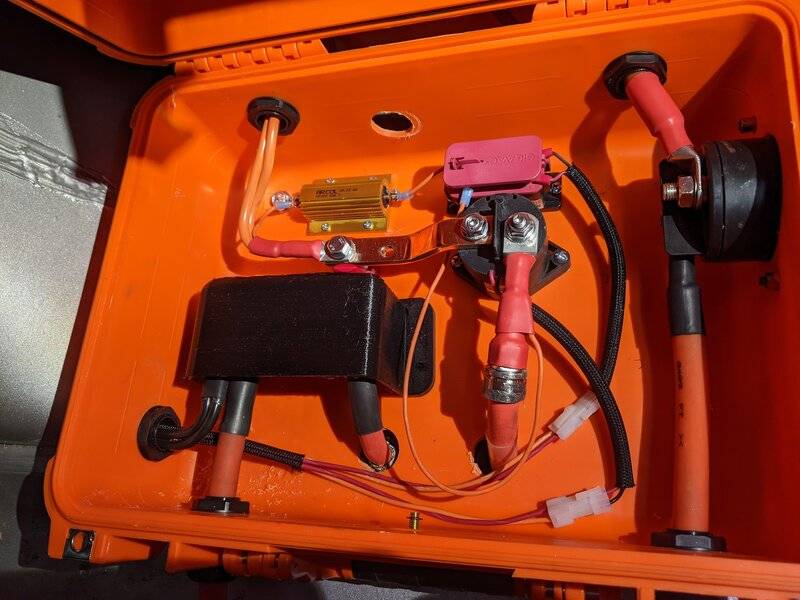

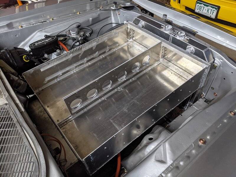

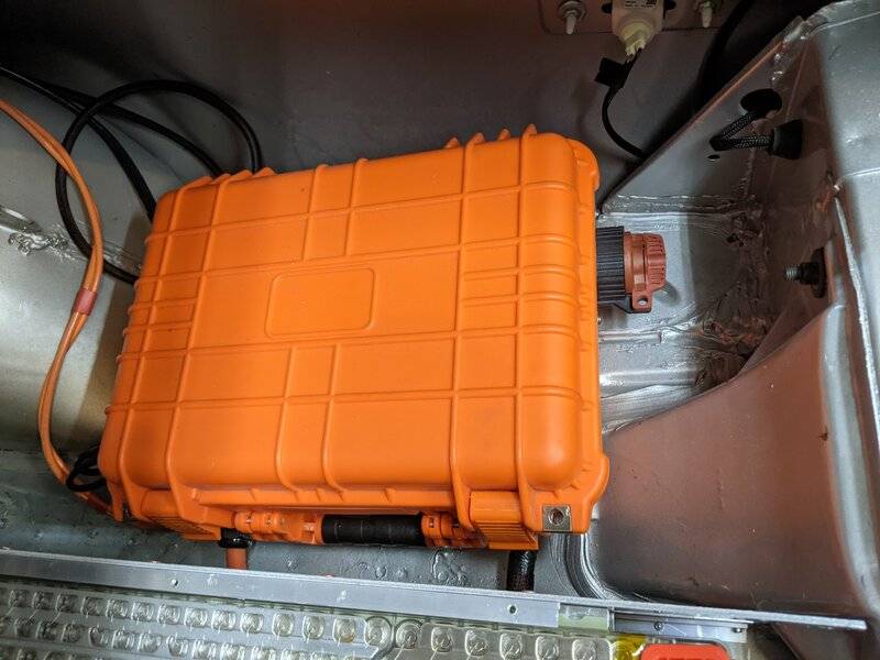

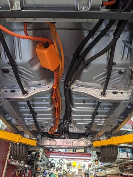

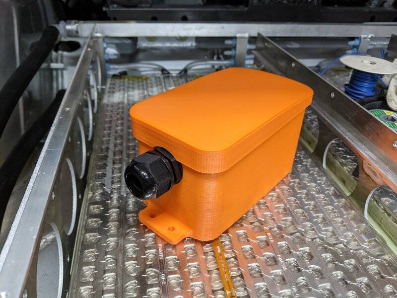

High voltage contactor, bus bar, and disconnect switch box complete. The disconnect breaks the 400 volt circuit between battery boxes to cut voltage of each box for service/installation, as well as cutting power to motor and accessories. Pyro fuse installed in 3d printed ABS box. This fuse will blow itself like an air bag in the event of a high voltage short. Front upper battery box has the last four battery modules for a total of 16 modules / 96 cells in series.

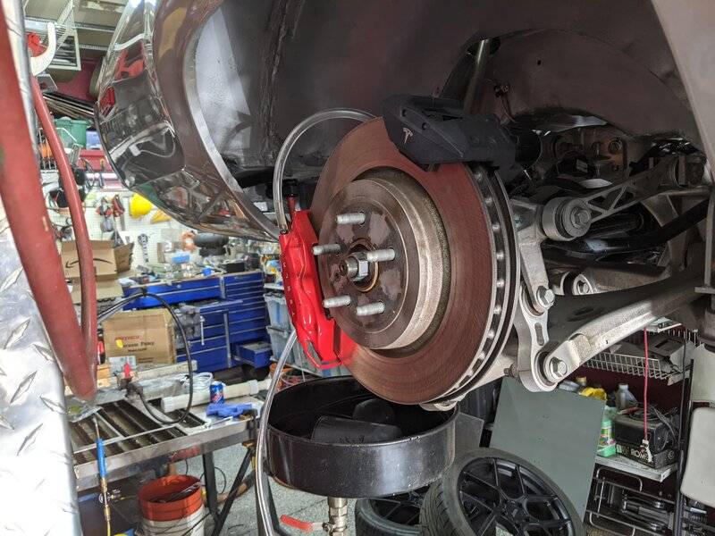

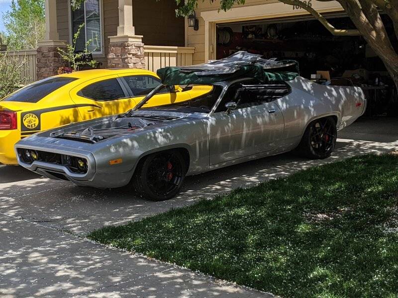

The car has been powered up brakes are blead, and it made a trip around the block under its own power. Time to tie up the loose ends, replace all the glass and front power window regulators. Then interior, and hit the shows and cruises.

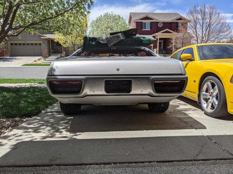

Yep I have been calling it Electrollite after my buddy coined that name... Those are good names too! I've also been saying it's Hellectric and some people call it Starlink.
I put a Charger license plate cover on because that is the location of the charger, and it's some good conversation.
