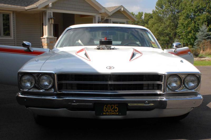

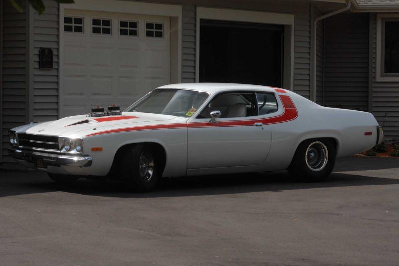

I didn't tub it at all. All i did was move the springs in with the offset spring hangers. put an "A" body rear end in it (relocated the perches) and that was it. The tires are about 11 1/4" wide, 30" tall, the rime is 10".
the car is also lowered a couple of inches.

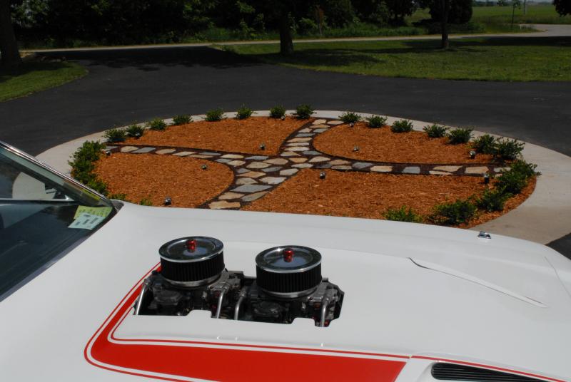

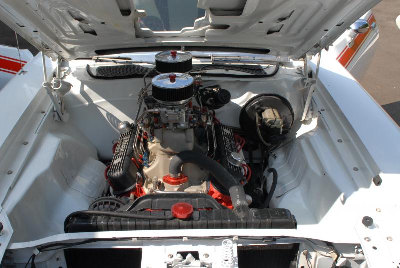

This is a 1974 Roadrunner, originally with a 318 2 barrel, dual exhaust (I believe 170hp), automatic on the floor, air conditioning and cruise control. back when i got it it actually got 20 miles per gallon.
Pictured, it has a 1969 340, "X" heads with 2.08 valves. a big tunnel ram, two stage nitrous system, big solid cam, and a 3800 stall and 30 tall tires in the back.
I have recently removed the nitrous and tunnel ram, and am now running a barry grant modified holley. The rear end is an 8 3/4 "A" body.

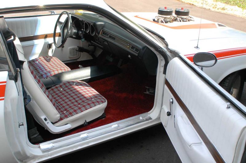

The interior is the Wimbledon style which is original down to the shag carpeting.
View attachment 91096View attachment 91097View attachment 91098View attachment 91099View attachment 91100View attachment 91101View attachment 91102
I think I have seen your car on youtube. Great looking Runner!

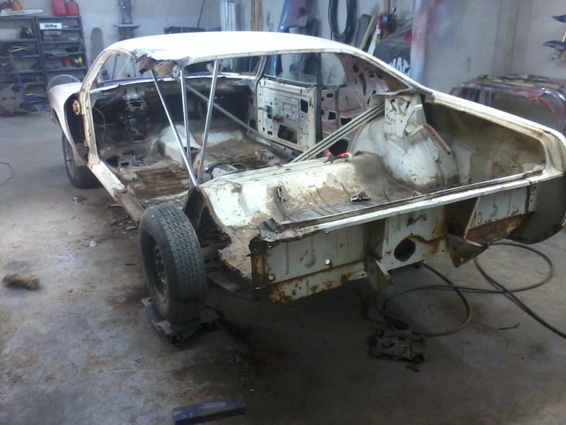

New guy here with a couple pictures of my 1973 Road Runner. Needs a little work still.
Mike 73 RR rear frame rails cleaned.jpg73 RR qt panel removed drivers rear.jpg
MikeView attachment 91165View attachment 91164
WOW!!!!!!!!!!!!!!!! Tell us the story behind your car and what is going on with it? That looks like an awesome project and a big big project at that.
Thanks for posting and thanks for saving another one!

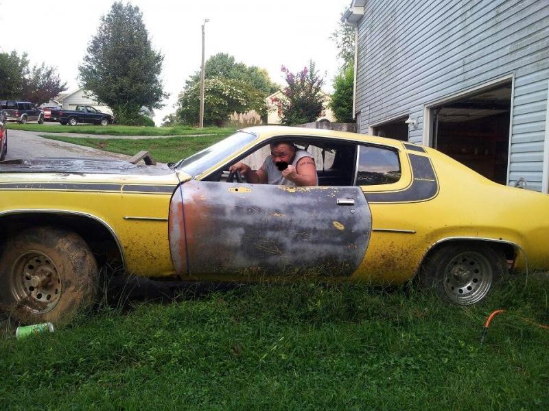

Heres my '73. It ain't pretty, but its mine. Thats my Ford loving neighbor helping me move it.ddddd.jpg
Heres my '73. It ain't pretty, but its mine. Thats my Ford loving neighbor helping me move it.View attachment 91276
Great photo and it looks like a great project. What is the original color of the Roadrunner? I think they had two different yellows that year. The one I'm looking at to buy is a leighter shade of yellow like the one Daizy drove in the Dukes of Hazzard.
I really like that project and maybe it will change your neighbors mind on Fords lol.
Tell us more about the car give us some specs on it.
Its FY1 yellow, 318 auto, bench, nothing special. I think in '74 they changed the color to KY5 "yellow blaze". I traded a charger powerbulge hood for it and 2 other satellite parts cars and a ton of scrap metal, compressors, alternators, axles, heads, blocks, ect. After i scrapped all the junk that I didn't keep, I ended up with about $600, and bought me another (better) charger PB hood for $400!!!!! :hello2:

Alittle about my car. 1973 Road Runner 400 4 speed, white exterior with red stripe and white interior, bucket seats, no console or buddy seat,non A/C, power steering/brakes. I have the original transmission, but the 400 is sitting in a farmers ditch somewhere in Kansas. The engine was blown when the car was hit hard in the drivers side door and quarter panel. Sat outside for a long time, so that where the rust comes from. Was lucky to find the parts to rebuild it and I did find a real nice NOS quarter panel within 5 miles of my house. Its on the car now. Getting close to painting the interior/trunk/engine bay.
Mike
Mike
Mike that is awesome man and what an awesome color combo! I love the white with red stripes one of my favorite. How is the NOS quarter? That is great you found one and found it close to you. Post more pics when you can would love to see some as the car comes along.
Also awesome that you are saving a car most would pass on. I can't wait to see it done and more pics.

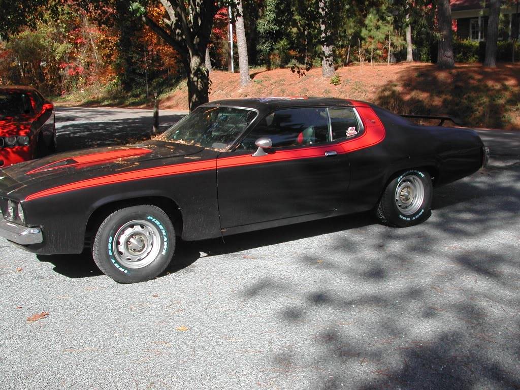

Details man I need some deatails on that awesome looking Roadrunner! I love the red stripes over a black body. Also wow what a difference it makes taking the bumper guards off. That is just one of those suttles things that makes a big big difference.
I love your car man, I love everyones cars. I almost broke down and called the guy with the 73 I'm getting close to just saying ok I'll take it.....Whats $500 bucks.....Parts money is what lol.
I will check out your youtube page as well.

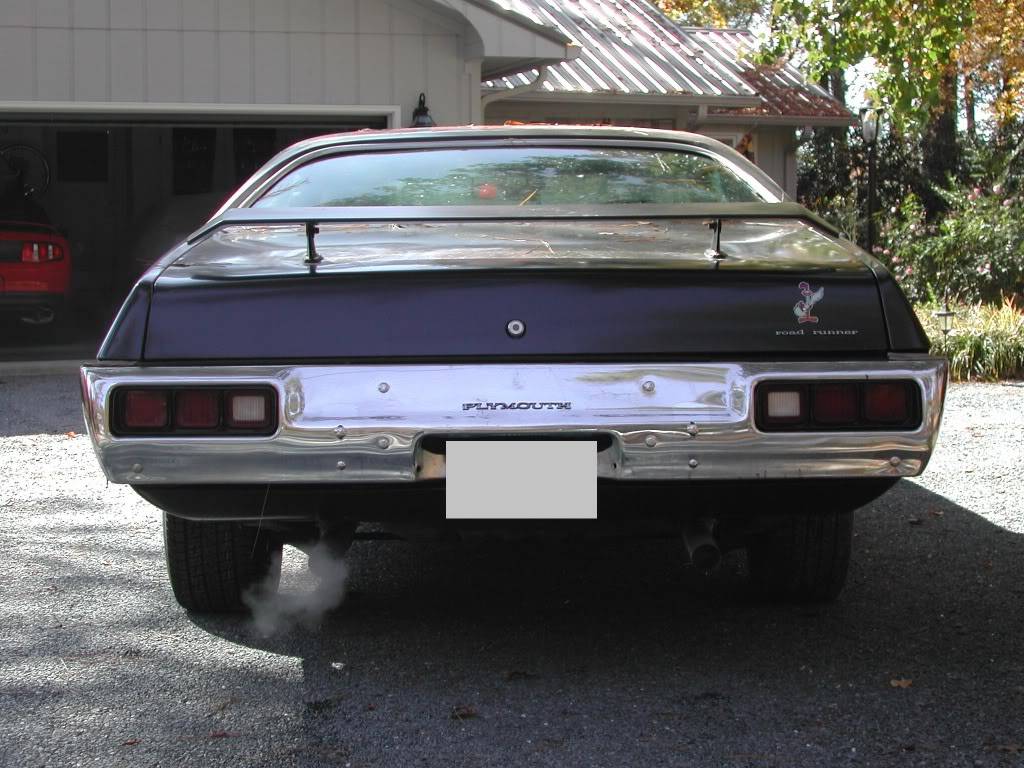

she looks ok from a distance, not so sweet up close
picked up as a stalled project in gray primer and boxes
saved from being parted out
74
codes for ac, that color, buckets, console, etc.
bummer is 318
has nom
original rear end and 904
free wrong buckets, and rear seat and panels from 73 satellite for free
added spoiler
factory sunroof

Awesome! I dont think I have seen a factory sunroof Roadrunner would love to see more pics. I thought I found one a while back maybe on youtube but it was not a factory one.
Its a great looking Roadrunner!

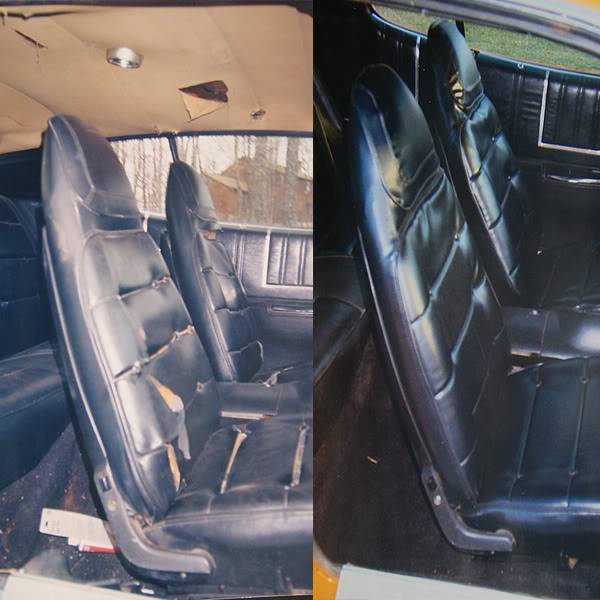

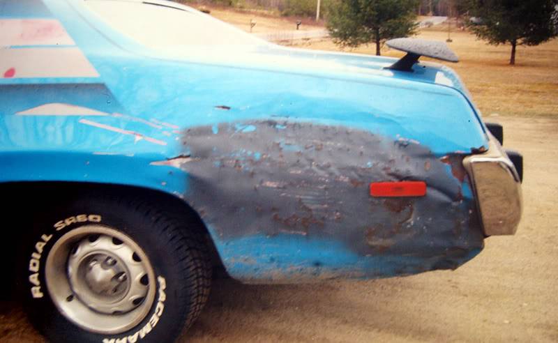

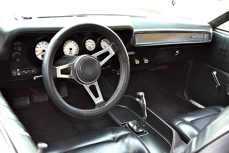

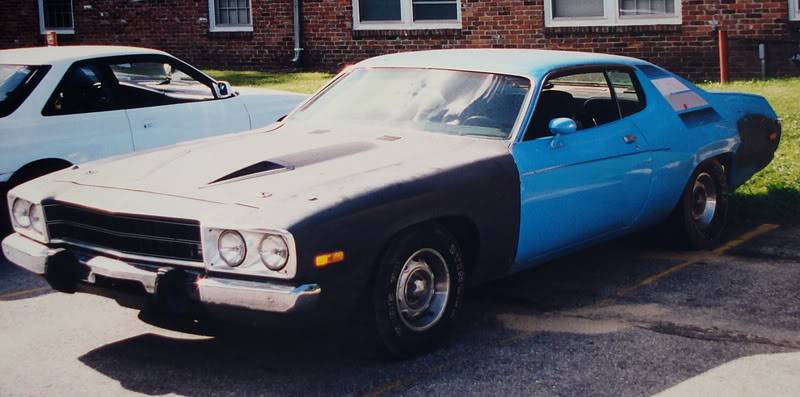

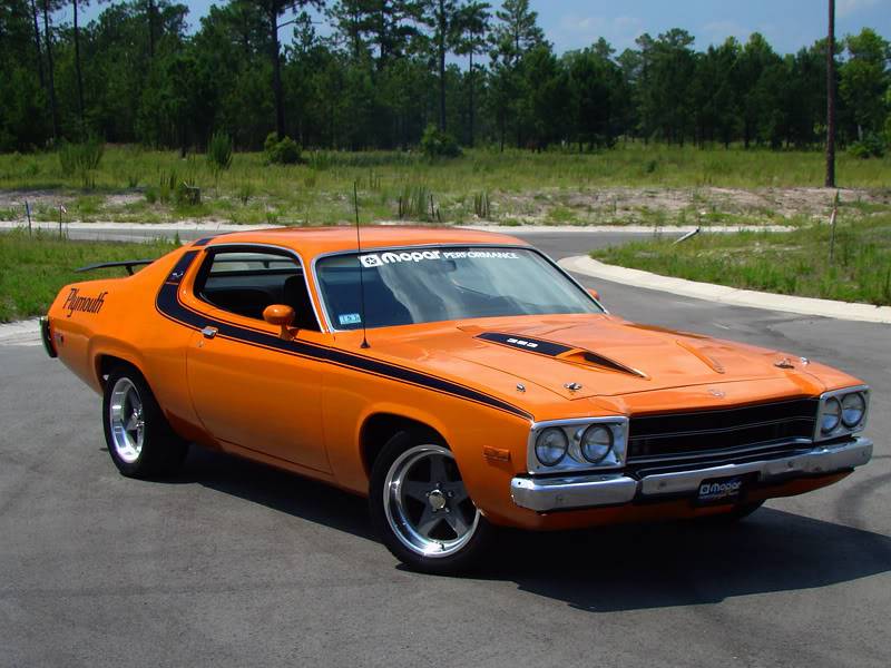

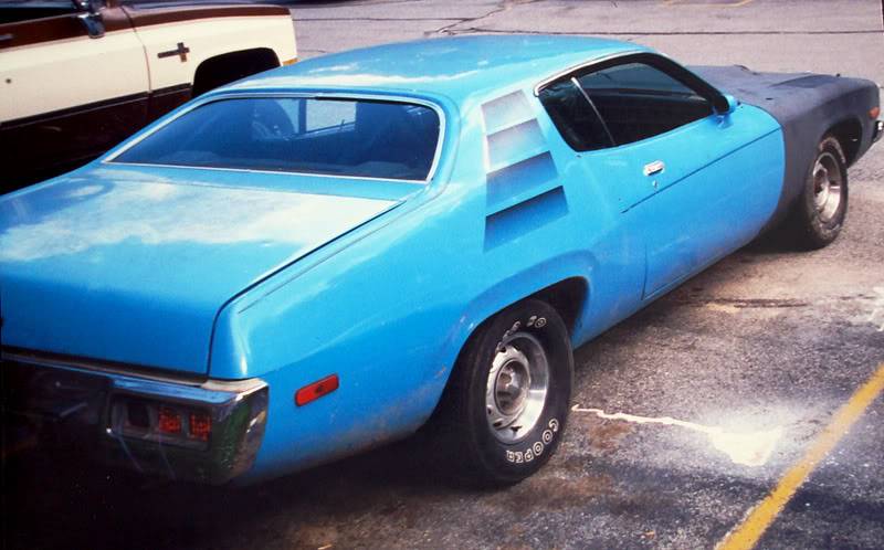

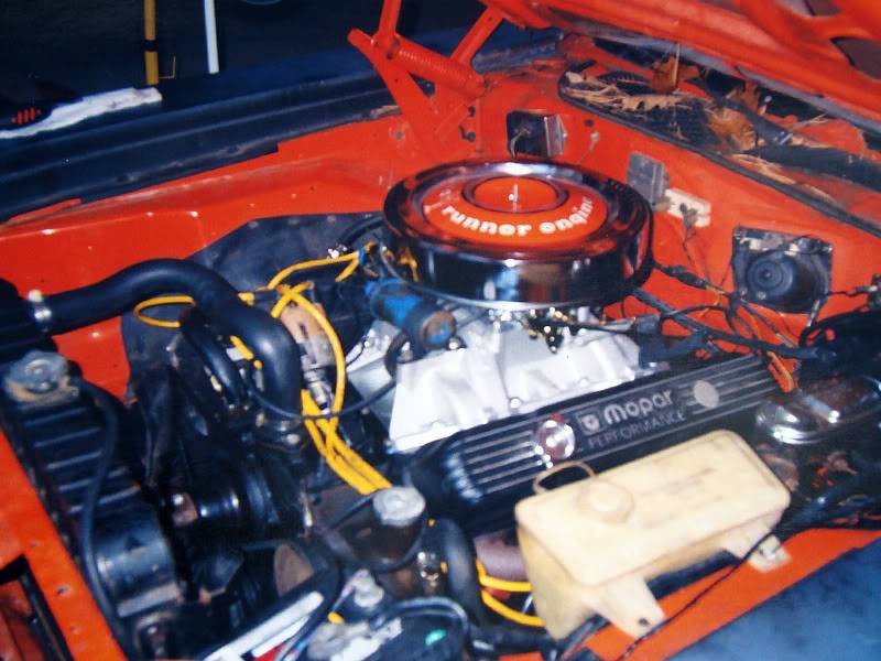

My 74 Roadrunner.. Started out as a dark moonstone metallic brown stripe delete car, with a tan interior.. It is a 400 4-speed car.
It was painted Panther Pink, then Petty Blue before I got it. Now it has a 383, (original engine was long gone before I got it)
it has 3.91s in an 8-3/4 rear end, still has a 4 speed.. I painted it Vitamin-C Orange, it now has a black interior, I added roll down
rear 1/4 windows from a Satellite, added a fuel cell, 17" wheels, redid the interior, (recently adding new gauges, carbon fiber pistol grip,

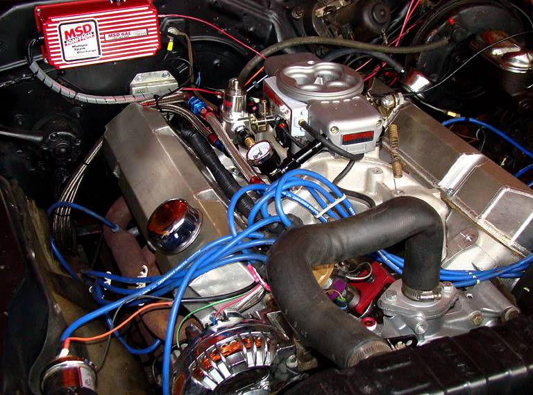

and changing all woodgrain to black.. though I kept original bezels, gauges, etc) Under the hood I added aluminum heads, new cam,
edelbrock performer RPM intake, MSD ignition, etc, etc.. Anyway, I will let the photos tell the story
I need a new engine bay pic.. I replaced the master/booster, and swapped this fuel injection back to a carb recently
and a few when I got it
I'm sure you know this already, tattooedblue, but your car is amazing.
