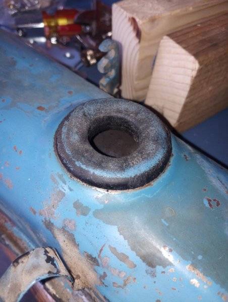

Going through the 340 in my 1973 Road Runner brought up a silly question. I was told this motor had never been touched and by everything I found that seems true. I always thought the breather and pcv grommets were installed at the factory after the valve covers were painted. And that is how I restored my big blocks in the mid '80's.

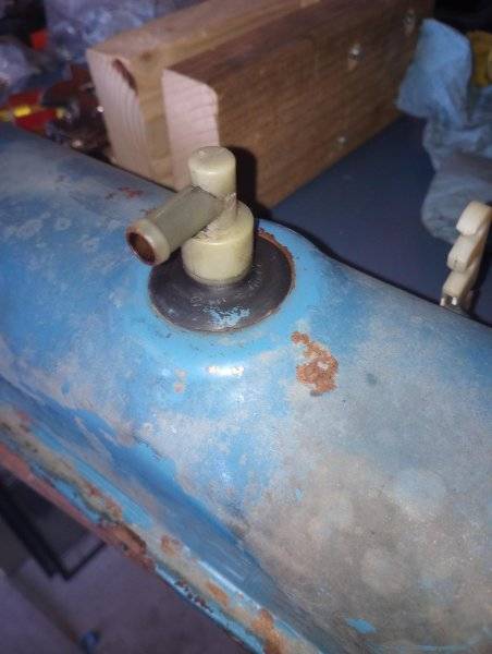

However, after cleaning off the grime from the valve covers the grommets definitely show signs of engine paint. So, my question is, were they painted installed in the valve cover from the factory?
Thanks as always for help from the experts.

I don’t have any experience with 72-later 340s but conventional wisdom for 70-71 340s is they were installed prior to paint (should be painted engine color).

As far as your question, my original valve covers are long gone, unfortunately, but as I searched for another set they all had blue paint on the old grommets so I would imagine Floyd is correct and it was standard practice.

And between your findings and Floyd's info it looks like blue they will be!
