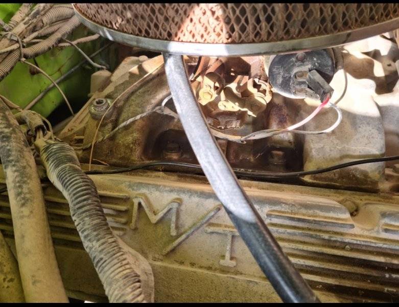

By looking at your pictures, the engine compartment is very dirty and it looks like it has a very fine dust all over. It's hard to tell but it looks like your air filter is quite clogged.
Start with the basics. Get a new air filter - if the car can't get enough air there will be problems.
Next, if some idle and timing adjustments don't work, I'd try a good carb rebuild. That doesn't mean slapping some new gaskets in it, but going through EVERY small hole and orifice with a wire and carb cleaner, and then carefully reassembling it and tuning it as discussed above.
It is quite dirty cleaning her up , getting a new carb too , hopefully solves the issues
