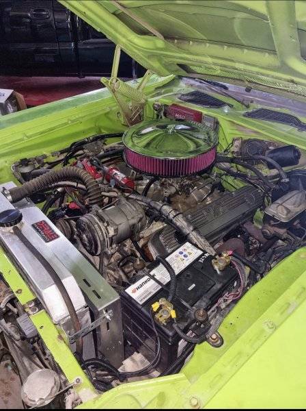

i will , the carb is leaking fuel bad to get that sorted first with the timingWhy not measure the vacuum? My power brakes work with 7" of vacuum. If you have another car that runs run a hose to that and try it. I would also play with the timing before I bought a new carb, just because in the end I think that is your fix.
