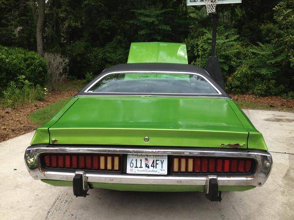

I have a 1973 charger, bought it about a year ago. Been working on it ever since.
360
A-727TF Professionally rebuilt by Rincon Transmissions - Great job they took my father and I in the back and explained to us what we did wrong when we tried to rebuild it (June 1st, 2013)
Headers
Eddelbrock performance dual plain intake
550 CFM Eddelbrock Performer Carb (Plan on buying a 650-750 Holley DP
Purple cam - .509 lift I believe?
All original interior
Cooper Cobra Radial G/T tires - Plan on getting new ones, not enough grip and crud for cornering. Makes the detroit lean even more extreme.
18 x 10 Rear Tires
17 x 8 front
8 1/4 One tire fryer (limited slip) with .323 gear (I believe) Threw the drive shaft 4 times before breaking and taking the car to shop to find out i need a new yoke which would cost me $200 in parts. Shout out to Landspeed automotive for the awesome job they did.
Lastly dual exhaust bent down just behind the tire
This is what she looked like:

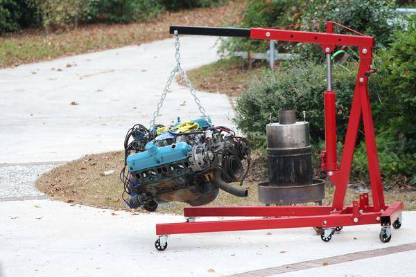

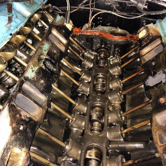

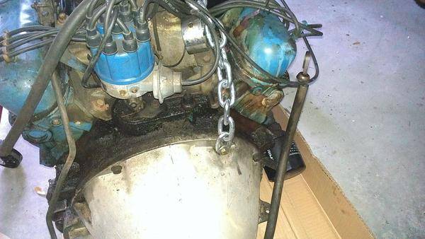

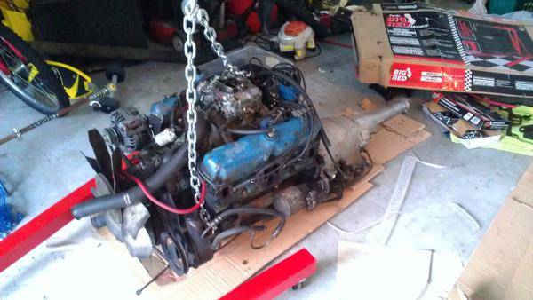

I don't have an engine shot other then these. Which were after we took it out.
Getting Started (pulled the engine and tranny):
Engine Compartment:

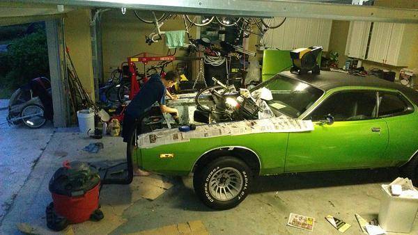

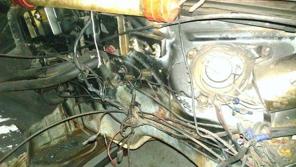

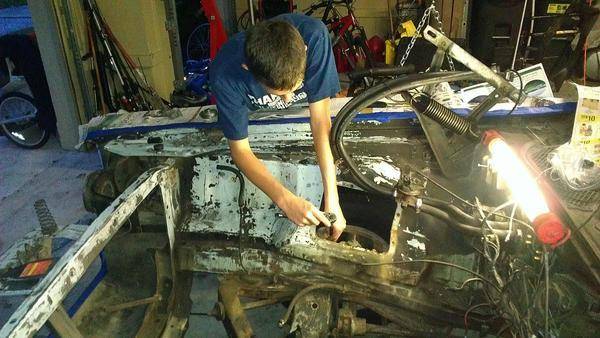

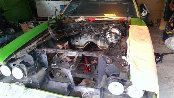

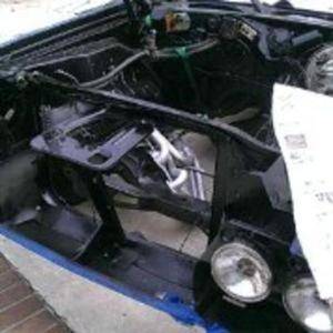

With a can of Paint remover and a bunch of steel wool I got started on the engine compartment:
Brake Cleaner to get the buildup off the K-Member (dad wasn't to happy to have it all over the garage floor - "Amateurs mistake"

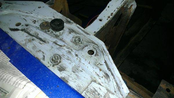

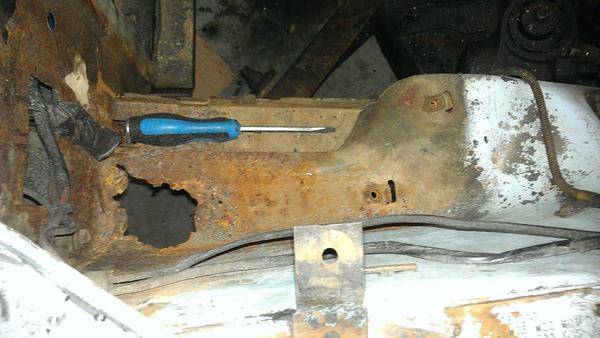

Found a good chunk missing under the battery tray.

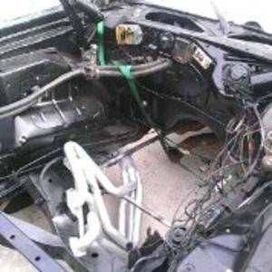

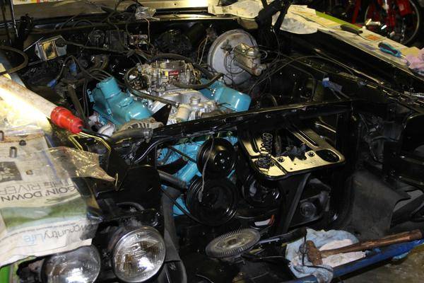

Rebuilt the whole front of the car while I had the engine out (shocks, added disk brakes, ball joints, etc)
After pretty much rubbing until my fingers were nubs this is what the whole compartment looked like
Sand blasted and fresh paint on the valve covers. Brought the engine outside with a power washer and hosed it down.

I have plans to have the body work done and it painted Sublime green buy the start of winter. Then I'll head into detailing. Since the car is already non-original I might as well make it my own.
Welcome to the board. Nice job on the engine compartment. Everything on the car looks fixable but they do have a way of keeping you short on funds. :)
Welcome! Awesome pics and vid!!!! Good luck with the metal work and can wait to see some more updates.

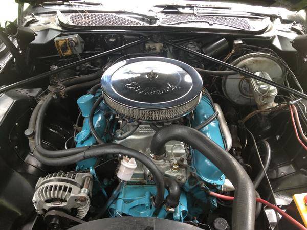

Update

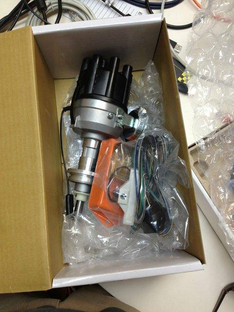

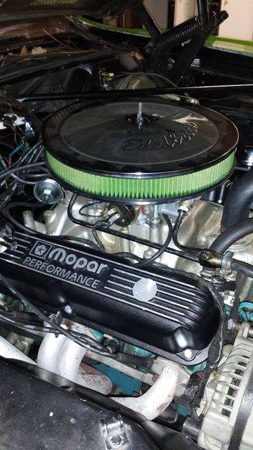

New Dizzy - Mopar Perfomance Electronic - Upgrade from points

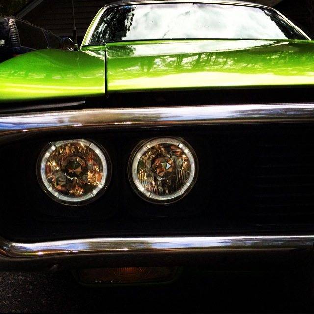

New Headlights - with halo's
Replaced Engine mounts

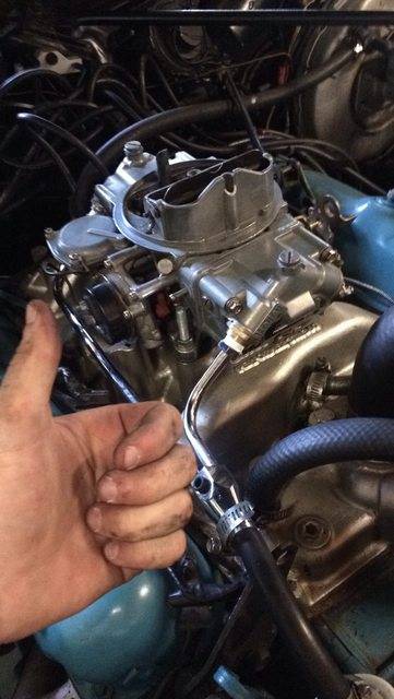

Rebuilt my Edelbrock Carb (sold for $170) - 600 CFM
Bought Rebuilt holley ($150) - 750 CFM

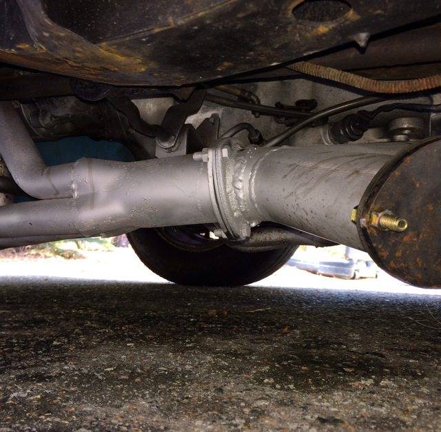

Installed cutouts after headers
New intake gaskets

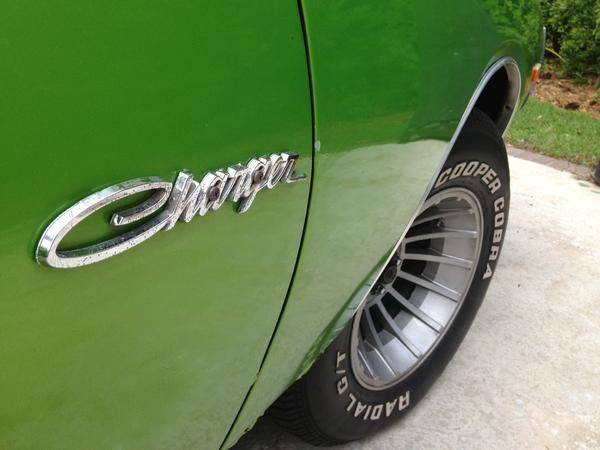

Painted my hurricane rims
Valve Covers (Old ones leaked had to buy new ones)

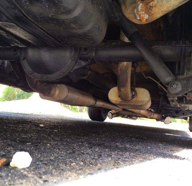

Restored the under carriage and put Air shocks on
Before
After

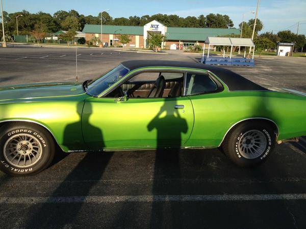

Lowered it (then decided to give it a rake instead)
Before
After

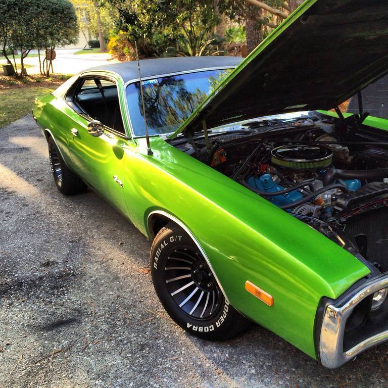

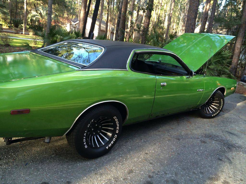

Final Product
I've added and replaced many things. When I purchased the car about two years ago it was pushing retirement. Now it's my everyday drive and starts every time. I've spent countless hours making sure everything worked and ran like it should. Engine-drivetrain-interior is practically new. Only thing i need to do now is save my money and get the body work done and repainted.
Haven't kept up with this thread, missing a few pictures, but here it is! I'll update it as I go and post pictures of the body work.
That is one fine looking Charger, the engine looks great!! I do hope things get to where you can get it body ready and painted, she looks pretty fine now and i know how it works but we may as well keep them looking there best and it appears you are doing that in fine order, Good luck to you and i hope after it is done and painted you'll share a few pics!!! :)
great looking car, love the rake. you do nice work keep it up
Love the headlights and the wheels. And I so dig the green.
Sweet! I really like it and the wheels actually look really good on it too! Me likey

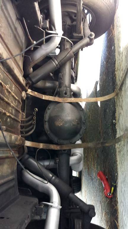

Rear End Swap and Other Goodies
I purchased a Parts car (1973 charger SE)
Had a 9 1/4 3.55 Posi rear end, so I swapped my 8 1/4 2.71 for it. Here's some pictures
Repainted it, put new brakes and lines on it
Sweet upgrade from from 2.71, gets up and goes much better. Only downside is the 3k RPMs at 70

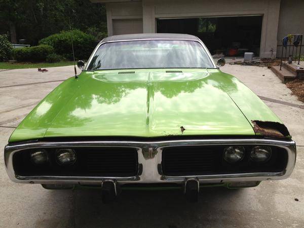

Old hood had rust all about it, swapped it for this one and added hoodpins. Just primer for now.
