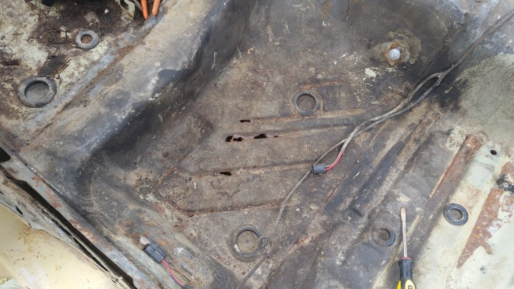

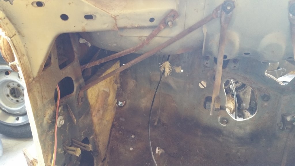

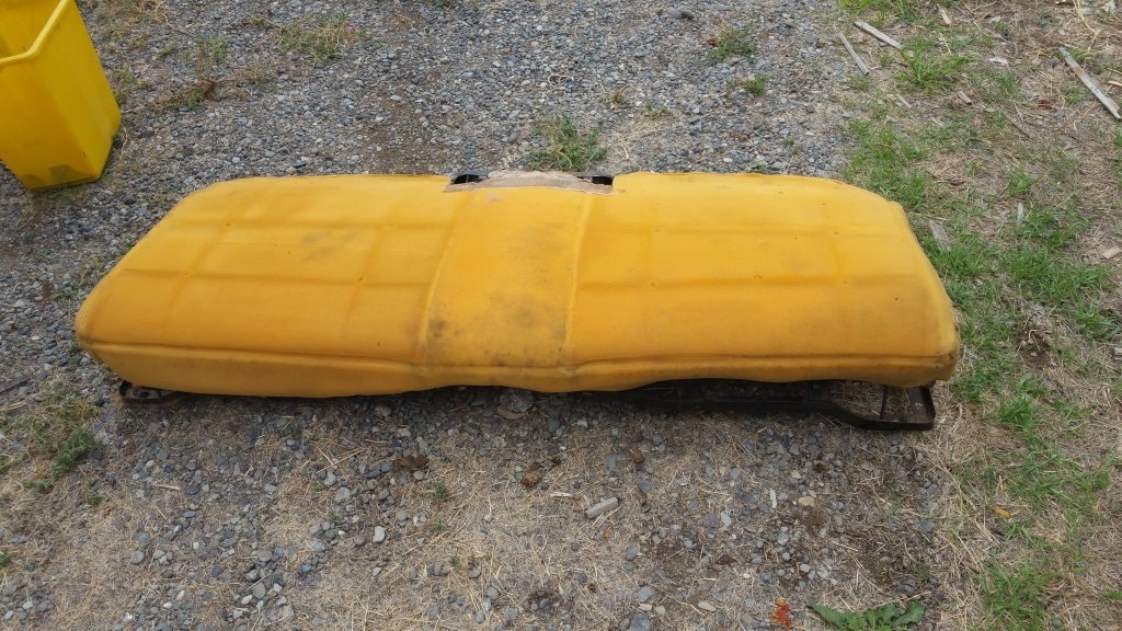

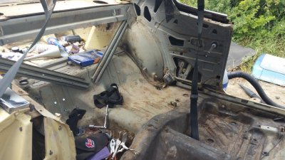

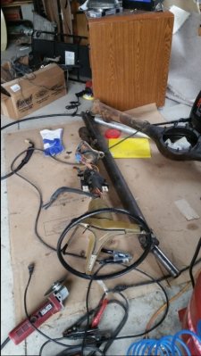

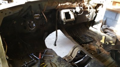

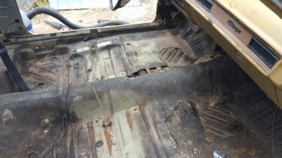

Well... I found a bad spot in the floor pan. I was wrong, at least partially. Just a little area about 9" by "10 needs a patch panel. Not too hard to do, at least. I also removed the back seats I had in there (came from a 71 Charger) and stripped the seat covers off. Not pictured, but I also removed the foam. I also finished stripping the interior, minus the dash.

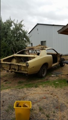

And, like the idiot I am, I forgot to roll the Charger back into the shop before yanking the steering column. Oops!

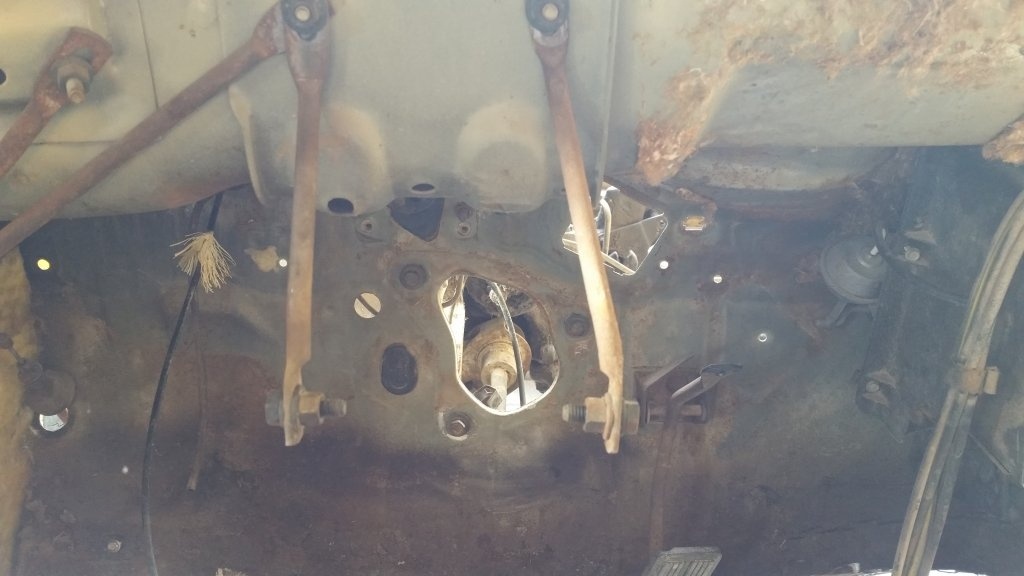

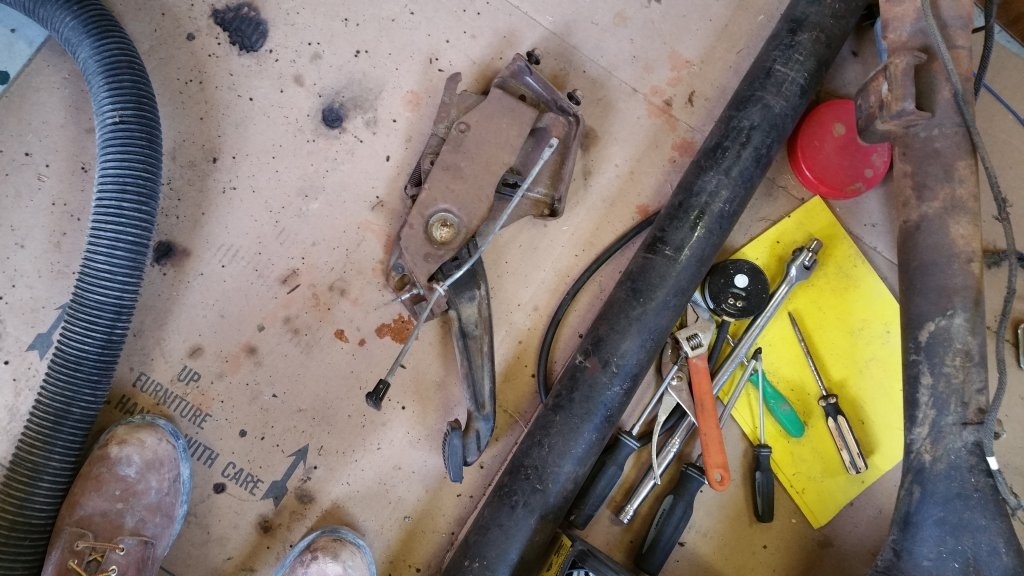

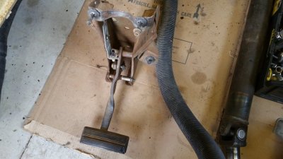

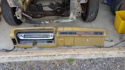

Recently I pulled the dash, along with the gas pedal, brake pedal, and park brake assemblies.
