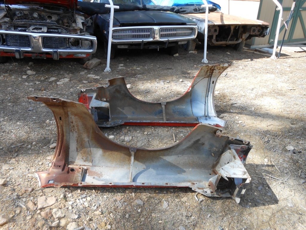

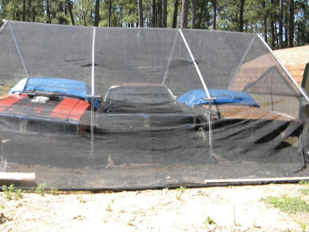

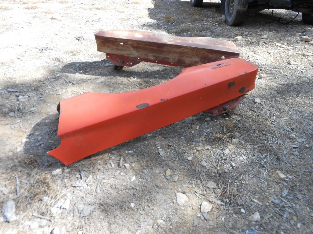

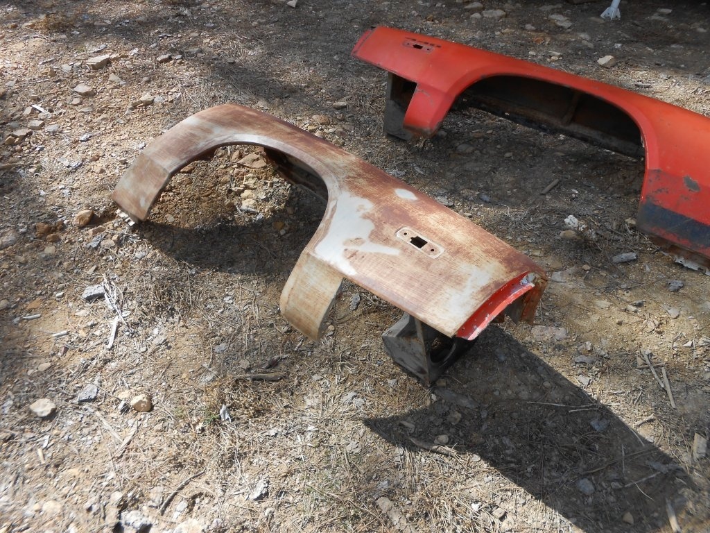

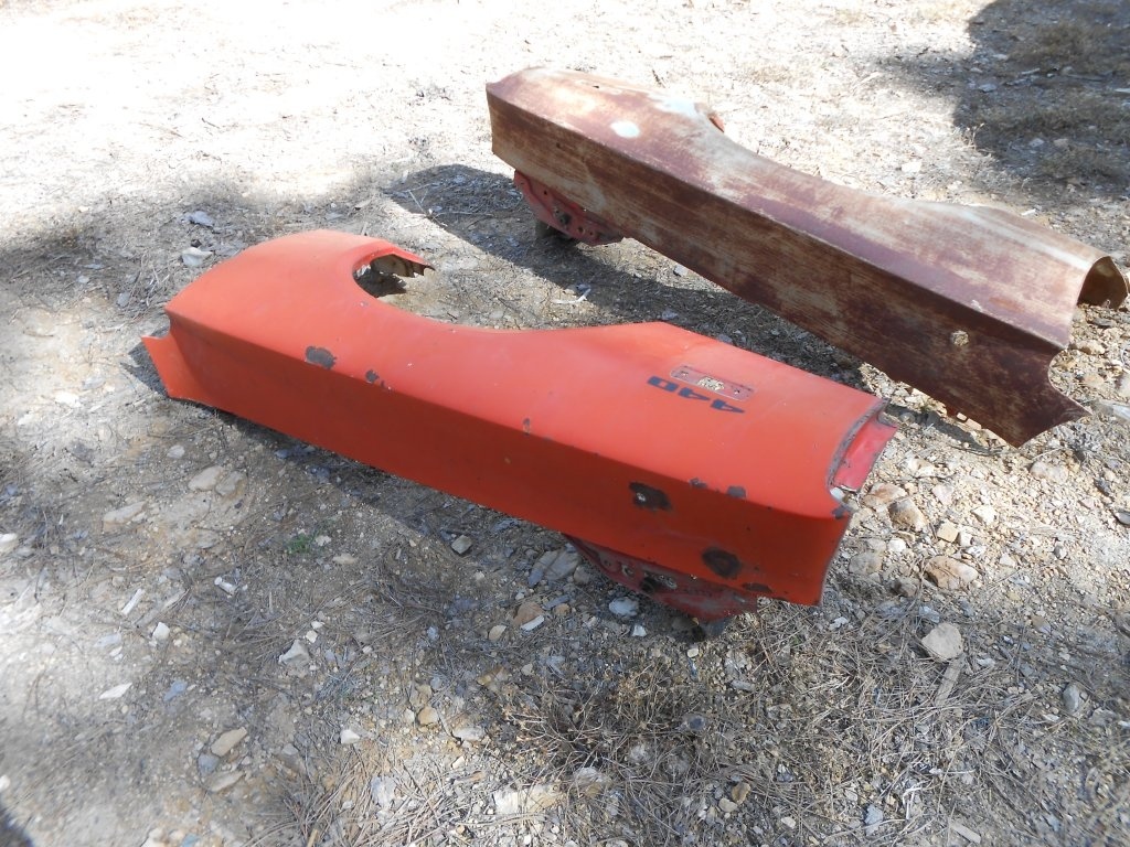

I guess I didn't realize fenders would be hard to find in good condition. I am sitting on several (whole cars actually) I have had these for years but just got overwhelmed with other project cars and most likely wont ever get to them. The netting is because we have a lot of large hail out here. The center car is a highly optioned 72 SE the far right is a 73 U code charger (last year I think for the 440) Someday if I live long enough lol. Been there for almost 10 years now. But we are a low humidity area so things don't really rust away here.

I looked this morning and both fenders on the orange car are very straight. I see no rot what so ever.(there actually better than the U code car which is the one I was going to build. But there not real bad either and I want to keep them as there original to the car) The drivers side is still in paint so would have to pull it to make sure it is as good as it looks. The passengers side some one at some point took down to bare metal then painted primer on it with a brush. It has surface rust but it is very straight with no rot. It isn't pitted at all but really they both would need stripped anyway. Here's the thing. I will be coming through WY. on Monday morning. I will come through on I90 to Buffalo then over the pass to Worland , Thermopolis , on to Riverton. So if you could meet me along the line I could bring them. I had not really thought about selling them so shoot me an offer I guess and we will see. I don't believe in bending anyone over the back gate but wont take less than a reasonable offer as I don't really need to sell them. I will post some pictures this after noon.

After pulling the fenders I found no rot what so ever. No cracks in any of the flange areas. No major damage that would leave me to believe there is any bondo. No major dents. There may be a few minor places but very clean 44 year old fenders.

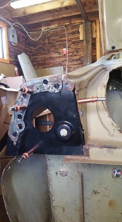

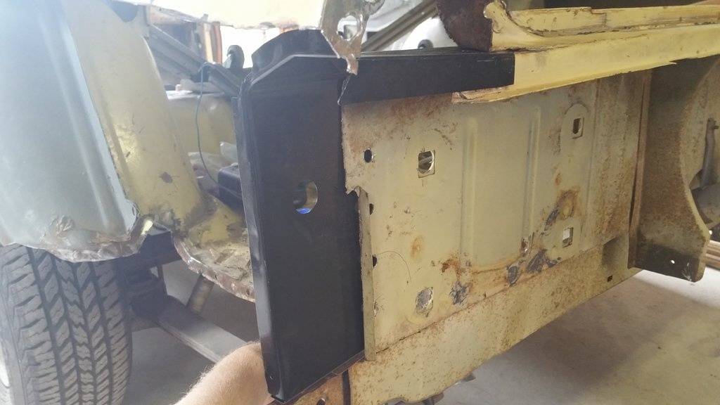

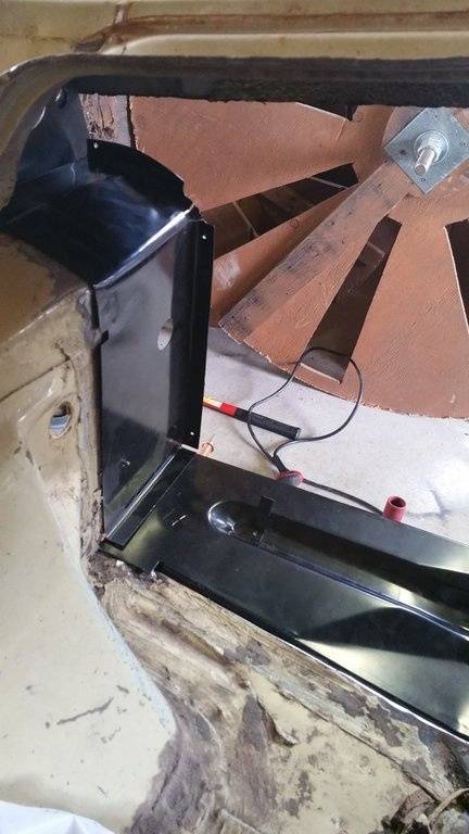

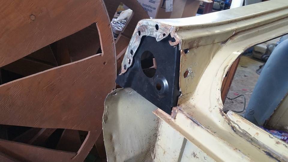

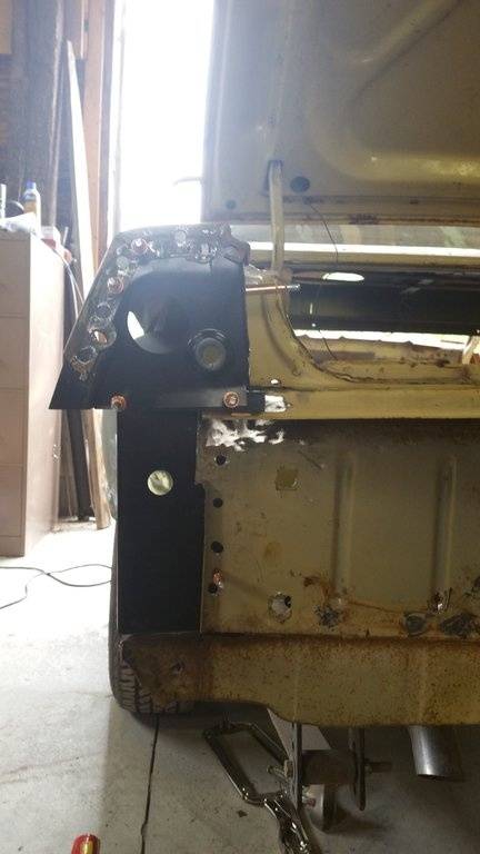

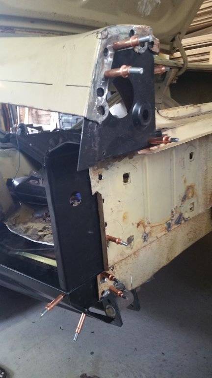

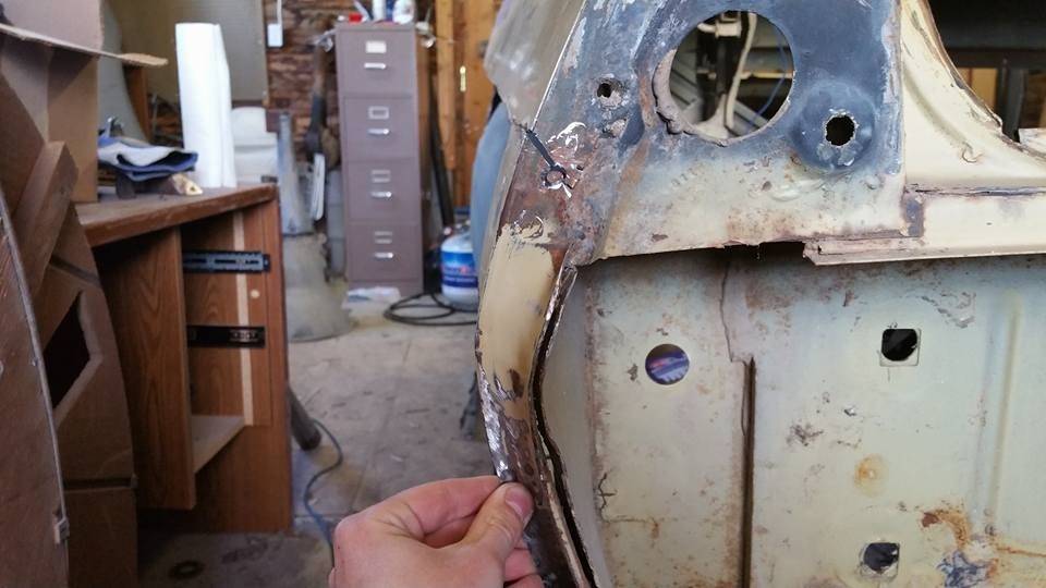

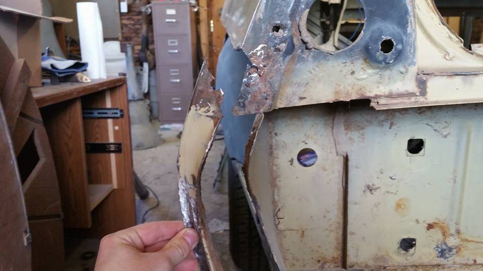

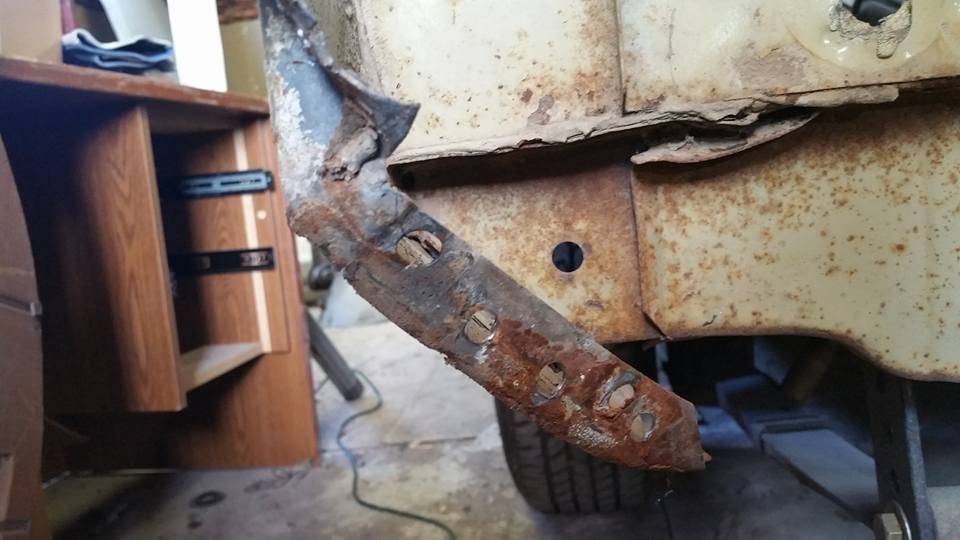

Long overdue update!!! I got all 6 pieces I was waiting for from AMD. Interestingly enought, the panels were listed to fit a 71-2 Charger, but they test fit just fine on a 73-4. They look identical. Except one panel was different, the "AMD 71-2 Charger Rear Quarter Panel Inner Reinforcement Support" But is easily modified with two cuts, and a bend. Now looks Identical to the 73-4 piece. I'll photograph those modifications later and post them up.
These photo graphs below only show the test fitting of the quarter end-cap support.

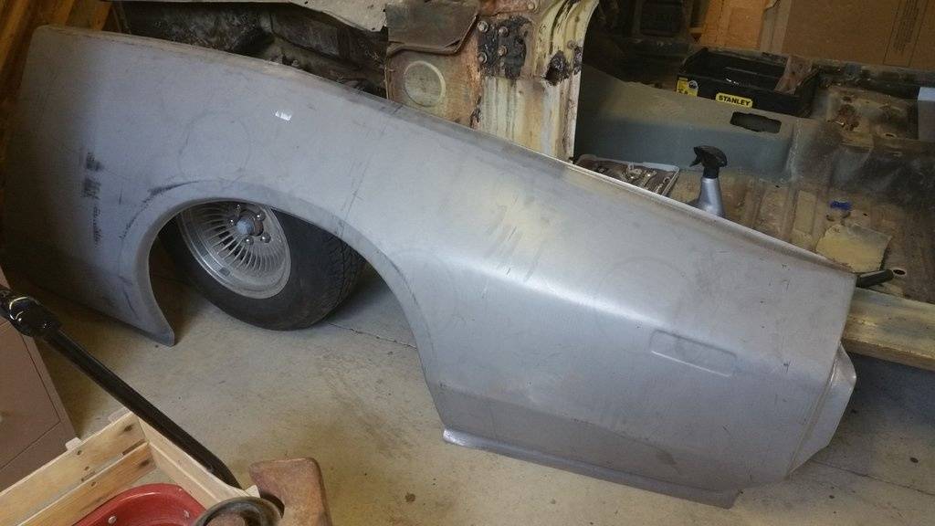

Haven't been posting as much lately, but I have done some stuff on the Charger.

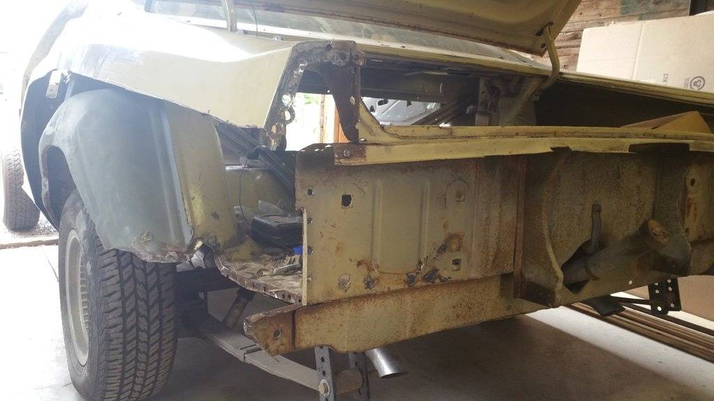

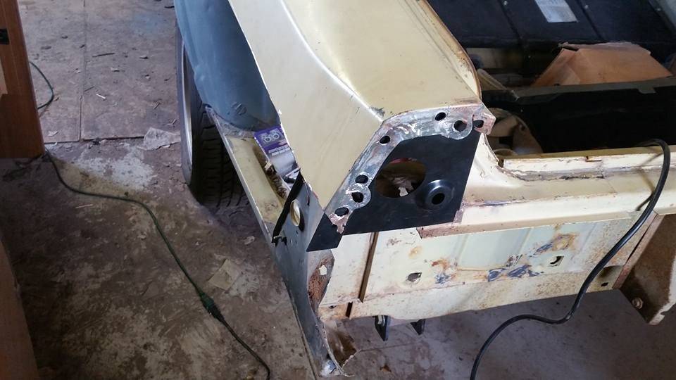

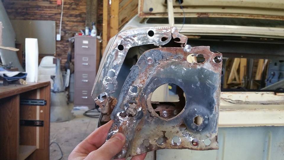

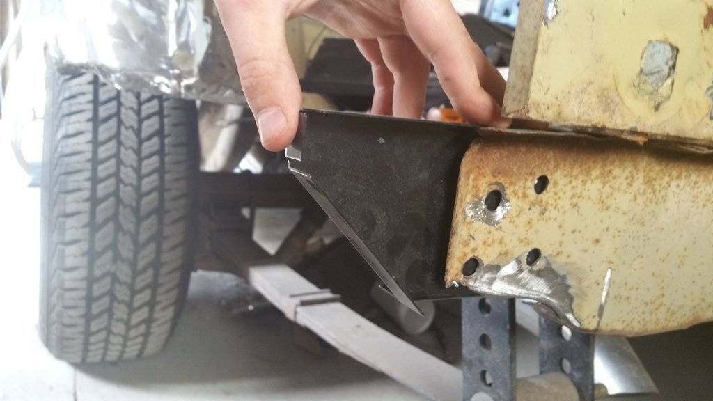

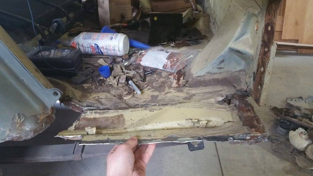

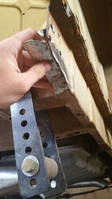

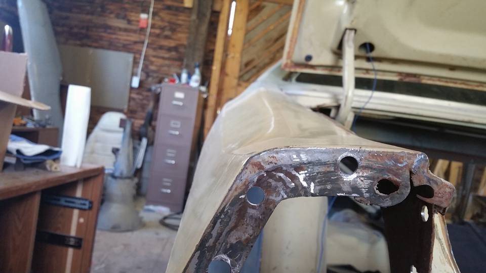

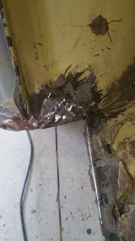

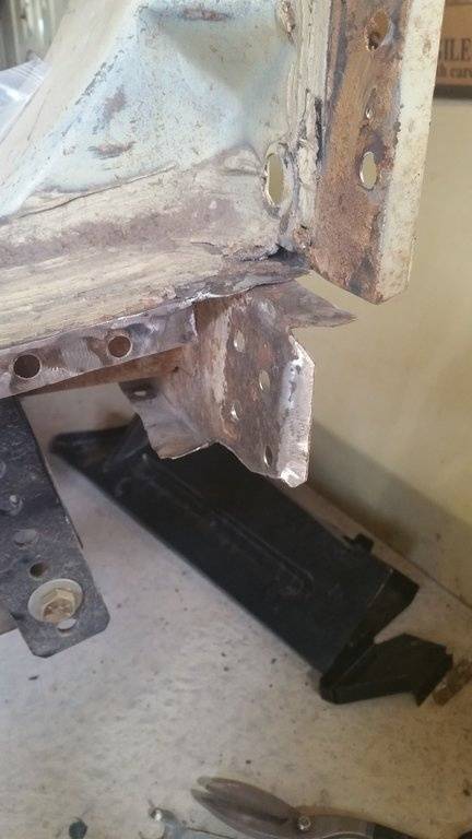

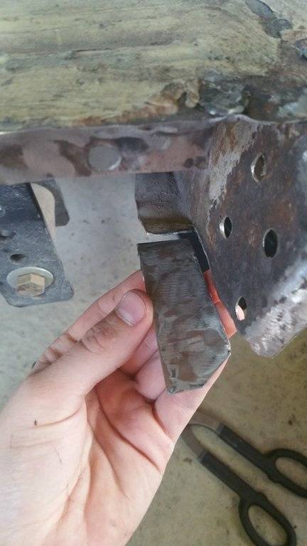

Here I removed the remainder of the driver's side trunk drop-off panel.

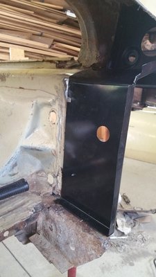

New AMD trunk drop-off extension panel fits pretty good. I'm gonna have to tweak it just a little to fit perfect, though. At one point the wheelhouse was damaged in a collision, and I've pulled it mostly out. Just doing my best to fit the puzzle pieces together.
Here I have all the rear-half quarter panel reinforcements removed. Interestingly enough, the "71-2" only reinforcement panels appear and fit the same as O.E. 1973...
20170725_132741.jpg 20170725_132800.jpg 20170725_150452.jpg 20170725_150457.jpg 20170725_150509.jpg

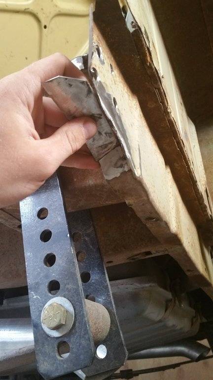

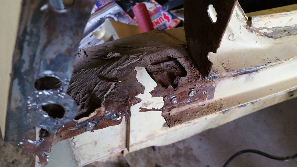

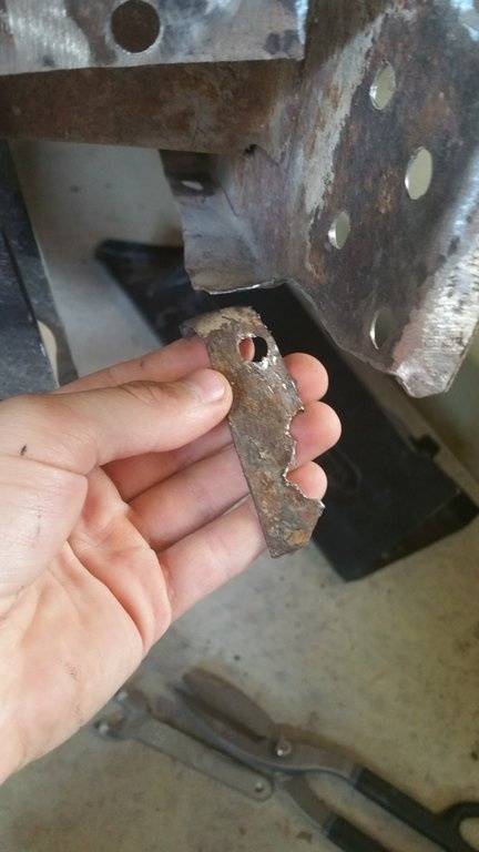

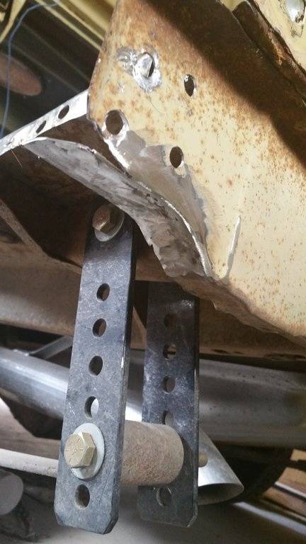

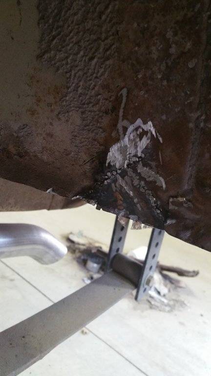

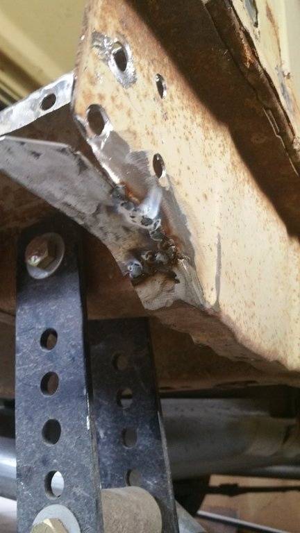

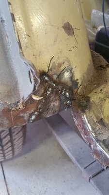

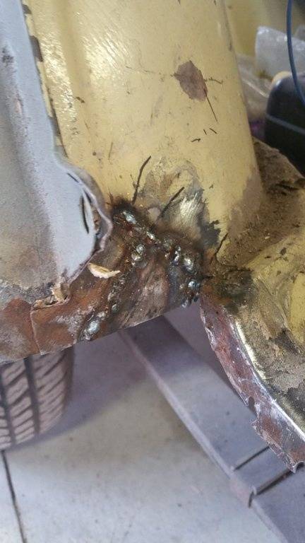

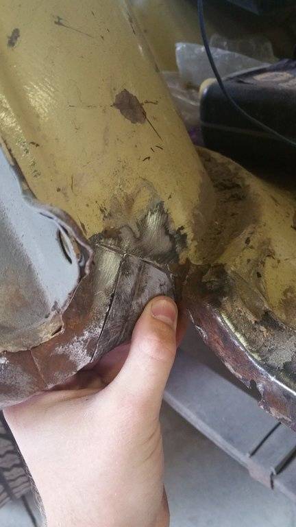

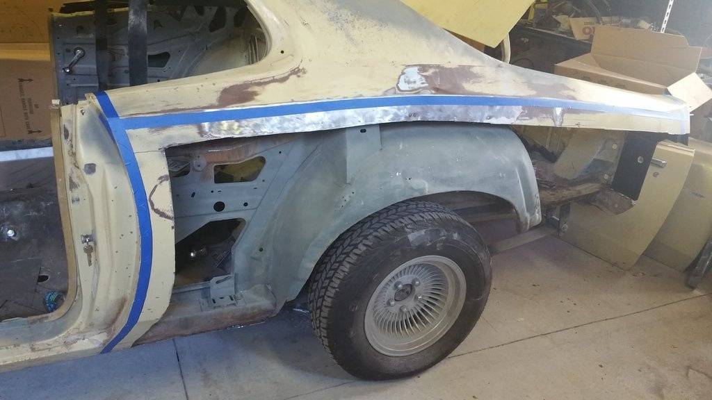

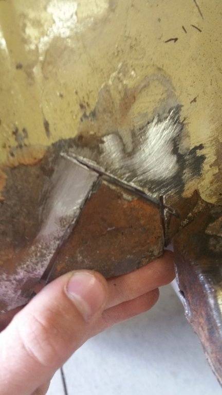

Got to practice a little bit of fab work. I found some rust at the back of the wheelhouse, so I cut out the cancer and made a patch using scrap metal. Welds aren't great, but it's my first time welding with 75/25 gas. (recently converted the welder from flux core to mig). But with some grinding the welds are just fine.
20170725_132829.jpg 20170725_132853.jpg 20170725_135757.jpg 20170725_140410.jpg 20170725_140420.jpg

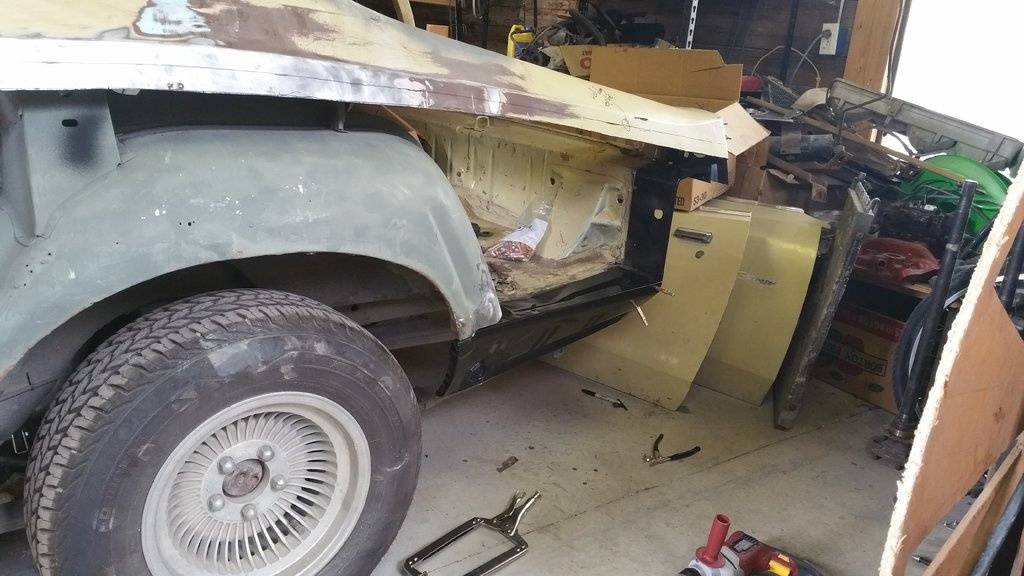

Update, 7/26/2017

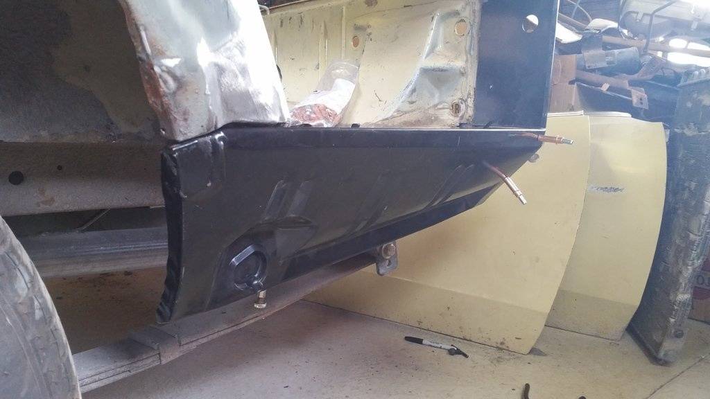

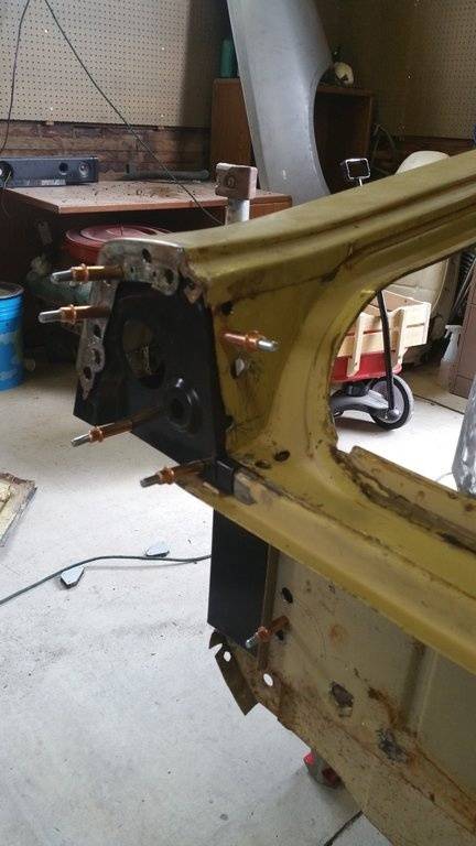

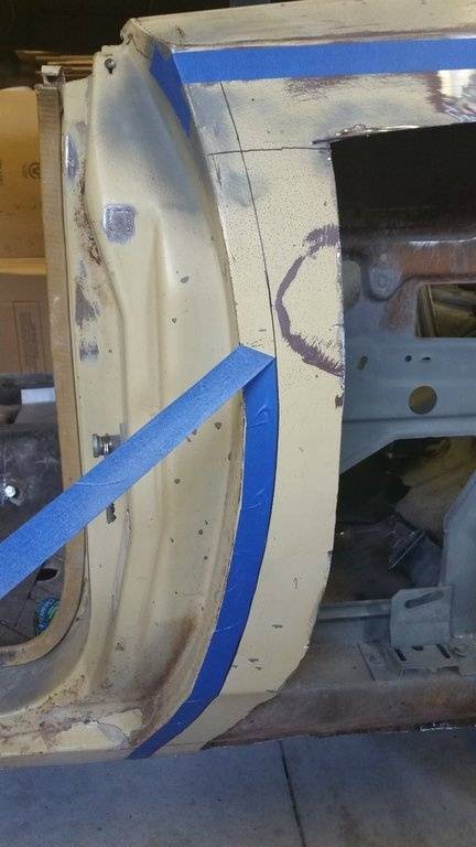

Today I did more stuff for the Charger. I started by trimming the old quarter to the dimensions I want, so the skin will fit properly. Not pictured - but I primed the inside of the quarter skin and applied generous rubber undercoating, in an attempt to replicate (somewhat) how the factory did it.
I also did lots of test fitting panels and drilling holes for cleco pins as well. Most of all my AMD parts fit near perfect, which is impressive. When test fitting panels, I found a rusty spot in the structure, so I cut out the bad steel and made a small patch out of scrap steel.
20170726_140112.jpg 20170726_140117.jpg 20170726_140132.jpg 20170726_162009(0).jpg 20170726_162041.jpg 20170726_162053.jpg 20170726_162106.jpg 20170726_162130.jpg 20170726_163707.jpg 20170726_164330.jpg

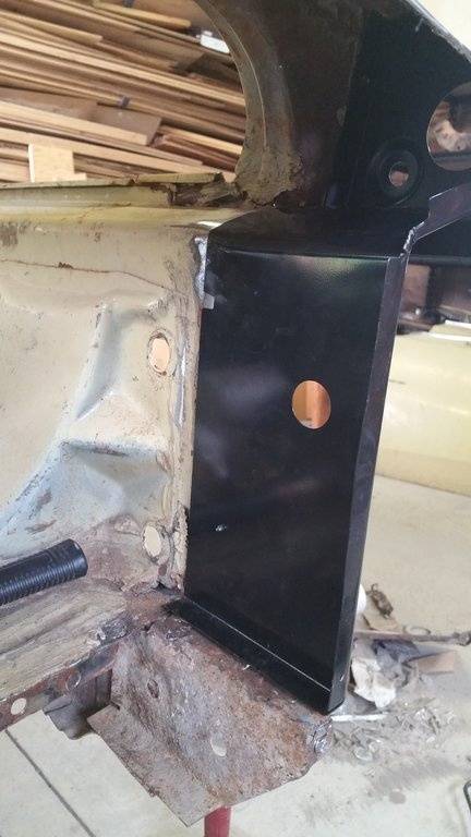

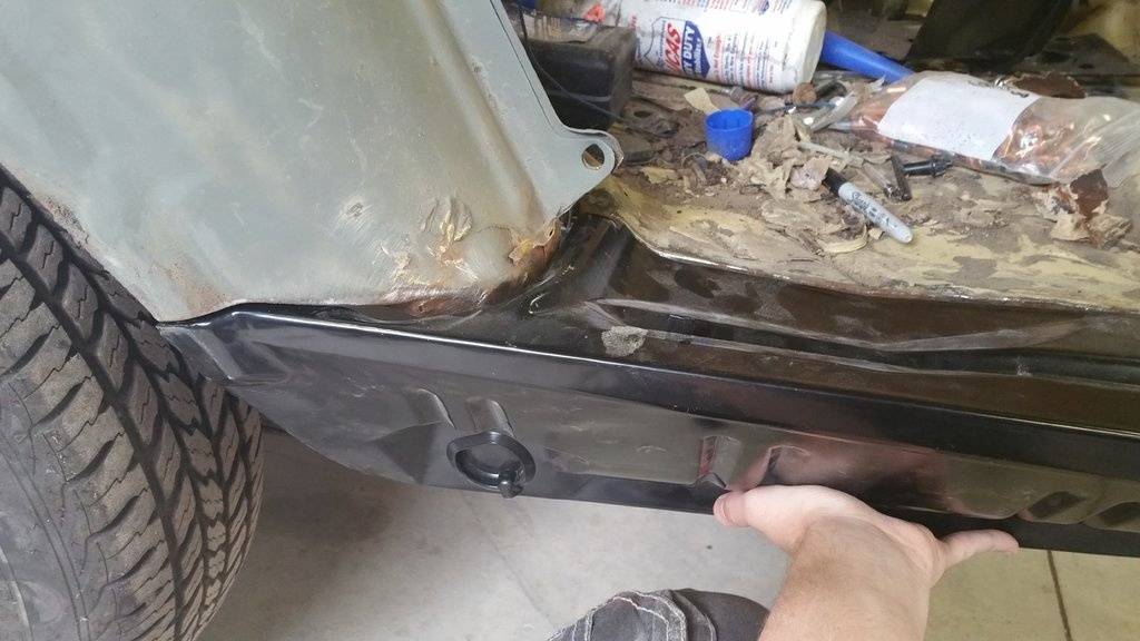

Here are some of the patch panels in place, will be welded in shortly.
20170726_173309.jpg 20170726_173317.jpg 20170726_173325.jpg 20170726_173333.jpg
