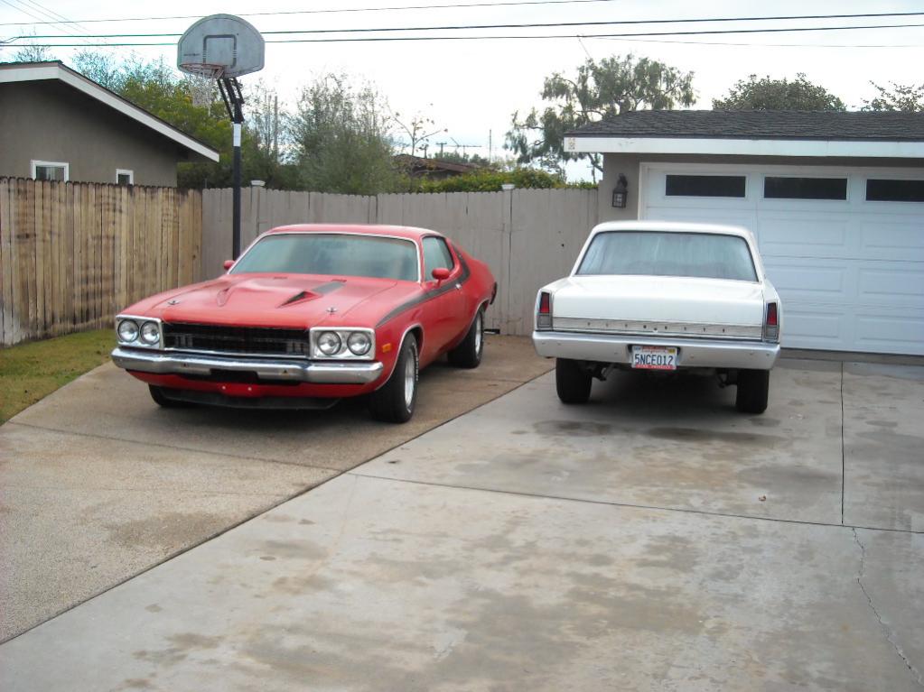

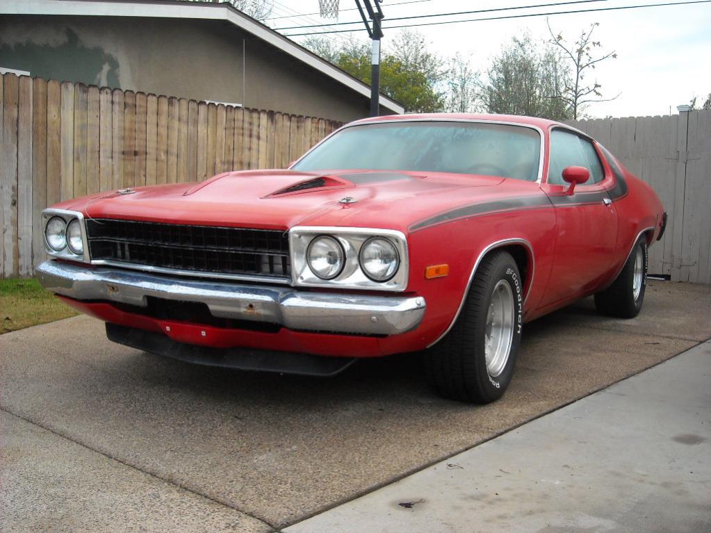

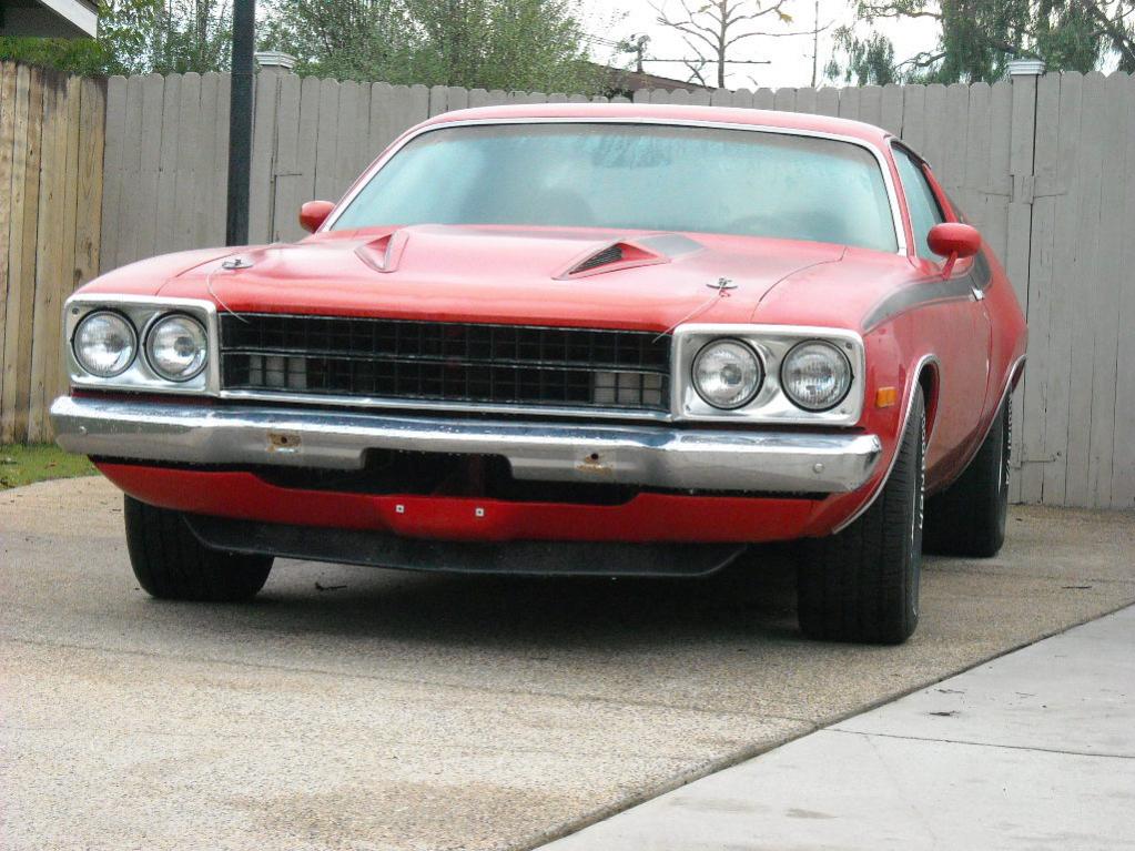

okay, got the pics, hope this helps......
damn you got that rr looking great man. those are the same wheels i am putting on mine. american racing outlaw 1 wheels. great looking car. i need that front valance on mine below the front of the car. have any idea where i can get one for a good deal. how about some more **** and ill show you pics of mine also. great looking car brother.
Revhendo, that looks real good! I have a 74 with 15x6 ralleys w/BFG 235-60-15, rear- 275-60-15. I have no interference problems. But I like the twisty roads! Do you have any problems with throwing it into a corner and rubbing with the body roll? Midnight rider, your setup is the standard for the 73-4. Everybody can run that with no worries. Any bigger and you might want to start playing with off-sets. Hendo, I have the "chin" spoilers, but I like the valance spoiler too!
I was looking for something different when I found that spoiler on E-bay. It's a little pricey, but, it's made out of steel and fits bitchen. The 255's on the nose rubbed a little when I had the front lower, but I have a swaybar upgrade in the works....
The wheels could use about a quarter inch more backspace and when I do the rear disc conversion, I might have to work the rear wheel lips just a bit. Time will tell.

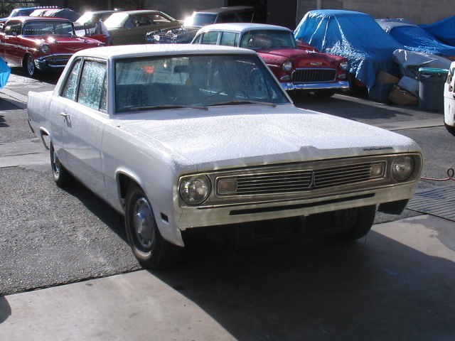

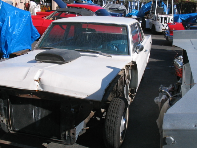

It's pulling daily driver service right now. Bought it bent, fixed it up and added lot's of suspension and big brakes. Stll cruising on an overworn /6. Soon to get a stroker 340.......
