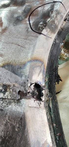

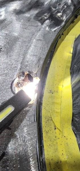

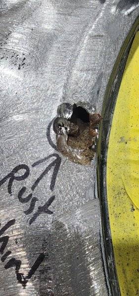

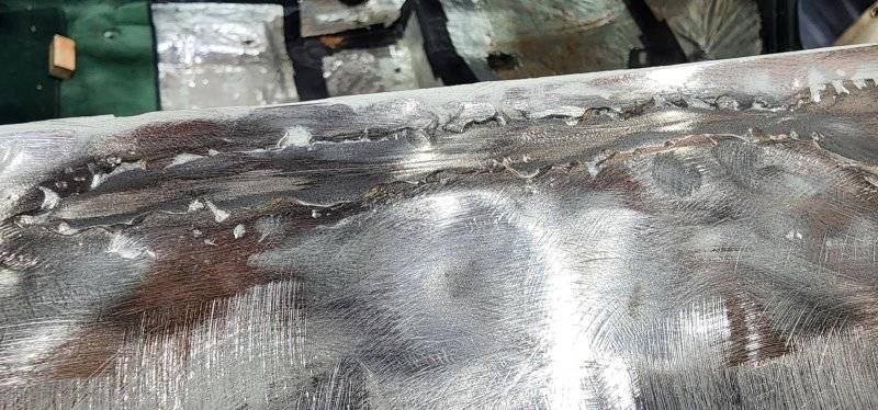

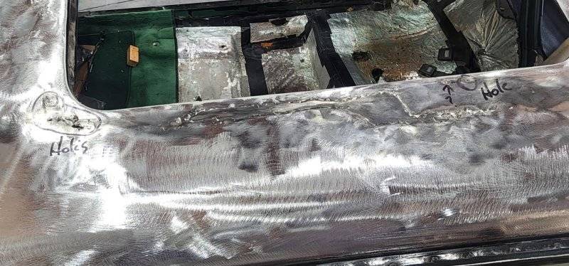

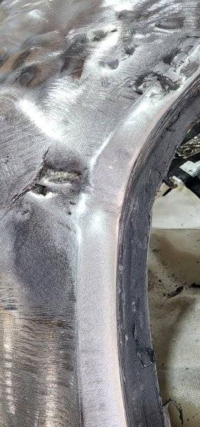

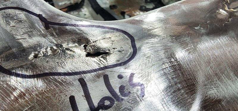

There's a large hole behind the lead area at the rear of the drivers side panel roof to the quarter panel.
The only way to get to it is the torch and melt to lead away and see what's going on here. Headliner is going to need to come out, and need to lay weld blankets everywhere. Lord!
View attachment 1936887View attachment 1936888

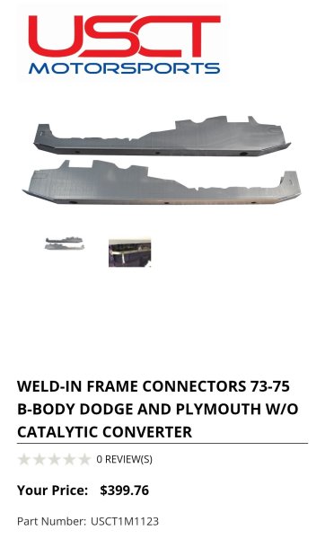

Good thought. Do they make them for that car 74? I’ll have to look.Might as well have subframe connectors welded in.
