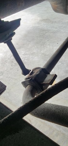

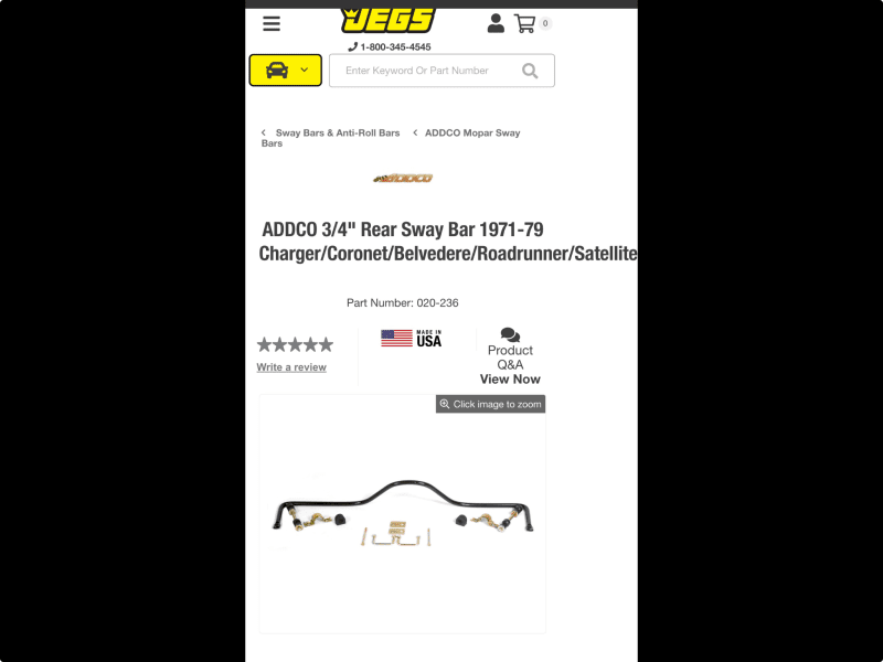

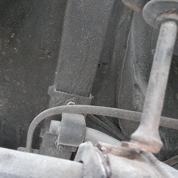

And the torsion bar link is broken. We think the last shop who did terrible work took the car out and dogged on it the last day they had it when we told them stop working on the car and we are coming to get it. One of my mechanics customers who knew my car told my mechanic he saw the car broke down at the 7-11. When my mechanic went to get the car from the shop and take it to the new paint guy he said it was making noise from the rear that wasn’t there before. Well at least I could find those parts. It was the last one in stock.

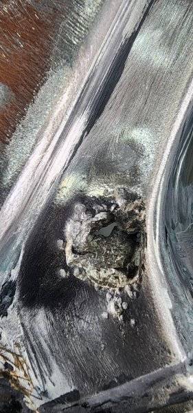

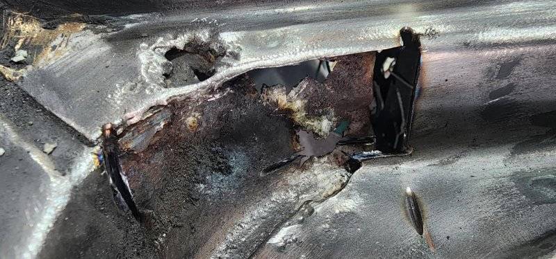

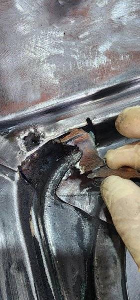

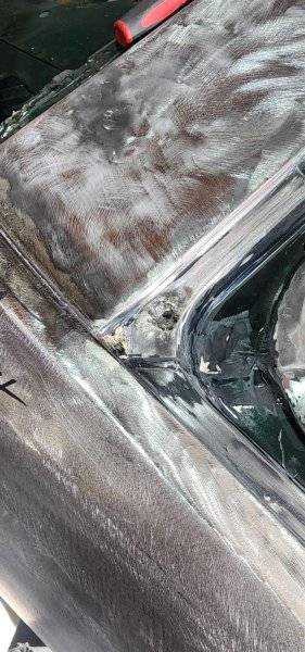

It's amazing how much gets hidden under mud and paint, only to show up down the road. Good luck on your unexpected re-do.

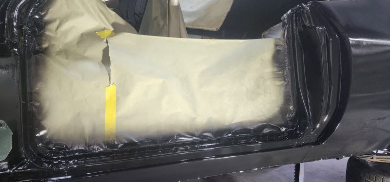

That’s the real problem when dealing with rust. If it’s on the outside, it’s on the inside. Until you fully expose it, you can’t fix it. Hoping you are actively looking for other places that aren’t rusted thru currently that are rusting from the inside out. You don’t want to do this again in 2 years.

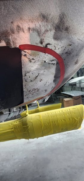

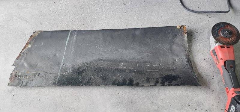

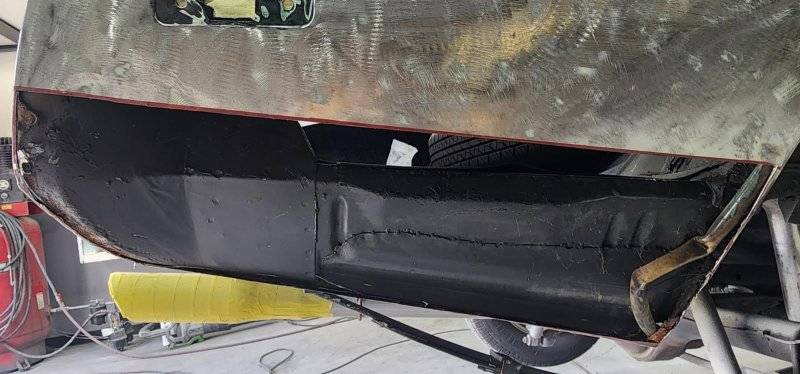

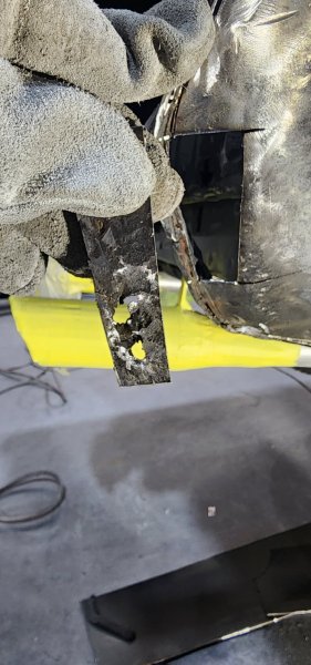

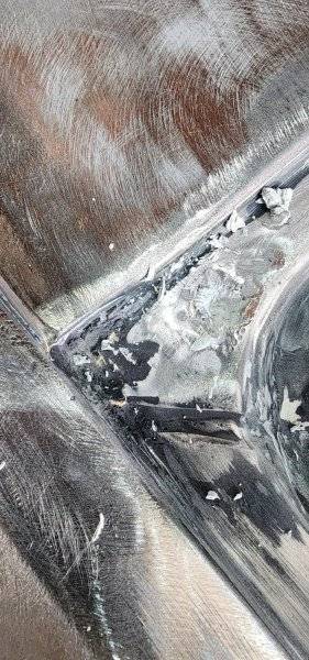

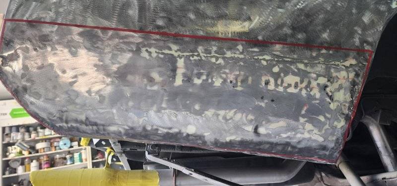

Drivers rear lower panel patch, it was back here in the red with rust behind it.

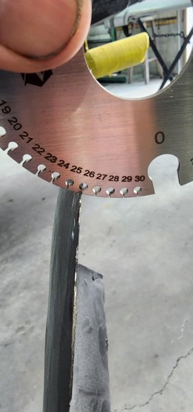

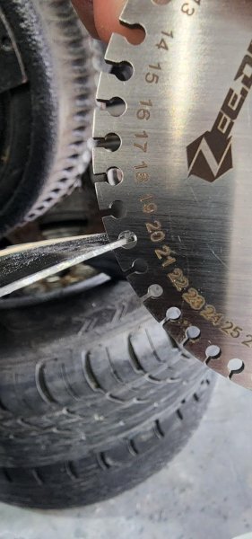

Im going to use a panel from Suburban here. The old panel is as thin as 26 GA. in areas I'll burn through to easy.
Suburban is roughly 20.5 GA
Doesn't sound like much, but it is.
And that's why I termed the phrase "where there's rust... there's more" many, many years ago from experience.
