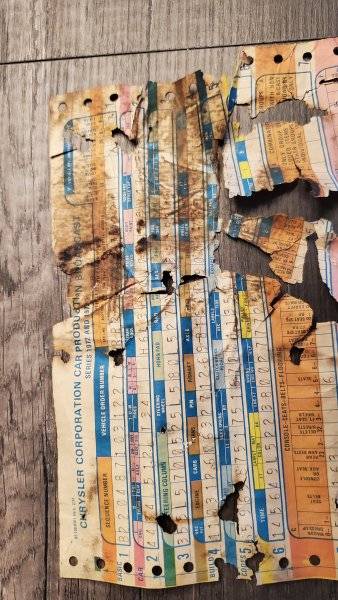

Hello, I purchased my 1st Charger this month and I have found the build/production/broadcast sheet inside. I need some help decoding the interior color, body paint color and vinyl top color. Both production/broadcast sheets are in semi-bad shape. I would love to restore this '73 Charger SE to her former glory. I do know she started with a 400 engine but currently has a 440.
I don't want to tape the sheets back together for fear they would lose their value. The broadcast sheet vin and car vin do match.

A note on the pics you posted - that 2nd broadcast doesn't go to your car...best as I can tell, it's for a Satellite Sebring that had a scheduled production date about a month? later than your Charger was scheduled? (I can't make out your date for sure, but I'm thinking it must be "C05" meaning December 5th 1972) Looks like the "Satellite" SPD would be January 3rd of 1973
