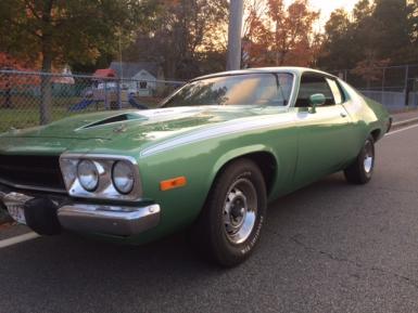

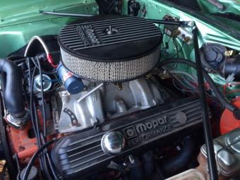

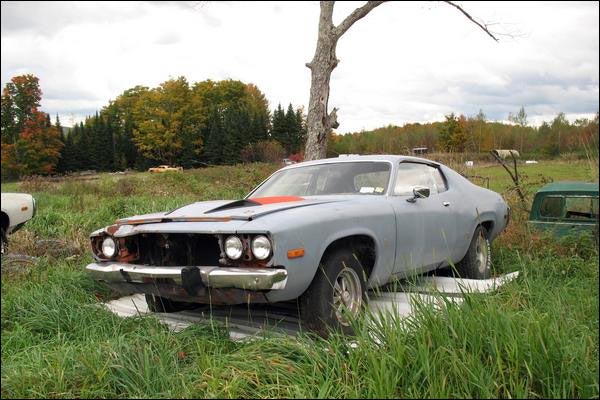

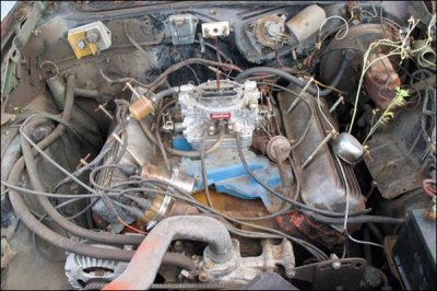

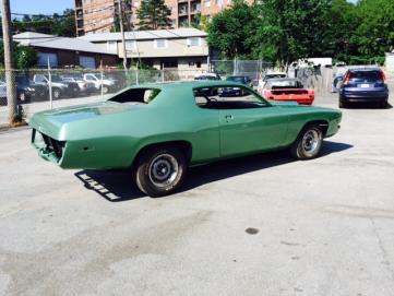

This 74 RR was found in a field in Vermont where she was to spend her last days until I brought her back to life last time on the road according to original owner was 1994, this car needed everything rear quarters rockers inner outer wheelhouses etc, I attached a few pics of before and afterView attachment 288193 car in field.jpgcar in field 2.jpgimage1.jpgimage2.jpgimage3.jpgimage4.jpg

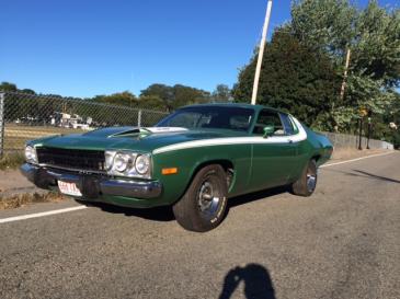

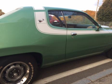

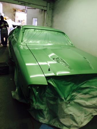

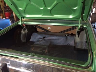

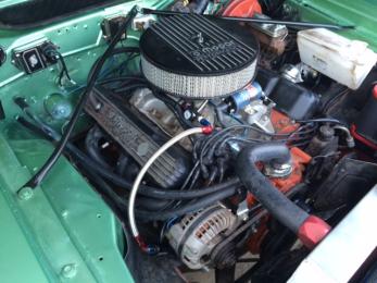

Here's a few more pics

went with original color frosty green metallic,
Very cool car my friend and great save too!

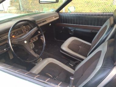

Did it have bench seats originally? I really like the 70 RR buckets.
An RM code with a standard dash...... hmmmmmm.
Now I'm just curious..... Is that the original dash cluster?
They might not have built your car to spec per your other thread. The guys at the plant were often faced with temporary parts shortages which lead to a great many factory correct odd balls which might explain yours.
I can't imagine taking out a ralley cluster, pulling out the harness for it, replacing the harness to work the more limited guages, changing out the oil pressure sender to a pressure sensor just to make your car unique by the previous owner... Or it could be they just just built it that way at the factory... It could be a one of one!!!

Sweet RR bro. The before and after pics are a nice touch for this thread.

as you probably know it's next to impossible to find sheet metal for a 73 or 74 especially quarters, I got 2 quarters off a donor car from new mexico but they were rough, I used front and rear lower patches from AMD, the front patch is from a 72 and required a little work to get the lip to line up,but they worked fine also used rockers for a 72 from sheerwood ,but I had to modify a bit to fit well, every thing else I had to fab
