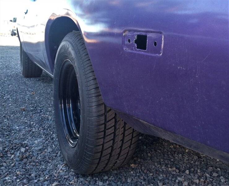

I agree on the Nascar look. This is the front of the '73 Charger I'm building with a 255/60x15 on a 15x8 3.75" backspace. Having a set 15x10 rear wheels being built to fill out the rear.
View attachment 1171799 to
Thanks Outlaw! I like how that looks, and I believe I’ll like it on my car, as well! BTW - What brand tire is that! Thanks!
Thanks for your reply, and the picture! What brand are you running there, and where’d you find them?
Looks like Cooper Cobra tires. They also Make the Mickey Thompson tire Same tread. If you like lettering the Mickey Thompson was a period correct tire back in the early seventies. No Cobra's back then...
