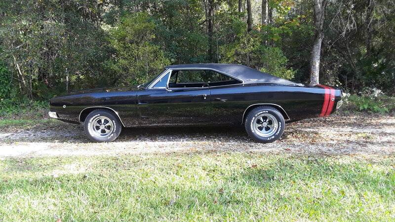

The sr1000's came on the car when it arrived they were 275 /60, I put on the coopers and they are 295 /50. The rim is 15 x 10 .

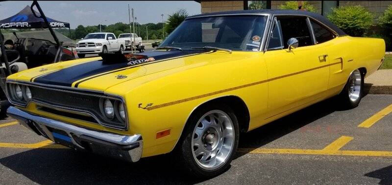

Here's a few pix just for comparison.
17" Rallye wheels 8" front 9" rear stock suspension. 315/35/17 rear drag radials
Going to try a 345/40/17 next, and a little taller, narrower front tire.

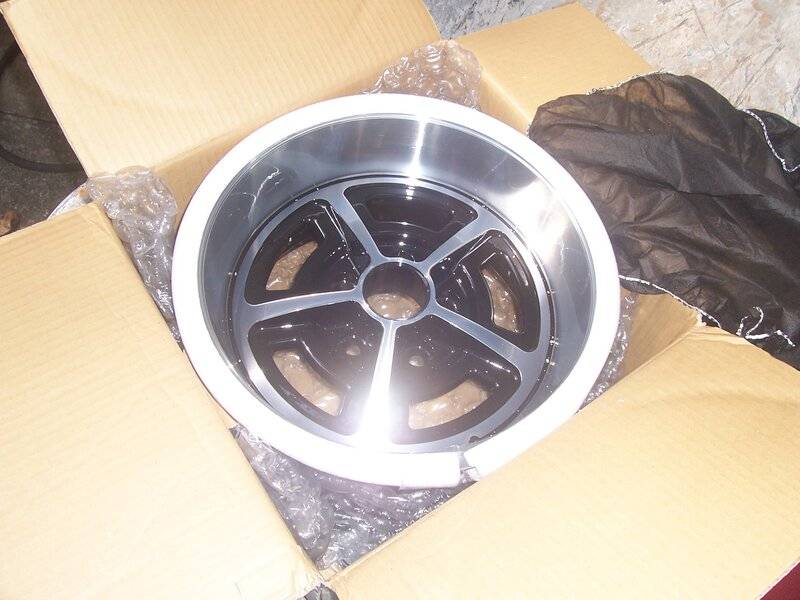

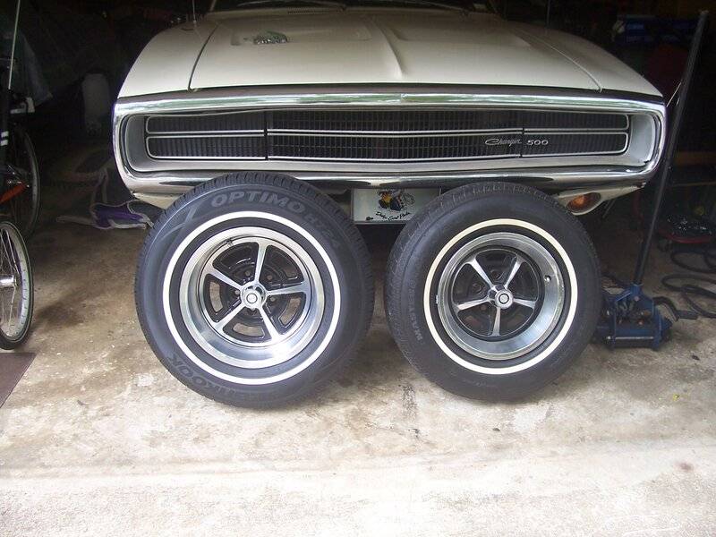

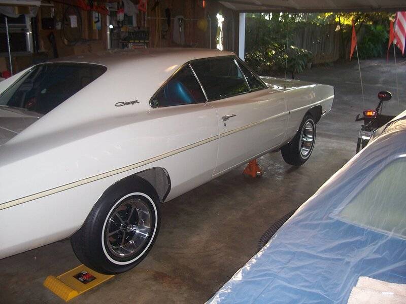

I bought Dynacorn 15 x 8 one piece Alloy Magnum 500's to give me more options on tire size AND to maintain the present look that I have. The added benefit was that they filled up/out the wheel wells; I am well pleased! Check the pix; Left-New, Right-Old
